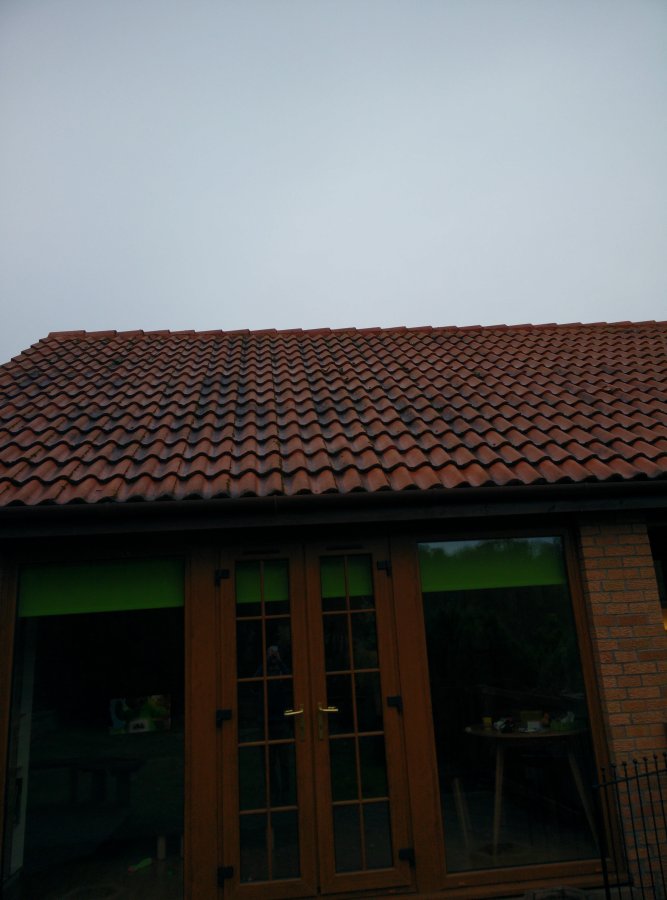

Ok had a roofer round. Went up onto roof and can see no issues with the tiles themselves. He feels the issue is likely due to the way the ridge tiles have been laid, which over overlapping instead of next to each other. The overlap on most has no pointing on it (roof has been Aquasealed many years ago). The strong wind and rain we've had would explain the widespread leaks if the ridge was the issue.
He will price up either patching the pointing on the ridge and also lifting laying properly. I imagine the latter would be the better option.
Here is a photo of the roof.
The fact that the roof has been sealed is obviously a sign of a defect, this should not be so on a relatively new roof, if done in a traditional manner.
The roofers conclusion seems about right.
If we'd seen this photo then I think most of us would've pointed(no pun intended)you in the same direction .

Ok. Second roofer round and has also had a good look. He agrees it could be the ridge and also suggested a vented floating ridge. However he also noted that because the tiles were Aquasealed many years ago that will be wearing off and due to the nature of the application process it will leave the tiles porous so every tile may be letting water in. He stuck his hand under a few of the boards and it came out wet each time.
He will price for both but can't say confidently which is the right route without stripping some of the roof to check. Issue would be if we paid for ridge to be done (he also recommended dry ridges) and then find it still leaks.
