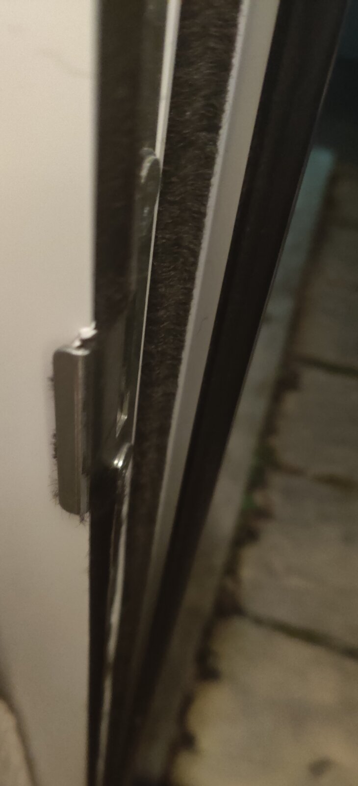

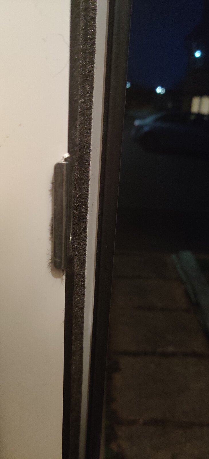

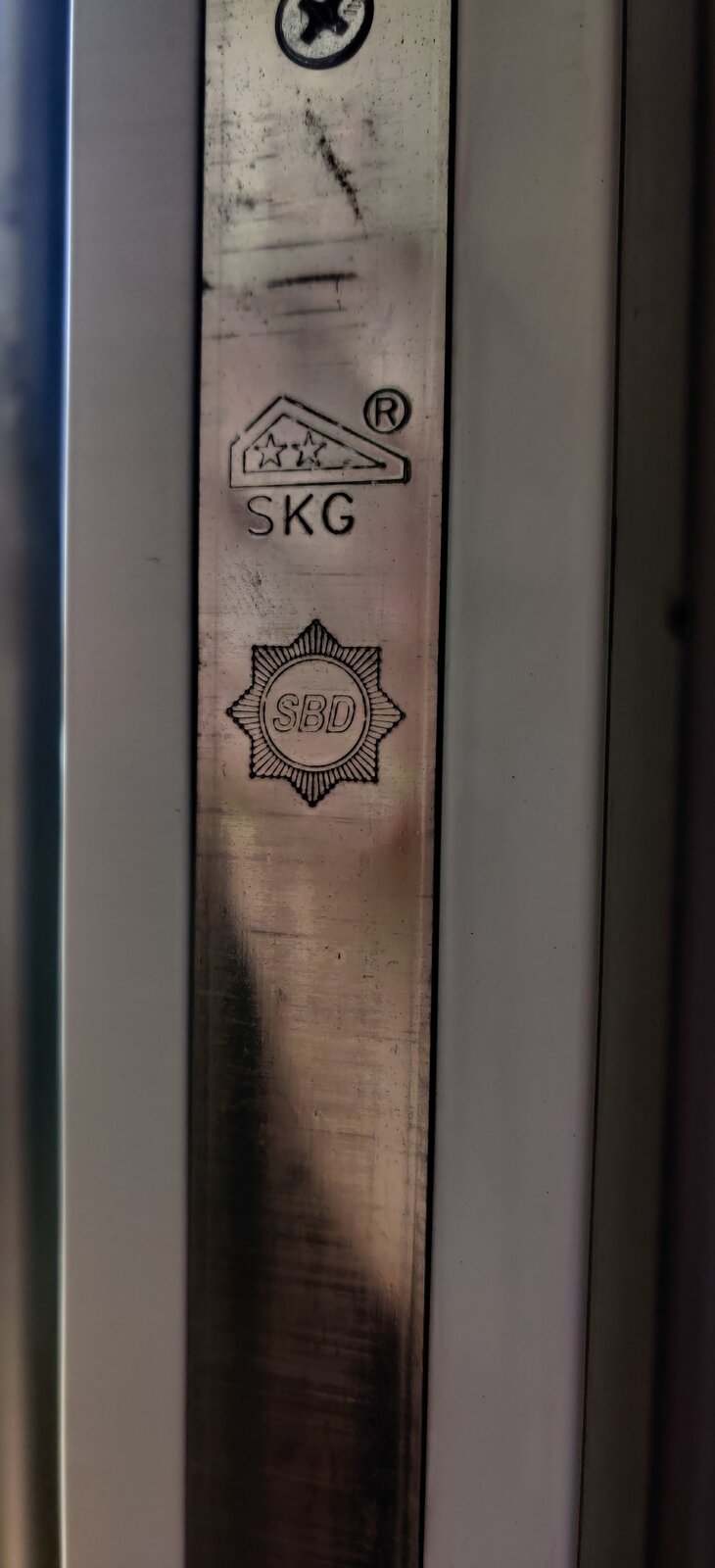

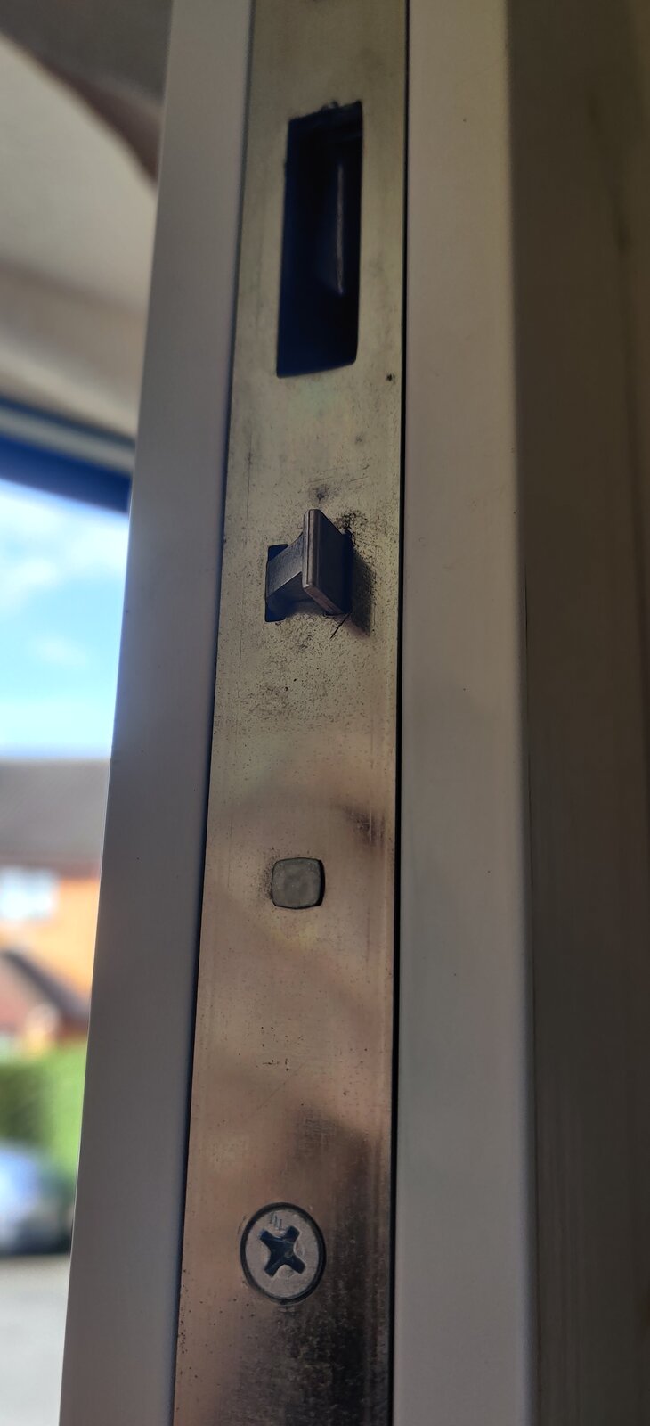

The lower lock that partially pops out often happens when our attempts to close the door fail. Quite often it is both top and bottom lock. The locks seem to be cut at and angle such that it should not stop the door closing when the lock is partically out. I have tried to show a close up of this lock here https://imgur.com/a/9FXx3p8

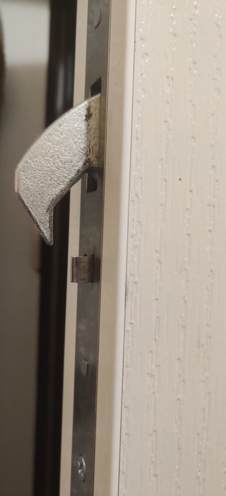

Where's the centre striker plate for the latch, my AV2 lock has one and shuts with a one finger push, is yours missing or have they fitted the wrong type?

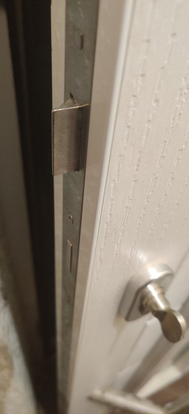

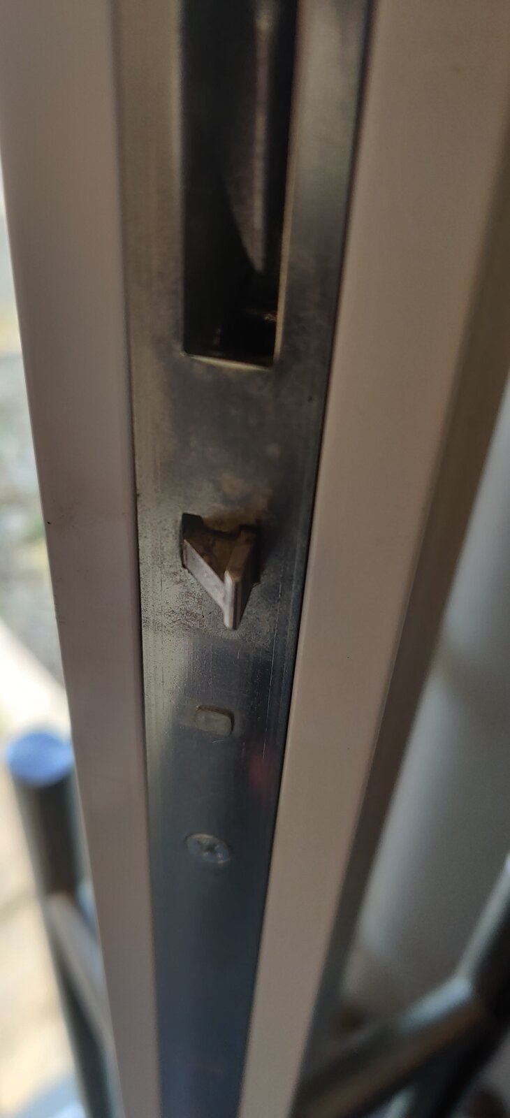

As Crank says looks like wrong striker plate , so night latch isn't pushing in as door is closed , thus not pulling the two small pegs in . I note the two 'pegs ' have the angled striker plate not the main night latch. Its definetly an issue the installer needs to address ( or rather the supplier , as I guess its come form factory like that? ) . Temporary way to close door to avoid any damage would either use the internal handles and turn the night latch in , or if from outside use the key to achieve the same. I know its not ideal but it will stop it damaging the door and shaking the house!
Can't work out whether it's the missing centre latch striker plate or the fact the 2 pegs don't seen to want to ride over their striker plates properly, long shot but wonder if the manufacturer has fitted the wrong handed mechanism in and the bevel on the pegs is on the wrong side, the centre latch says probably not unless they've flipped it around, some mechanisms do have that feature
For reference here's a few pics of my AV2 pegs and striker plate for the hooks, mine ride over the plate with minimal effort, let's see close up photos of yours instead of videos of you slamming the door then we might be able to see what the cause is

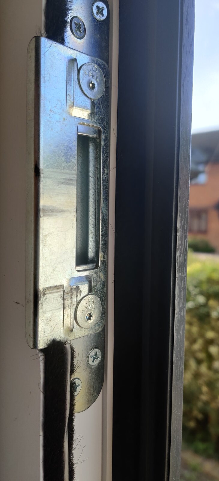

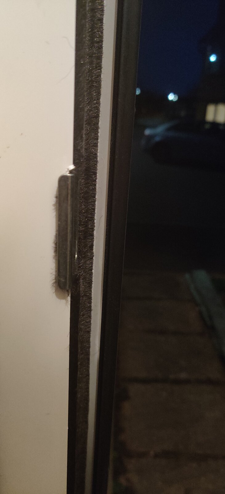

Yes this is the same locking system as @crank39 . And yes @ronniecabers the plate in the middle is different to the others. It does not look like the other bits of metal (strike plate?) in other doors as it is flat.
I hope these photos make that clear https://imgur.com/a/5Dn7zlO and @crank39 I have added more close up photos.
Winkhaus show the lock with all 3 plates having a return. See page 3 of https://www.winkhaus.com/en-gb/-/media/files/uk/documents/stv_autolock_av2_heritage_br_042013_uk.pdf
Installer insists this is not the problem. He says the locking systme is faulty, although then says he's never seen this problem before (haha). To be fair to him, the door manufacturer shows doors with a similar strike plate to mine (e.g. different to Winkhaus document).

Good video, so it appears the centre latch is causing the main problem here in that the incorrect striker plate has been fitted, I would also go as far to say the door needs to be wound over a few mm to the right(lock side), it appears only the very tips of the 2 pegs are contacting the striker plates, also the door doesn't appear to seal against the brush pile draught excluder because of this, I'm guessing the installer wound the door over to the left away from the lock side to help the situation and actually it's made it worse, if the installer won't come back because he's clueless or believes the manufacturer has fitted the wrong/faulty lock then he needs his supplier to send out a service engineer to fix it
