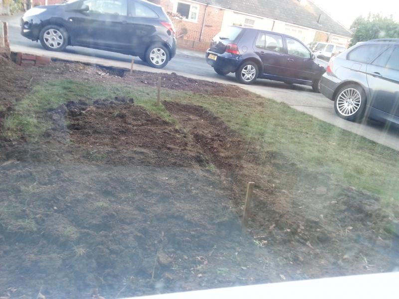

I am putting in a gravel driveway at the front of the house. This is the first time I have donea project like this, so I am just after your thoughts on whether my plan looks okay.
what I plan on doing is digging out half of the grass (to the right of the wooden stakes on my picture) to a depth of 18cm. this Is where the gravel will be going.
I am having the grass section (left of the stakes as you look at my picture) raised to a height of 14cm higher than the finished gravel drive. This will have a strong grass edging to separate the grass from the gravel drive.
in a step format, this is what I am doing:
1. Digging down 18cm on section where gravel is going
2. Putting 14cm of this soil on to the grass section that will be 14cm higher than the gravel once finished.
3. Compresing down the soil using the machine that flattens soil.
4. Will put 5 inches (13cm) of type 1 hardcore on to the soil where the gravel section is going.
5. Using the compressor machine to make it compact
6. Put weed membrane on top of hardcore (or does it go underneath thr hardcore layer?)
7. laying 5cm of gravel
Any advise is greatly appreciated.
thank you
