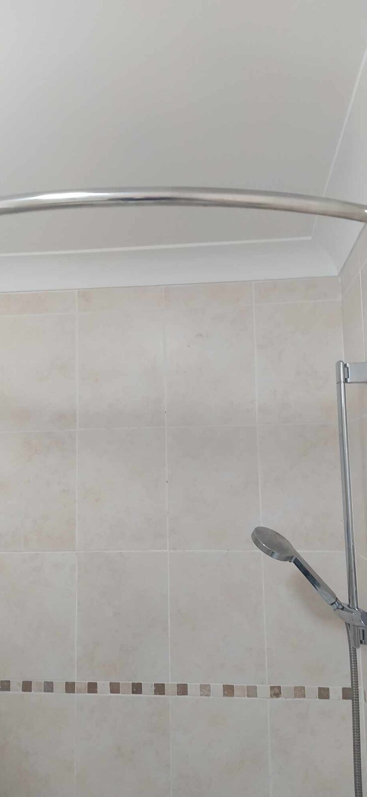

I don't get it.. Our bathroom is in the centre of the house after extending. No window. Has extractor that's always switched off. We can have steamy shower, dry towels ect and no mould or condensation other than for 10 mins after a shower. Then it clears. Not even bathroom paint on ceiling and last painted in 2007 when I put it in.. Bet if there was a window in the bathroom I'd be in trouble.. Just a saying.. Having advised many customers and tried everything to help.
