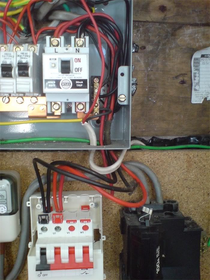

My new improved Isolator to CU tails.....

Some electrica picture porn for you all :lol:
Before.....

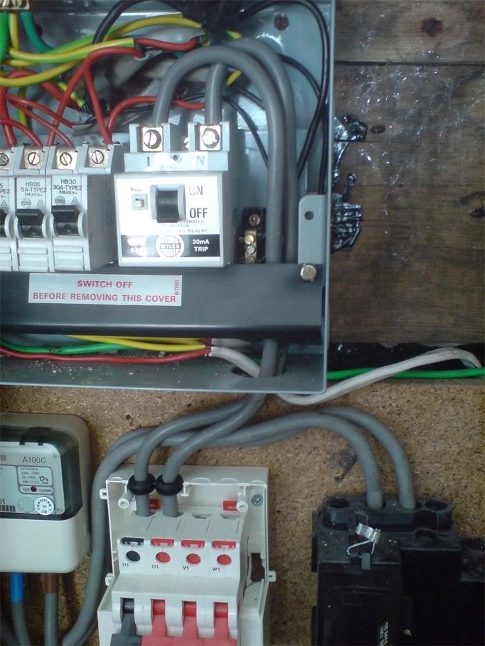

After....
Before anyone says, I did move that dubiously placed earth away from the main bus bar!
send me £1 and I will sell you a rubber grommett for that bare metal knockout edge, chafe chafe.
And put a slit in one side like a lazy bugger rather than remove the tails again!
...and if you identify the live and neutral tails with a bit of brown & blue phase tape it will be a grand job :wink:
Call me Mr Picky but you appear to have a single 30mA RCD as the incomer. A fault on any circuit will disconnect the whole house.
This is not a good thing as you have a single point of failure.
1. Is that some exposed conductor I see? :wink:
2. Is this where you moved it to, or have you moved it again? It might be an idea to bring the cable into the CU through a compression gland to restrain it, as there's some exposed cpc and possibly enough slack in the cable for it to get pushed further into the CU....
