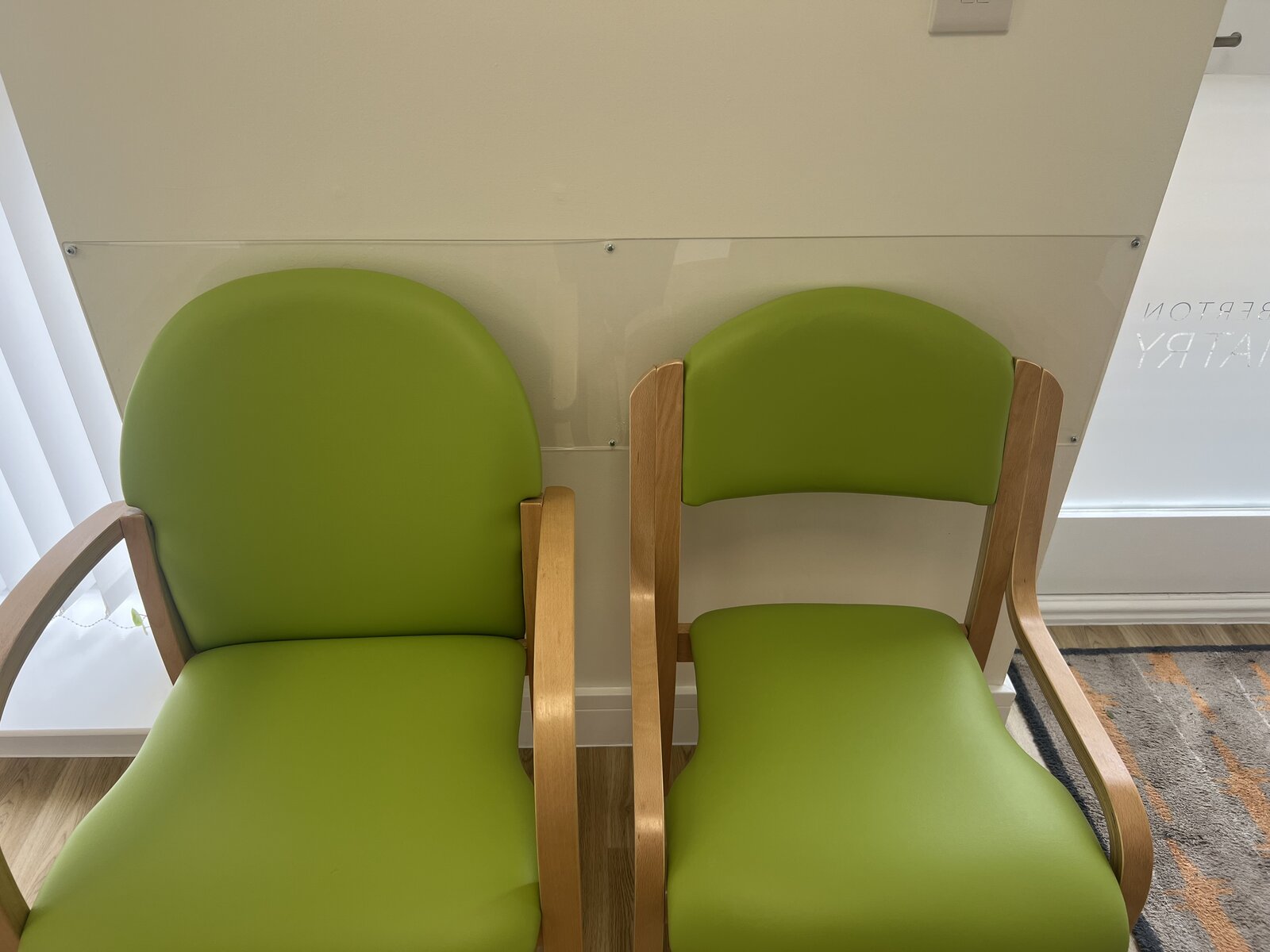

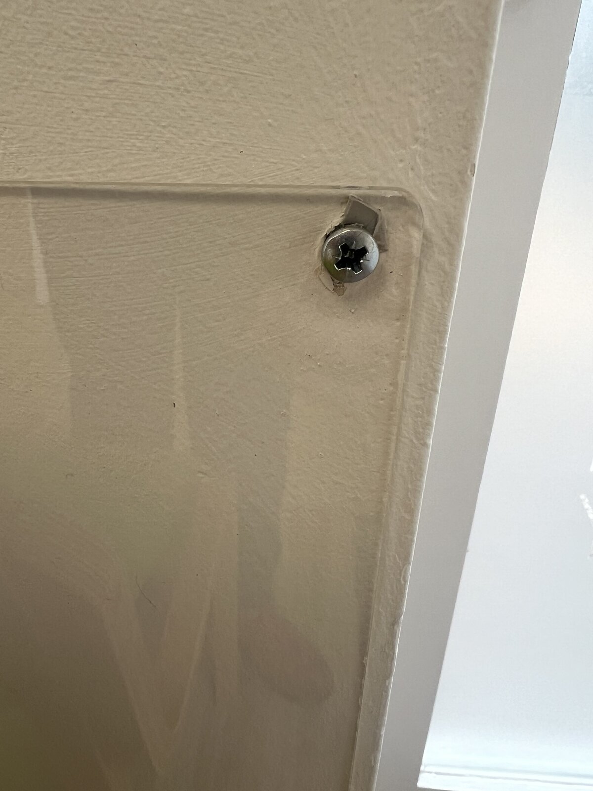

To stop these chairs scuffing the wall at work, I’ve put up an acrylic panel. It’s just been a ******* of a job. Some screws are just wall plugs, some are the proper plasterboard ones. Plus, because the acrylic is probably a bit thin, it’s bowing slightly.
Any ideas on what I can cover the screw with? I bought some white screw caps, but they aren’t deep enough to cover the large screw head. I’m actually happy to buy something that just gets stuck on with a blob of mastic (or blue tac).

Probably too late now but our dentists waiting room had the same problem. He simply laid a plank of wood on the floor between the skirting board and the rear legs of the chairs so that the top/back of the chairs didn’t come into contact with the wall.
Why can't you bury the head and skim the whole board

Aaaaaah now that’s not a bad idea! I do have a bit of oak that would blend in. It’s not to hard to fill the holes and repaint.
The plastic cup washers with covers will look OK. Not sure if that's waht you have already tried, but you can get a larger size that should accommodate your screws.
