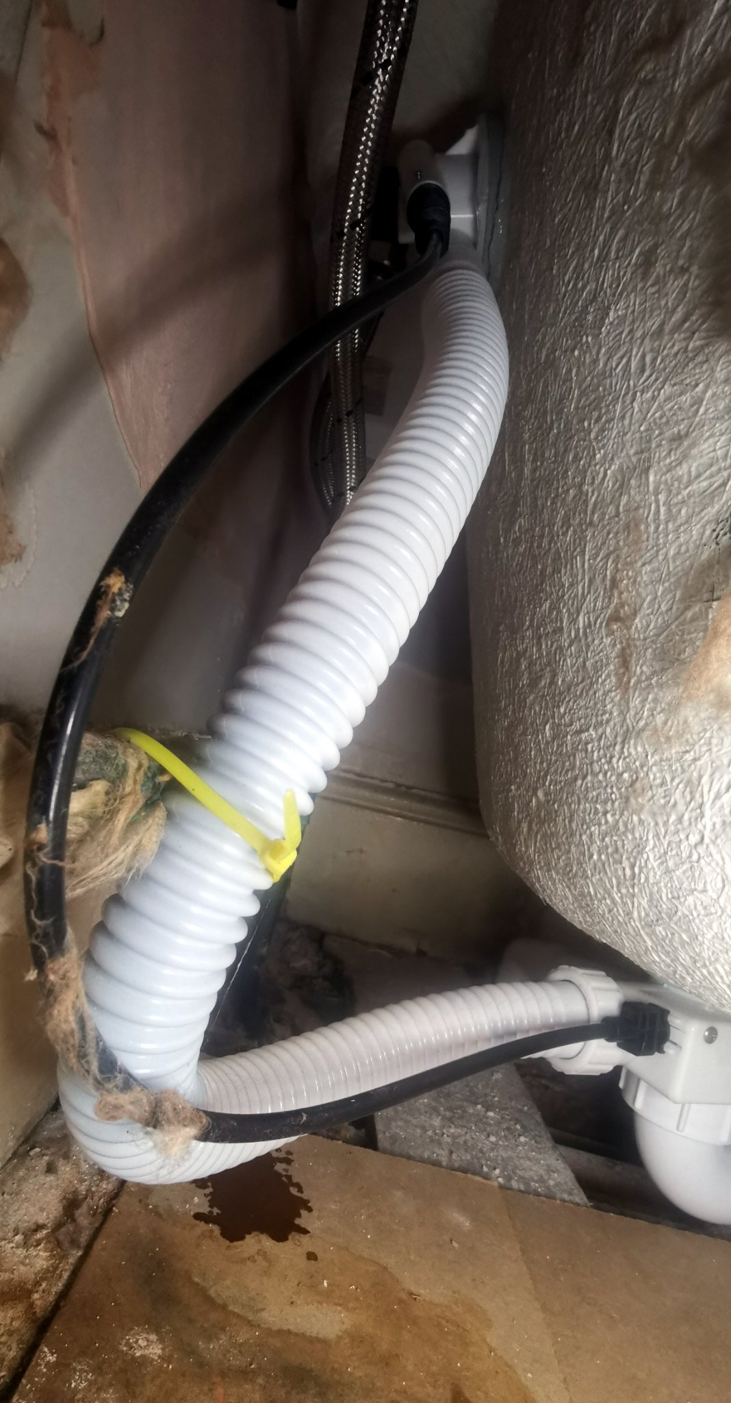

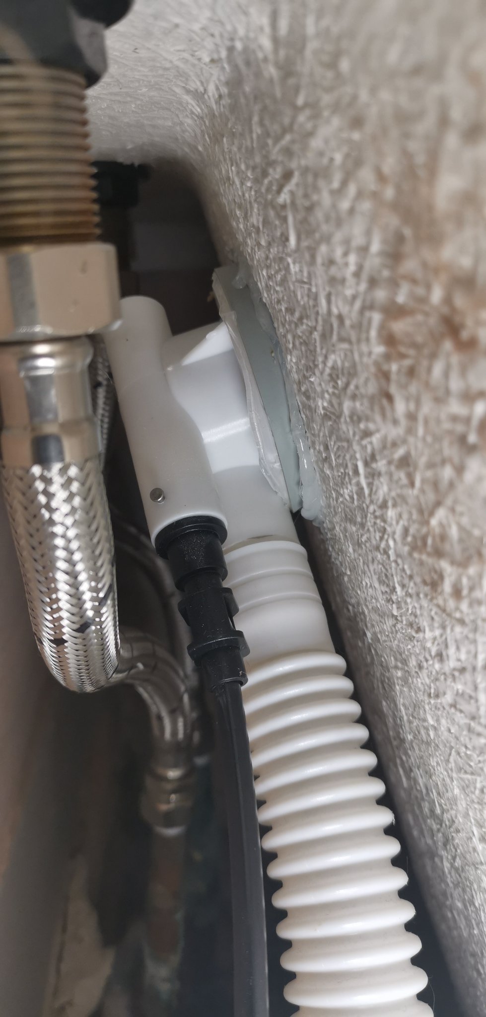

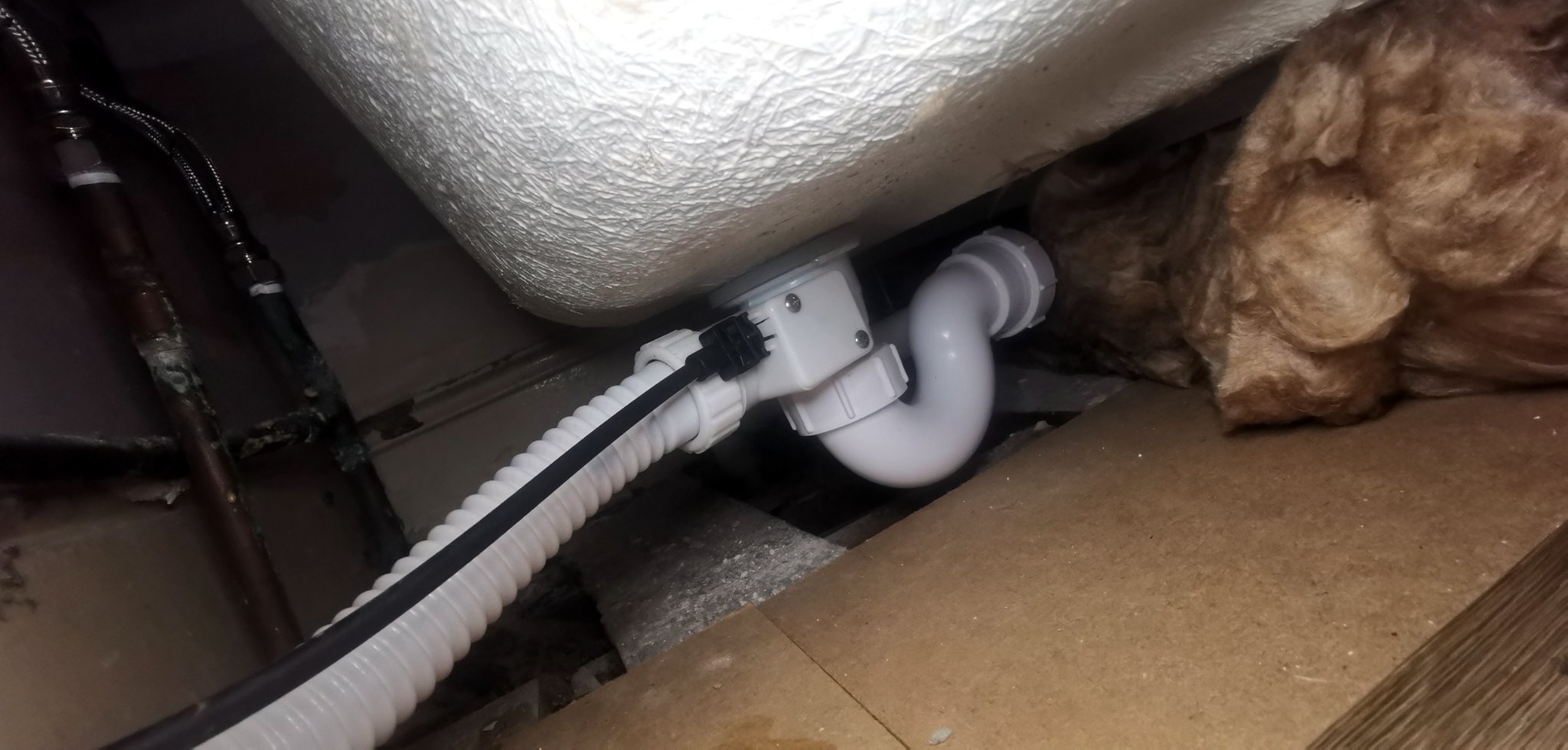

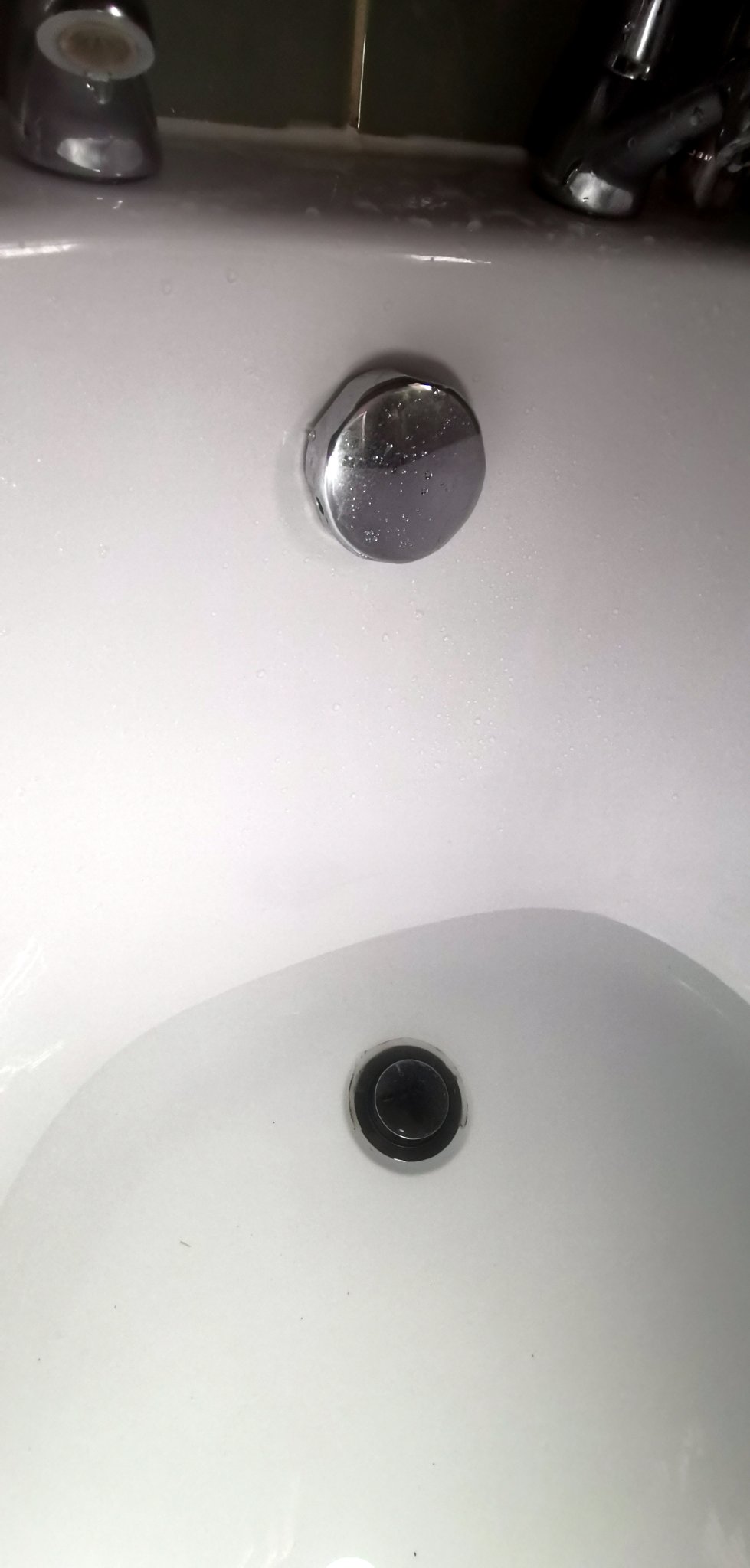

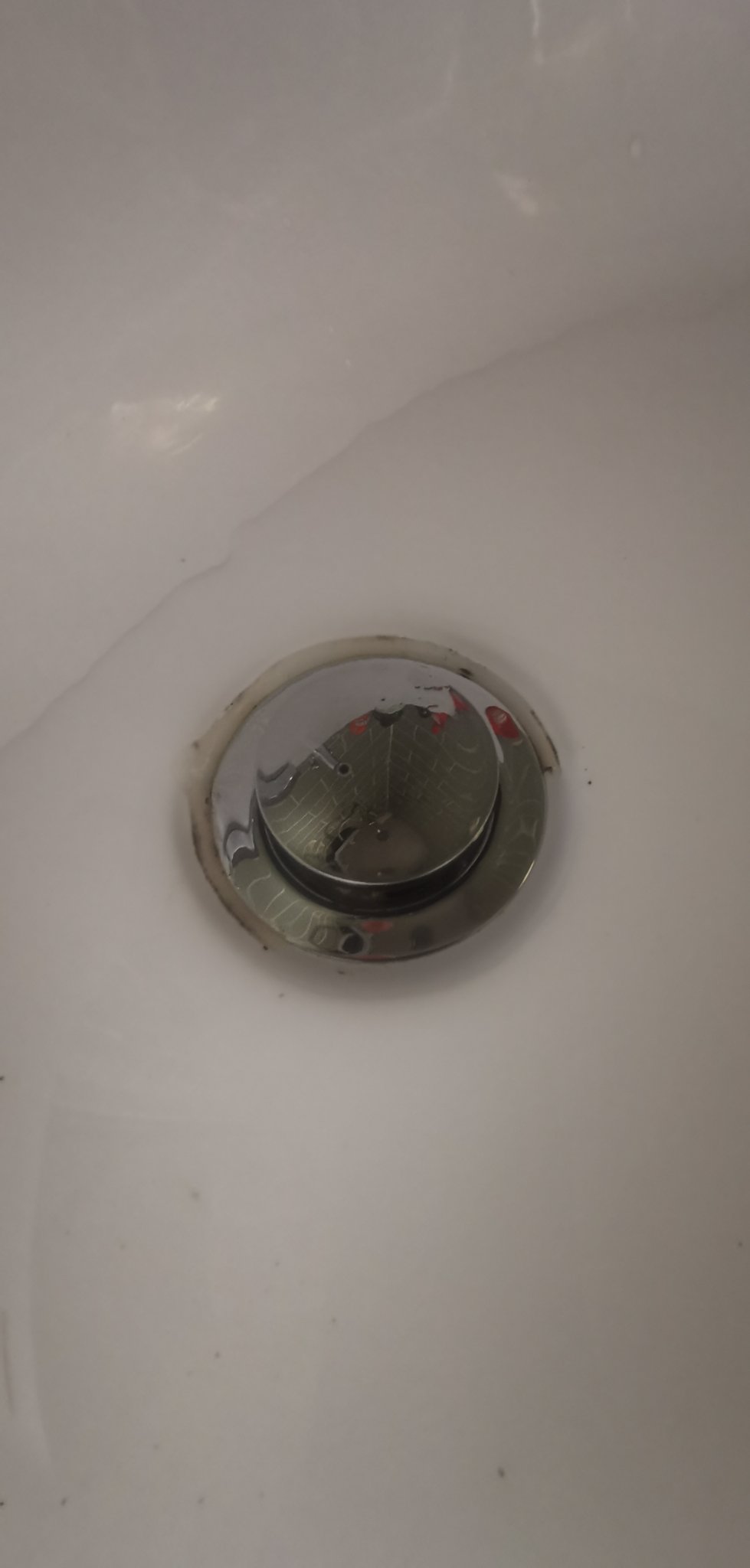

2 years ago we had a new bathroom suite fitted. I had to take the side panel off and after just using the bath, I noticed a small wet puddle that looks to be directly under the white plastic pipe in the photo (it isn't, it just looks that way from the angle) I have felt around all pipes and joints and no trace of water, or even damp seepage. All joints are tight. The only thing is when i turn the plug dial/overflow in the bath, it pivots the connecter under the bath, which I assume should move within its circular housing. The corrugated pipe I fixed with a cable tie as I thought this may have been the issue ( a few weeks ago when I found the same patch) as it move slightly when the dial was turned. Clearly this hasn't solved it. Some of the sealant he did around the plug from the bath side has come out, but again filling with water hasn't caused ay seepage from this area.
I am hoping from the photos I have posted that someone would be able to help as the guy who fitted is no longer available. It doesn't seem logical that water should be here for absolutely no reason. Also, what is hat extra black cable connection that looks electrical ?

The black cable operates the plug?
Hold is and turn knob to confirm as you will feel it.
If you lay news paper under the bath any drips will cause the print to run which may help you see where it's coming from
As above, black cable operates the plug. Nothing electrical about it. As for the leak, try getting water between the taps, overflow et al to see where it may be leaking from.
Prhaps it's a shadow but it looked like a damp patch on the floor under the joint between the flexi and the pipe
Yes, that's the small puddle I am referring to but it's not directly under the pipe. It just looks like it from the angle I took the photo. It Won't do any harm to tighten it a bit more though.
Dry the area under the bath and lay pieces of tissue, the damp/wet areas will help pin down the source
