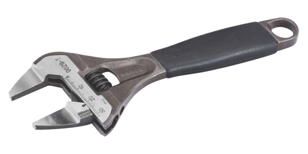

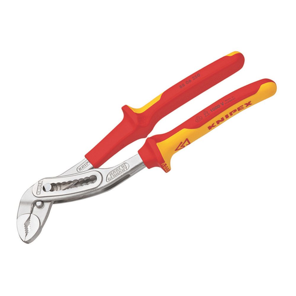

If you are determined and with limited tools then what you need is -
A pair of these
and one of these
