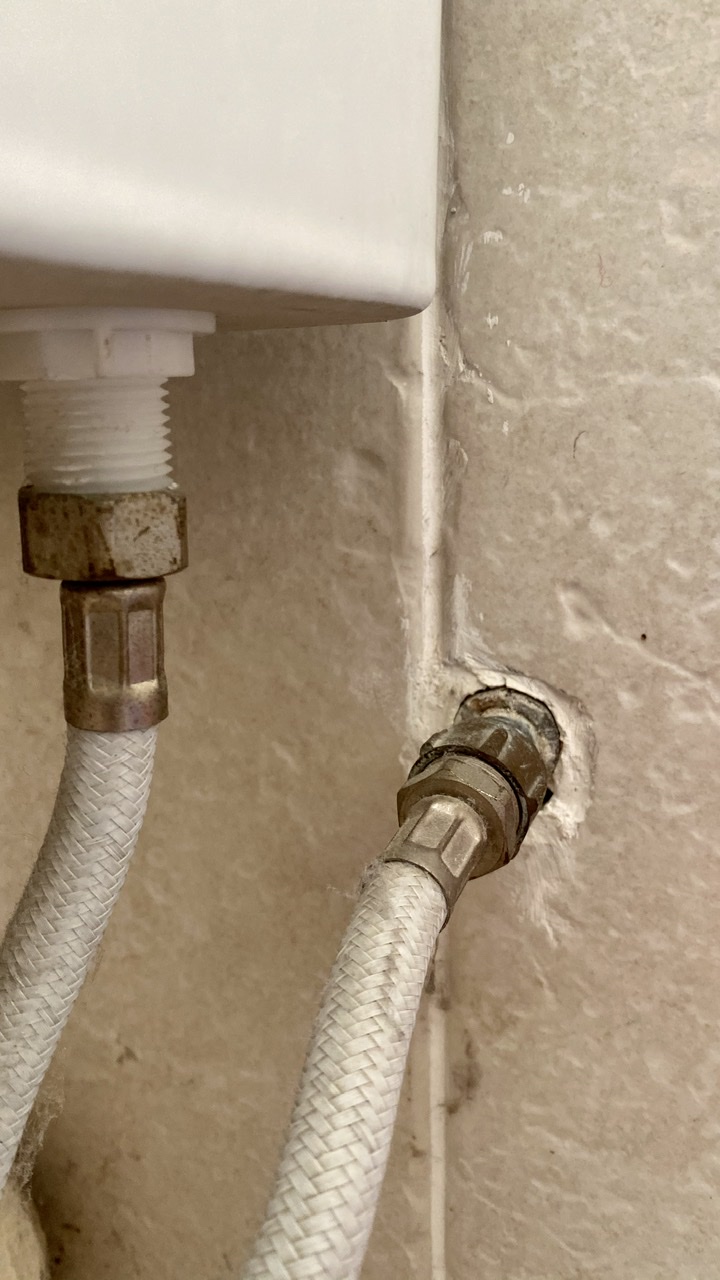

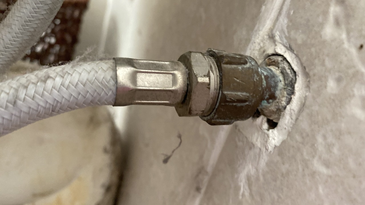

I would like an outside tap for the front of the house. I have already made one for the back, where I tapped into the water supply under the kitchen sink which was relatively straightforward.

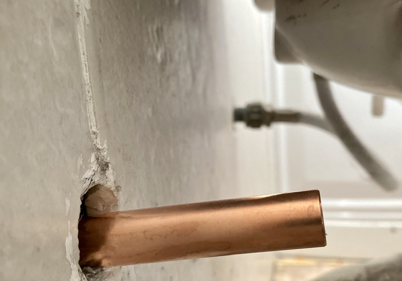

The one at the front is a little tricker. The tail that feeds the toilet is connected to a very short section of 15mm pipe that protrudes from the tiling.
For some reason there was already a 20mm hole through the wall on the opposite side of the toilet and I have purchased a through the wall garden tap connector which is 15mm.
I am trying to figure out the best way to do send water to both the toilet and the outside tap. Some sort of isolator would be great also. Then the shopping list required - as with stores shut I would have to purchase click and collect. What would you guys do here?
Where your existing pipe emerges from the wall, I would fit an elbow, exit pointing towards the second hole, so the new pipework would be hidden by the tank. I would then fit a T in that horizontal pipe, one input, two outputs. One output to feed your toilet, the other your new outdoor tap. I would fit an half turn isolating valve (2x) into each, so each could be turned off separately. Out through the wall to your new tap, I would want use another elbow, but some outdoor tap kits come with a flexible pipe, which may need to be on show inside.
Rather than compression fittings, I would use solder fittings where ever possible, because they are smaller, cheaper and neater.
Is there any play on that pipe feeding the toilet? If so I'd be looking at joining a decent fitting, if not then I'd be looking at (personally a soldered fitting) using a male thread elbow and go from there. Angled left as you're looking at it, a tee, isolation valve for toilet and connections to it, a full bore isolation valve for the garden tap, a double check valve for the garden tap and and elbow to join. Clipped pipework of course, and sleeved through the wall for garden tap.

Thanks very much that makes sense. I have never soldered before always olives and compressions. How difficult is it and what kit?

there is zero play in that pipe. male thread Elbow it is. Thanks for the other suggestions.
