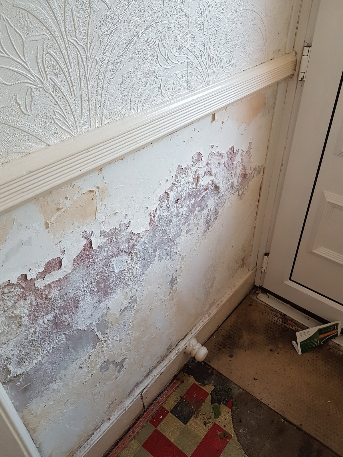

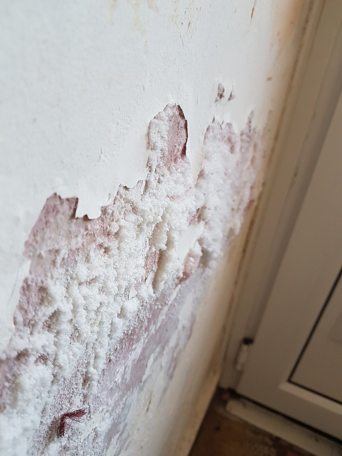

The 1st photo of salts on wall, is directly behind front door. Its the worst wall in the house. The adjoining wall to next door. The entire rest of the hallway walls were covered in plywood panels, but this small are wasnt.
So i guess that if the plywood wasnt fitted, the hall walls would have been exactly like that salty wall. But as the rest was pannelled, the wall's behind were saturated, basicly the walls were sweating behind the panels.

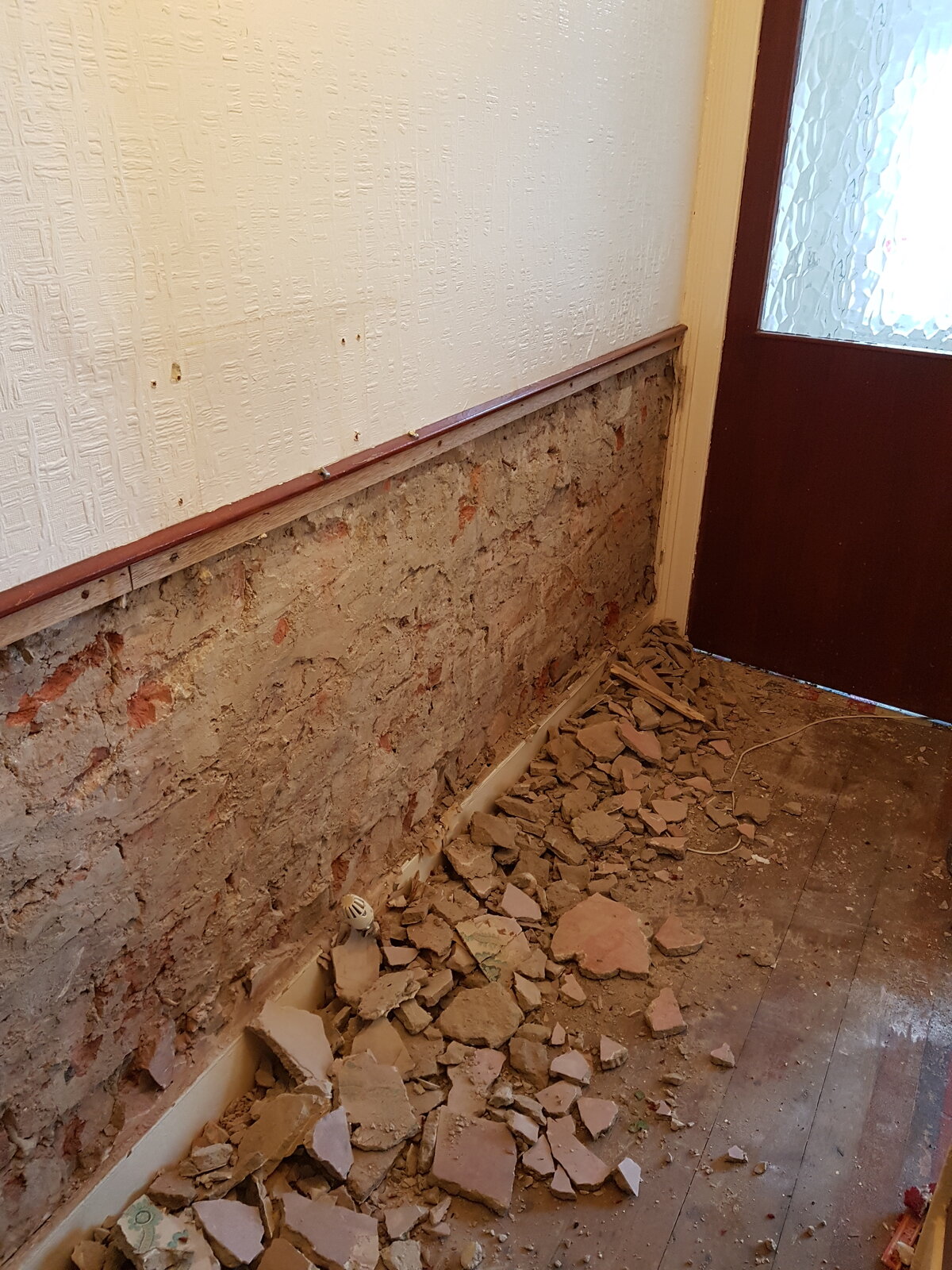

You can see ive removed plaster below the timber rail, which was good , so i wont need to match the plaster in to match the top half of walls.

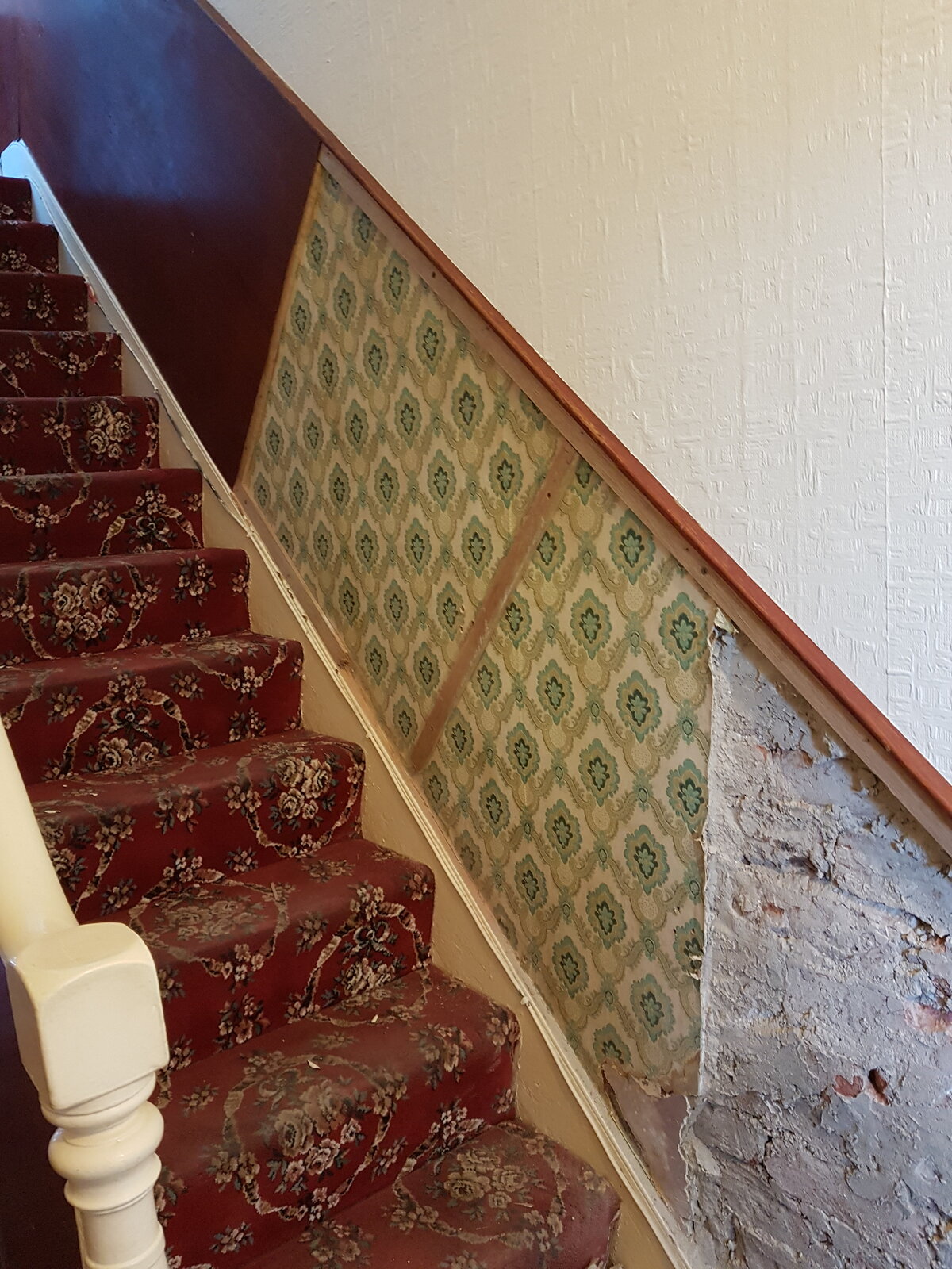

And the photo of stairs is just showing how far i removed plaster, although im going to remove 600mm more plaster , just creeping up the stairs, as i could see a water mark on bricks. So im going to treat wall with salt neutraliser.

Thats all i have atm. Now ive removed the plaster, the brickwork isn't that bad. In hall i can see a water tied mark, but as people said, rising damp is misdiagnosed alot.

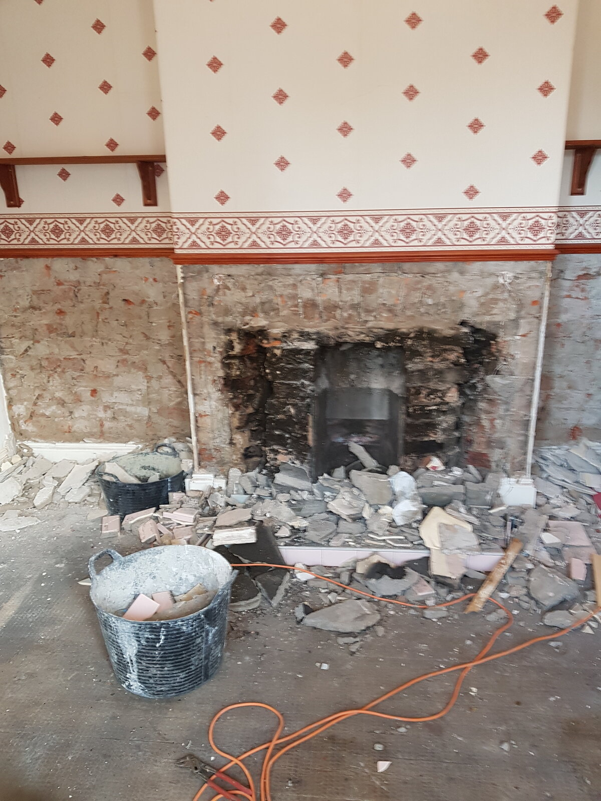

So that leaves chimney breast areas. The alcoves left & right of breasts are also suspect. But most other walls in house look good.

leaving the salt on the wall doesnt help. it absorbs moisture and perpetuates itself. remove it as soon as it appears.
treating the brickwork alone won’t cure it. your cement will need salt inhibitor/waterproofer.
