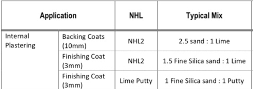

can you give specifics. like mixes and application ?

I'm not going to give specific mixes or tell him exactly how to plaster wall, do I need to do this?
it would be nice. you’re clearly well clued up in lime plaster application ,and where and when to use it. why not help him out?

Of course not. I dont need you to tell me use 4-w1 mix or get your trowel, stick it in the bucket.......you know what i mean? But the damp works i feel are critical. So the sequence and the correct materials are important to me, nice one m8

I've edited the post to include the mix ratios you need for lime plaster.
Note it won't give a baby smooth finish like gypsum.
When painting over lime plaster you need to use a breathable paint preferably clay based from the likes of earthborn etc.
It's expensive, but do it right do it once.
