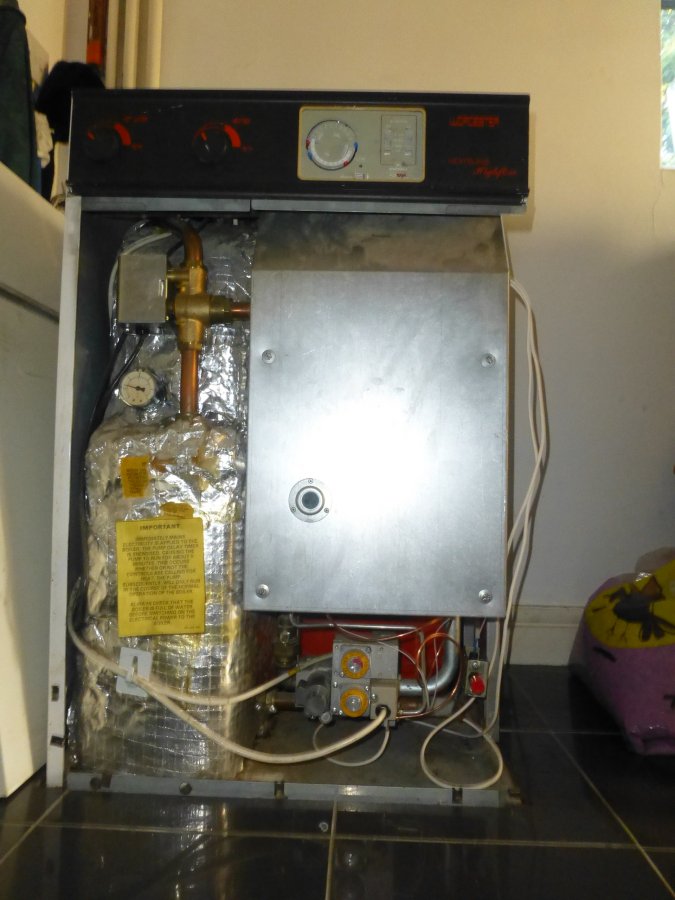

Hello,
I'm looking for a qualified person to replace the Gas Valve on my Worcester boiler as pictured below. The valve is long obsolete but I have managed to get one so now looking for an engineer.

How are you so sure that the gas valve is faulty?

Problem is that pilot light does not stay lit. Reason for thinking its the valve is that, with the electrical power switched off, measuring between the thermocouple copper sheath and the lead going into the back of the valve I have 30mV and the fault finding section in the Installation and Maintenance Instructions says it needs to be minimum 8mV . (Obviously needed to keep the Operating button on the gas valve depressed to keep the pilot lit while I did this measurement)
Will be delighted if proved wrong and it's something cheaper/simpler.

You are missing some understanding of how these things work!
Disconnecting the TC and getting an OPEN CIRCUIT voltage of 30 mV means nothing. Its the on load voltage which is important.
It is much more likely to be the part the white wire goes to which is at fault. But we cannot ask you to look at that as its in a sealed part of the boiler which DIYers should not open.
There are many plumbers who don't fully understand these parts either though. Its easier for them to just say "the boiler is crap" and you need a new one!
Rightly so tony, BUT o/c voltage here due to faulty magneto perhaps:cautious:
Op does say
OP does say
""measuring between the thermocouple copper sheath and the lead going into the back of the valve I have 30mV""
so.......nothing disconnected.
