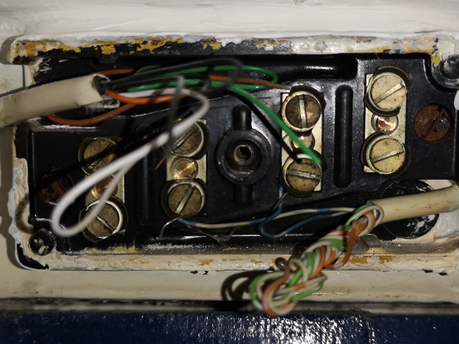

* Junction box at front door - wiring comes through from outside - Has what looks like on top white and orange (or brown - I'm not touching the wiring at the moment given the state) connecting to white/blue and blue/white below respectively.

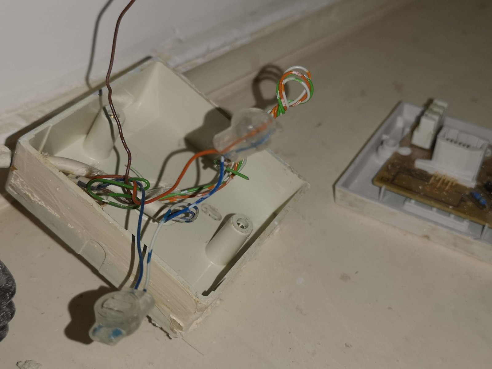

* socket near front door - has been played with (not by me!) white/blue and blue are connected as is blue/white to orange . There is no connection to the actual external socket. I'd assumed this was the main box - until I saw there was a capacitor in the living room box!

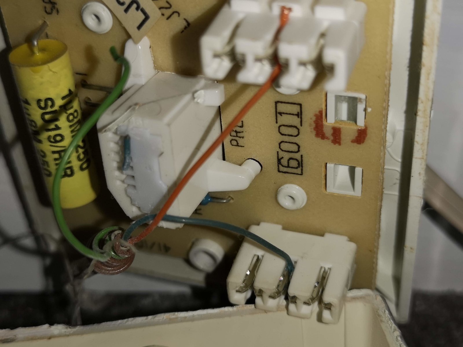

* socket in living room - orange and blue to points 2 and 5 respectively. And a capacitor so assuming this is the main box (not the extension)

Junction is incoming presenting white-> white/blue and orange-> blue/white
This then gets connected at the socket near door white/blue -> blue and blue/white -> orange
The blue and orange then run to the living room and are presented as a "main box

1. in socked near front door which I want to be master connect white/blue to 5 and blue/white to 2 on a new master box
A master socket takes the incoming line on A & B, not the numbered connections. In your case white-blue to A and blue-white to B. Your extensions then come off pins 2 and 5.
That strange cable with only blue,orange,green,brown, can you tell whether it is twisted pair or not? If it's not, replace it with 2 pair CW1308 cable.
On the incoming line from outside, is the green wire stuffed in with the blue-white, or just a camera trick/angle?

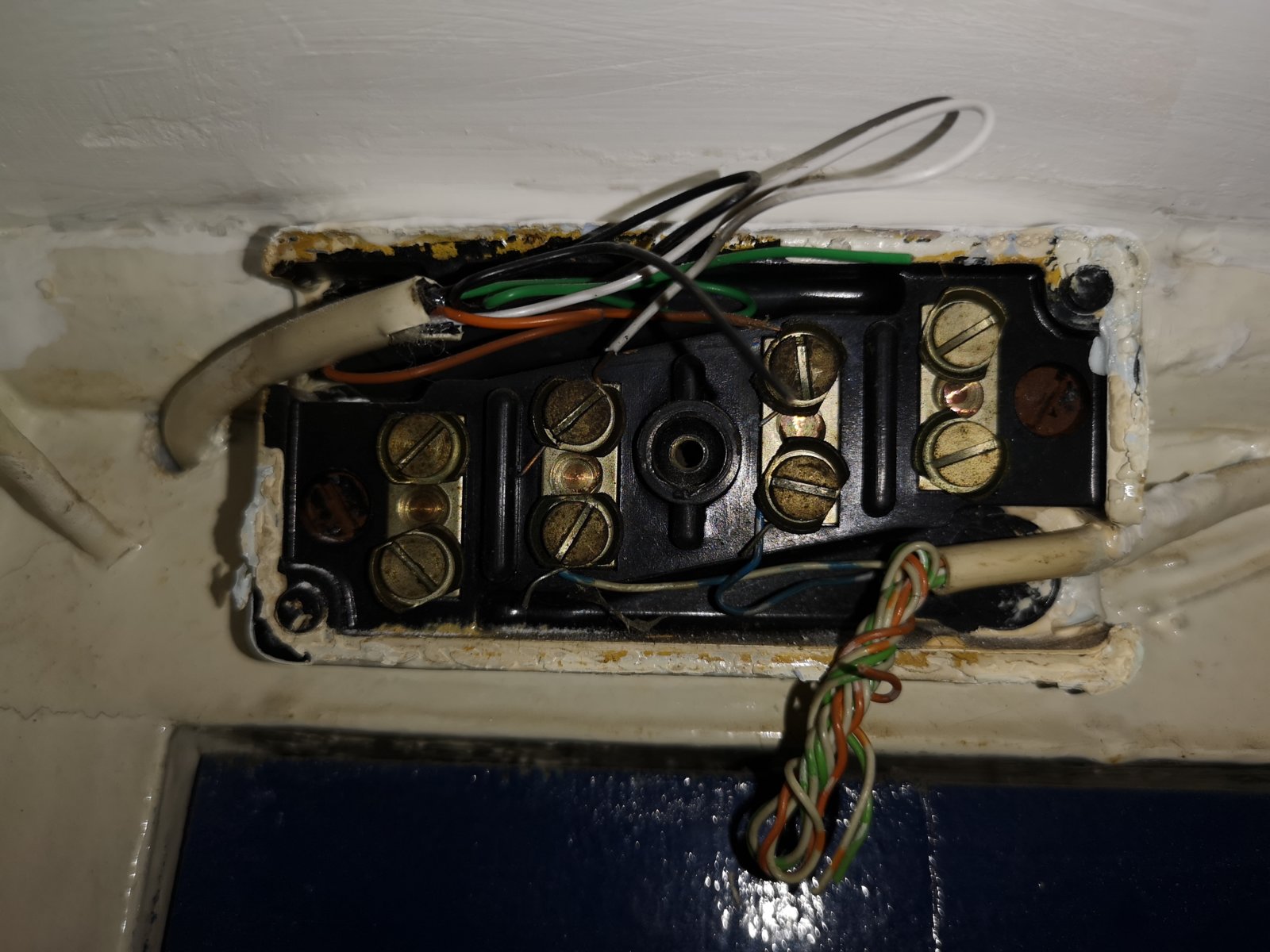

Thanks for quick reply. I've uploaded a better picture.. The green wire is tucked in but doesn't get terminated
So effectively you are saying I would be taking the white-blue and blue-white from the junction box to feed the main box? Sorry just looking to be sure.
On the strange cable... If that's the one at the top there the one coming in from outside... So changing it myself isn't an option.

I mean your extension cable from your 2nd pic to your 3rd pic, Blue & orange in use and green & brown spare.
Your incoming line is Orange, white, green, black.
