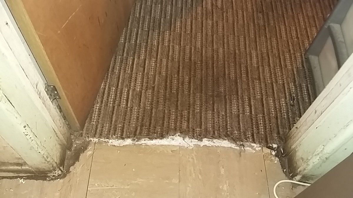

The edge of our carpet is threading a lot.
We have tried metal carpet edges but they don't screw properly in and also prevent the door been closed. Their isn't much space between the door and floor.
We need a solution to stop the carpet threading.
In the picture below you will notice there is glue between the carpet and the tiles. This is to fill a floor gap between the kitchen tiles and living room floor board.

You trim the door to fit a door threshold bar, though if that were my carpet I would be burning it.
Take the door off and trim 10 -15mm off the bottom and then put it back. trim the carpet to a nice neat edge, though it doesn't look the best to start with, but then that's your choice. Once you've got a nice clean edge, put a threshold down that fits over the carpet edge, something like this. You can get them in a lot of different sizes. Put the metal on the floor and mark through the holes then drill and plug the holes and screw it down
http://www.screwfix.com/p/extra-wide-carpet-cover-door-strip-gold-effect-0-9m-x-61mm/52471
Should work fine
Looking at the rest of the decor - get some gaffer tape and tape it down :)
Or get a proper stepped carpet plate and screw it down properly - so far I see no screw holes from any previous attempts.
