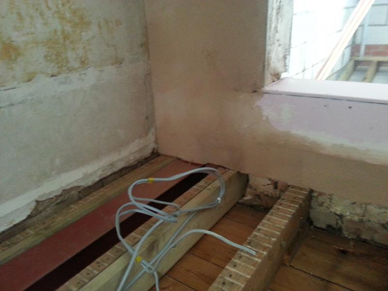

I have attached a picture of the wall the surveyor complained about where we replaced the old concrete beam which was above the old patio doors with a steal beam and one end of the beams supporting the chimney breast is resting (for some reason picture is coming out as upside down).

The report was sent out to both my neighbour and myself and the report is just complete rubbish. He said in the report the beams are resting either on the walls or on turbo blocks/breezeblocks when we used padstones and I provided pictures to the firm weeks ago showing this. He didn't even ask my builder if he used padstones or not when he was on my property.
He then said the wall does not have adequate foundation ( wall in the picture previously) after speaking to the builder even though he did not ask the builder about the foundations and was asking him if the "wall is supported" my builder took that to mean has he strengthened the wall in some way and replied no. The builder underpinned the foundations building control were also present at the time the foundations went in and they have even agreed to give me confirmation of this in writing.
He also states gallow brackets haven't been allowed for over 5 years however I spoke to building control and they said that is not correct you can use them under the right conditions. The worst thing is I didn't use gallow brackets.

All the stuff about gallows brackets and your structural details are a load of nonsense. You have followed professional structural design and the works have been passed by building control. That's all he needs to know. He'll be gone soon so keep your haed down and stick to the plan. Don't get embroiled in arguments that aren't relevant.

Also got the structural engineer back in who designed the supports to check if the builder did the work according to his amended drawings and every thing is good in that department.
