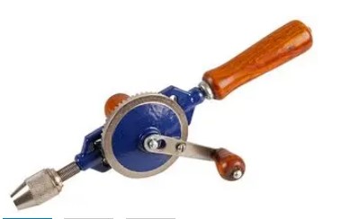

I am a wondering if a hand drill might suffice, mind you a decent one might be as expensive as the product that you linked to.
I have 2 hand drills - this type : bought before battery drills arrived
Far better to look for a British or American made double pinnion hand drill such as a (second hand) Stanley 803, but not sure how small a drill they will hold. The best mid market pin chucks were Eclipse at one time, although a decent engineering supply company such as RDG in Mytholmroyd
W Yorkshire should be able to supply an affordable reasonable facsimile model. Most cordless drill chucks have far too much run out - the only good ones are generally the top of the line trade models which have an all metal gearbox and a high quality all metal chuck to match it - not cheap! Example: Makita DHP481

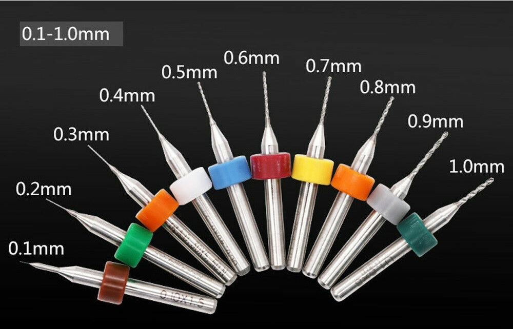

panel pin with a .75mm shank will have about a 1.5-2.mm head on it so fit a 8 and possibly a 13mm chuck if greater than 2mm
just make sure its properly centred and tight to avoid chatter oversizing the hole or dancing across the face
But as they are brittle you need to watch the runout of any drill you use
