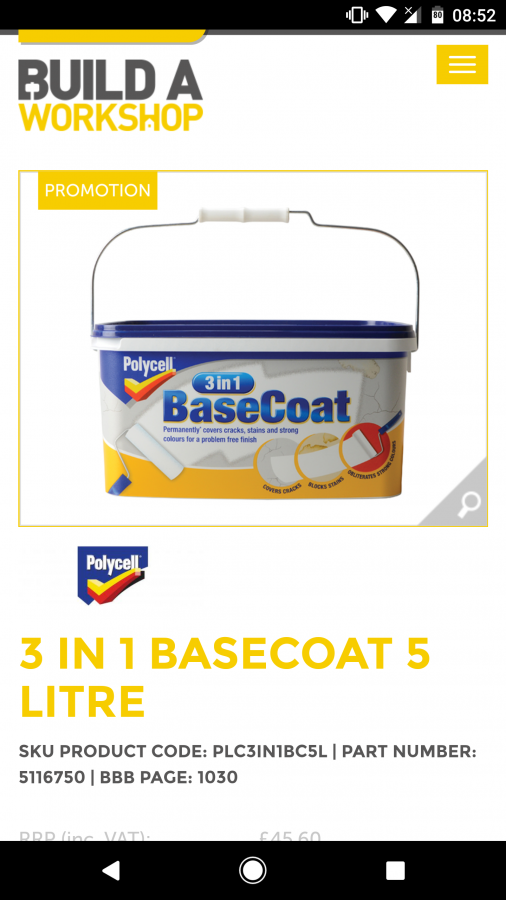

I used this stuff on newly plastered walls and also on new plasterboard as a base before painting my (the wife's) colour of choice.
Done a fair bit of decorating and will always use this from now on as a base. It seems to give a flawless finish. Used it on an old plastered wall that I had to fill a lot of small holes on and the finish was amazing.
