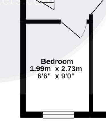

a room 6ft6"x8ft11 may work with a bed if it fits in the 6ft6"
if not assuming 3ft bed will give you just over 2ft at the bed end and just under 5ft along the wall so needs great thought and planning including will doors open safely and will furniture fit in and not be more depressing than sharing

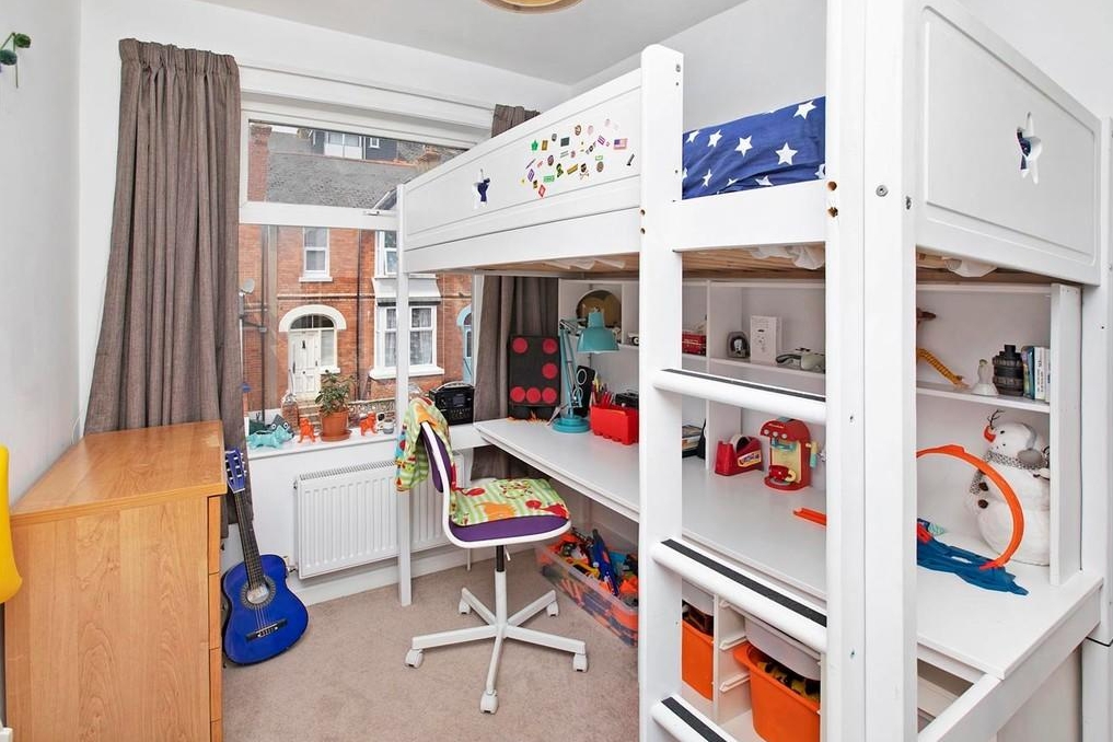

I've just seen those dimensions big-all posted, we've not long moved from a property with a kids bedroom of near enough those exact dimensions, all the houses in the whole terrace and the adjacent few roads all share an identical layout, that will definitely work as a bedroom, but it's definitely not big. We did have a normal bed in there for a good while obviously a bunk bed helps enormously. Some bunk bed designs are much better than others. What you also can't see in that photo is there was space for a Billy bookcase between the end of the bed and the wall.
what age are the people as that will affect the advice that we can give
a 4 to around 7 year old will be perfect for a high bed with desk underneath at 6 or 7 the head banging starts both at the desk and in the bunk
futons are another idea but better for older kids
duvans over framed beds have storage space and can be used as seating all round
beds with frames use up more room as the 3 or 4 inch off the ends are extra as is the side frames over the size off the mattress
