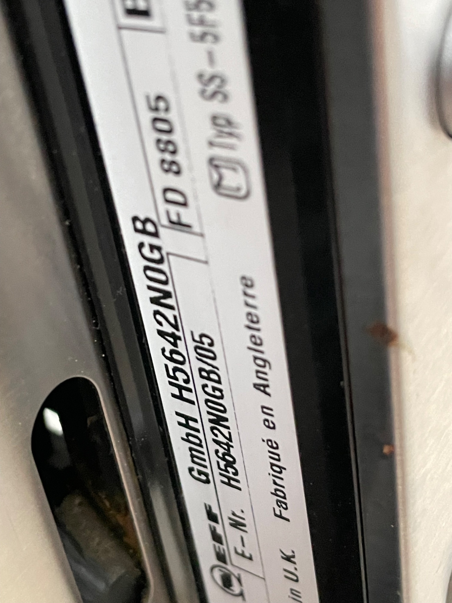

Manufactured May 2008
Probably time for replacement, the efficiency of the microwave reduces over time .The primary heating component, the magnetron, degrades as its internal filament wears out and loses electron emission capacity, usually after 7 to 10 years of regular use
