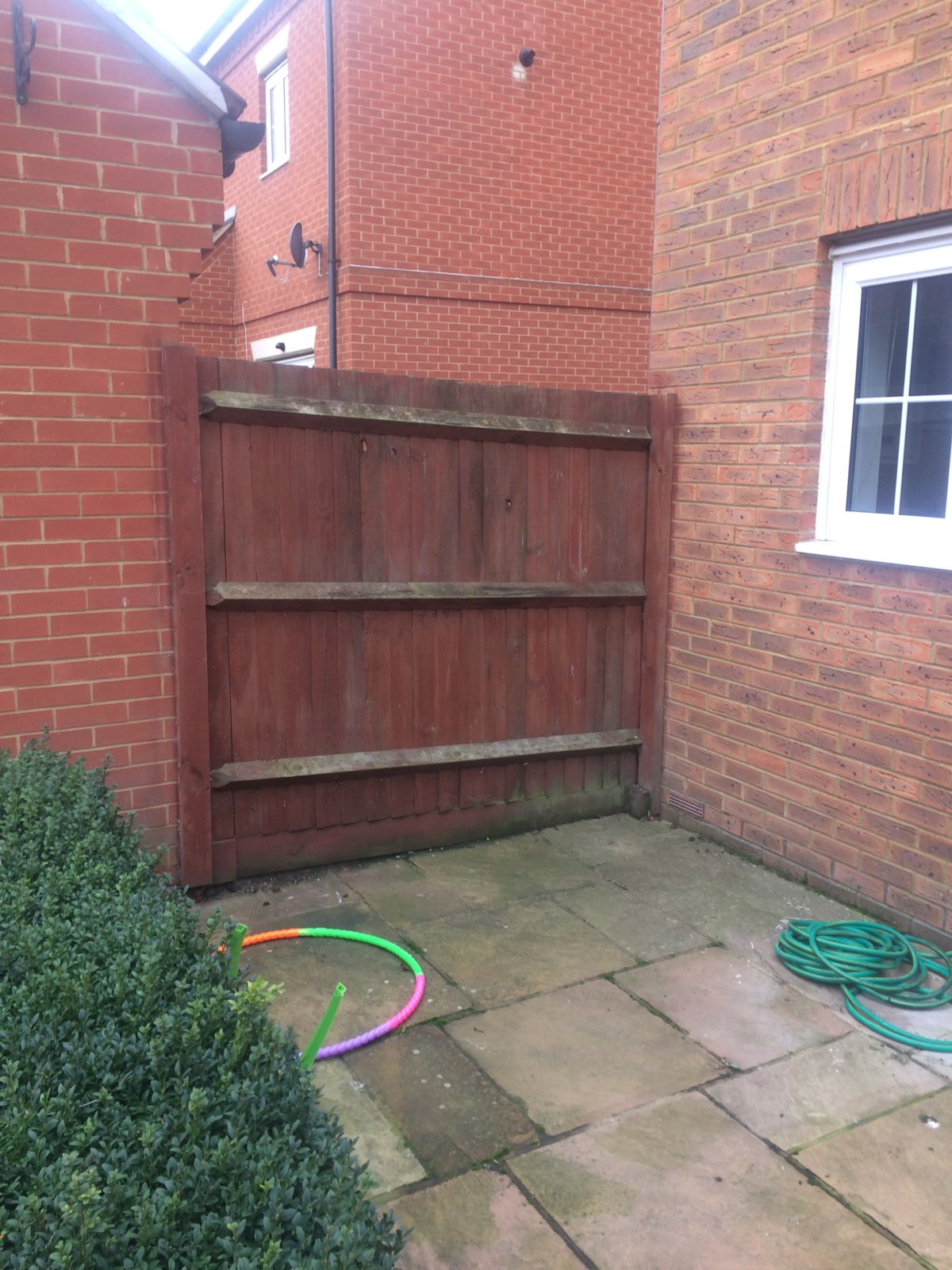

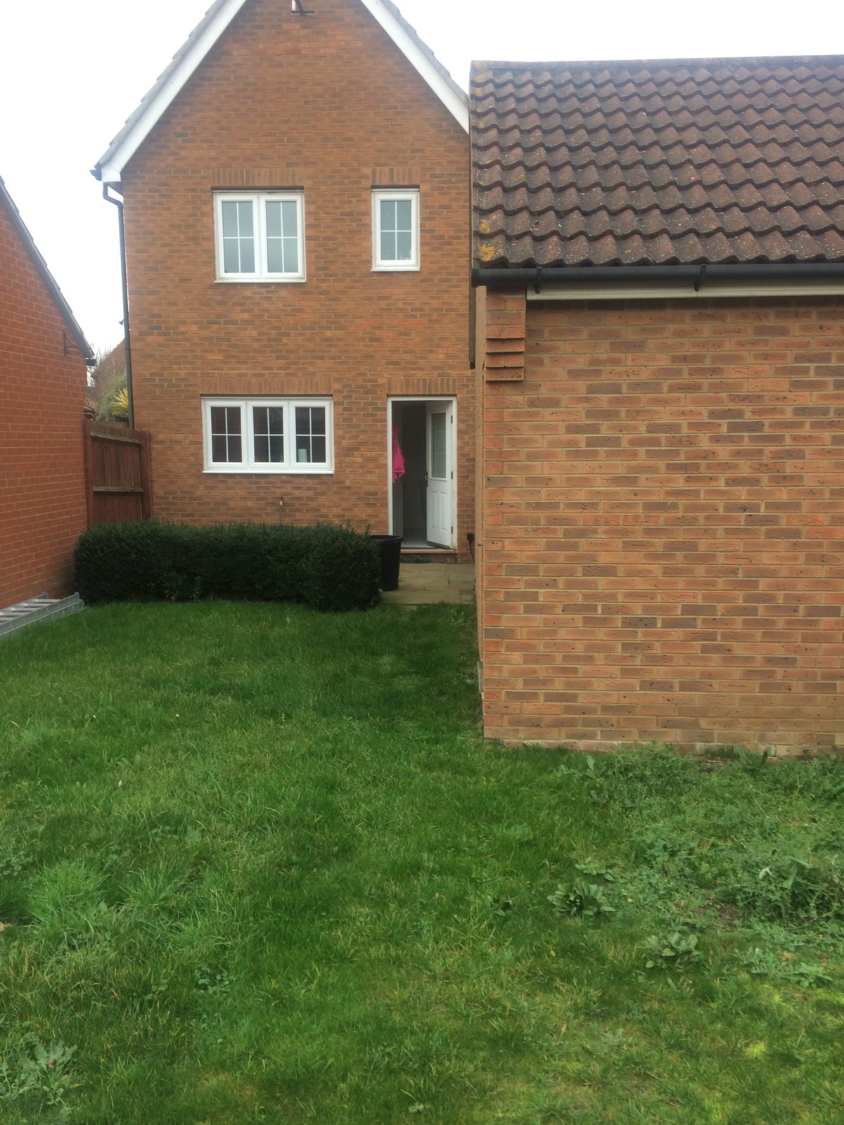

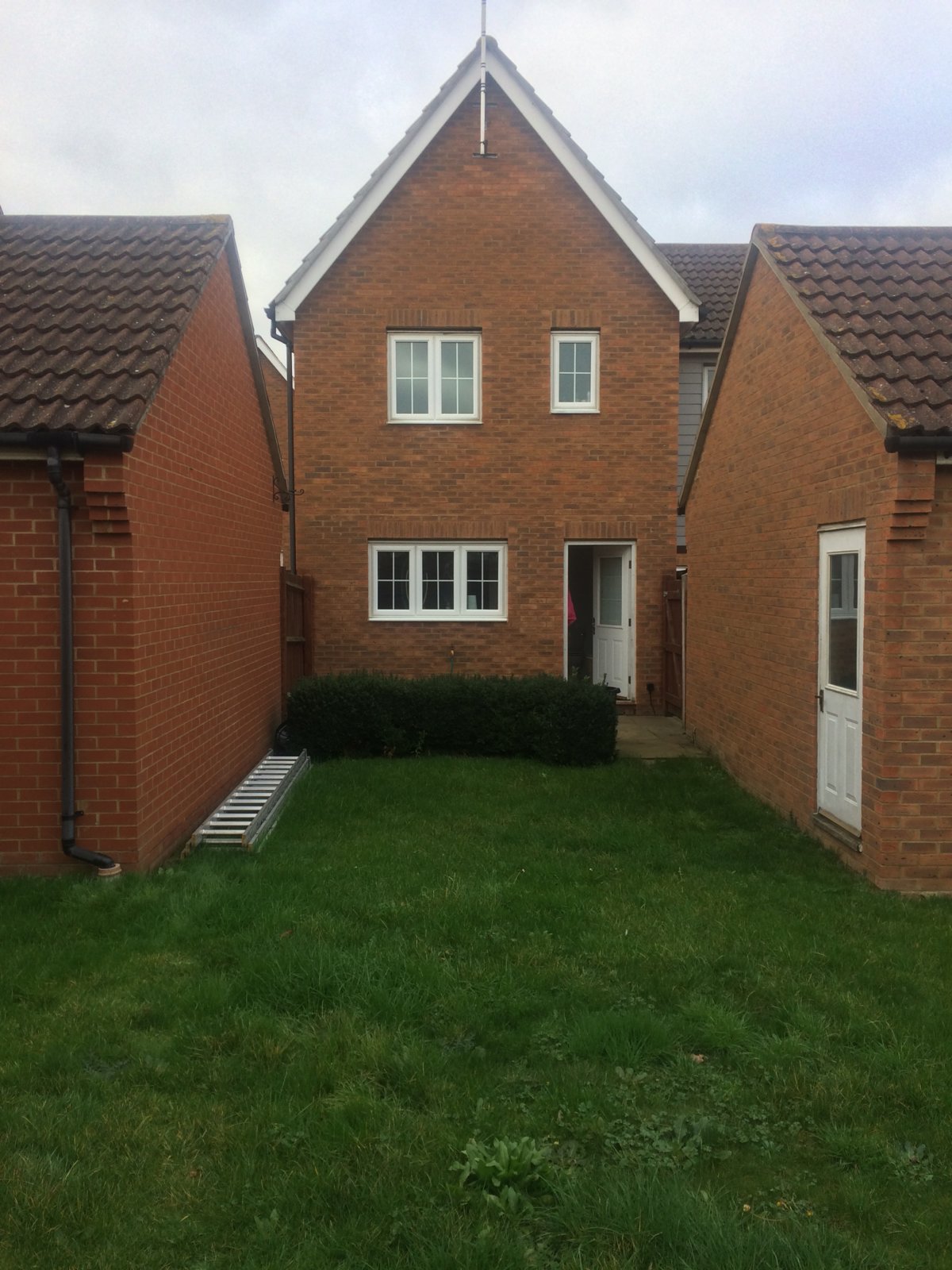

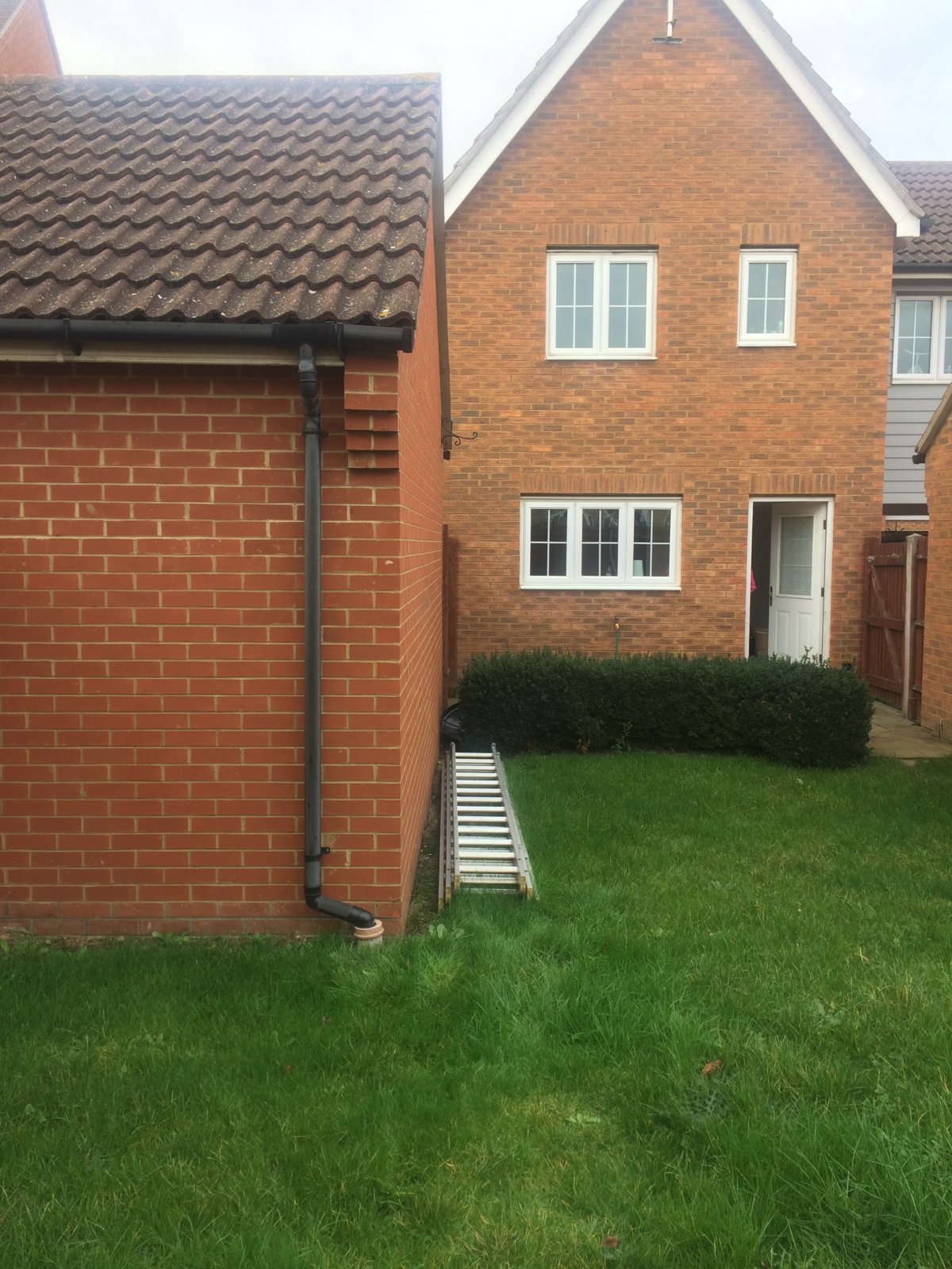

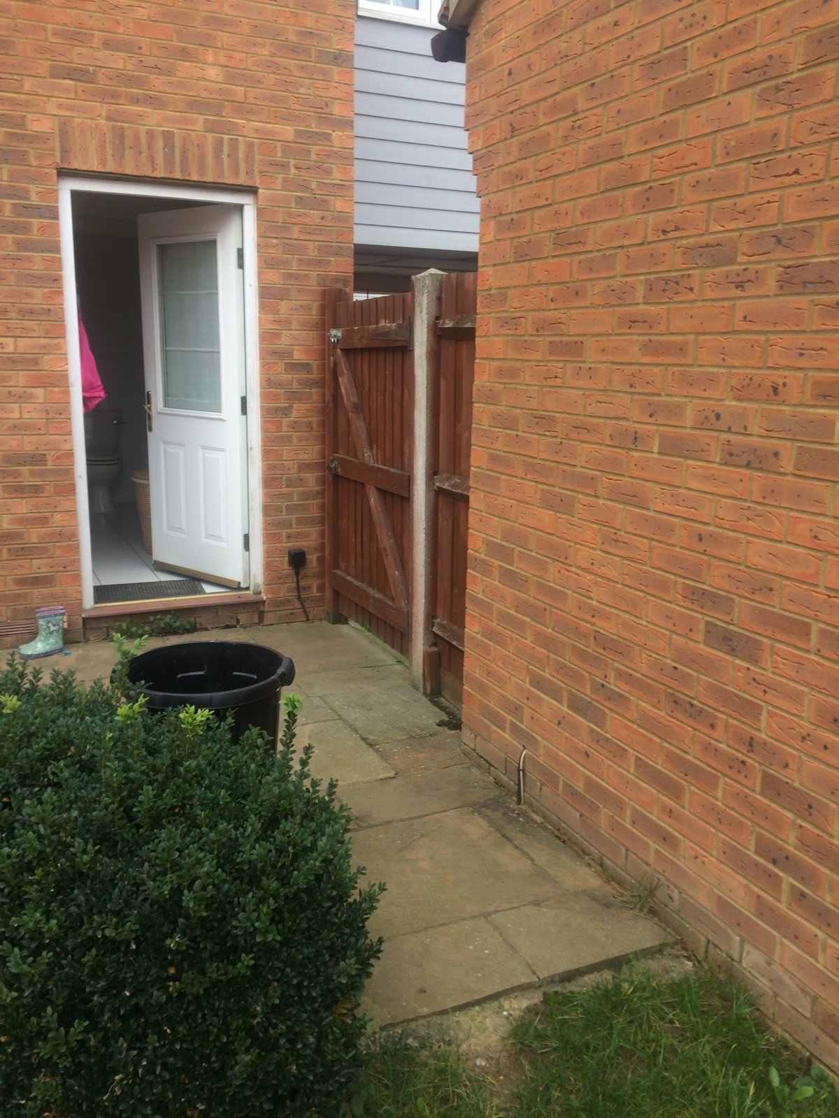

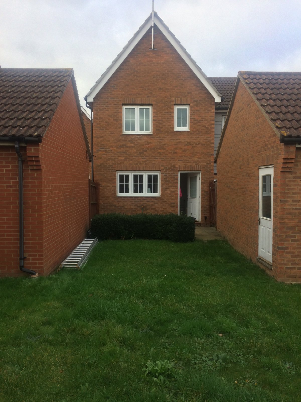

I have attached some photos of the rear of my property. 6m falls just before my garage door. As you can see, both garages are inset by about a brick to the main house walls, and there is 2m between the house and garage. Is there any allowable way that I can use both garage walls as my two extension side walls?
