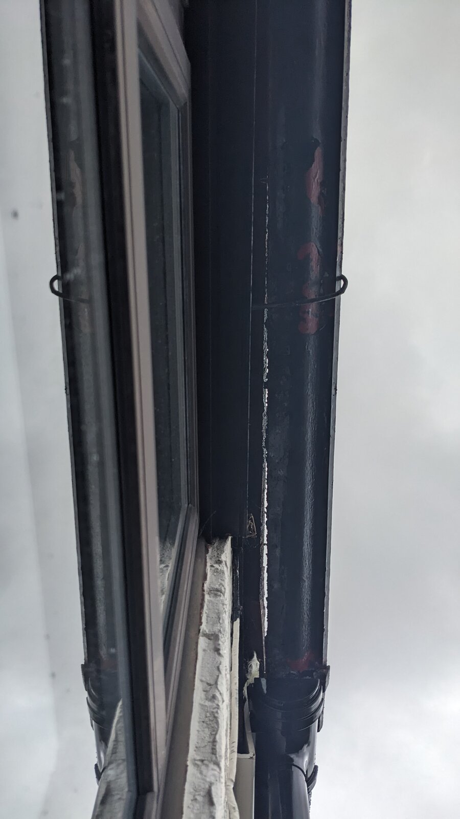

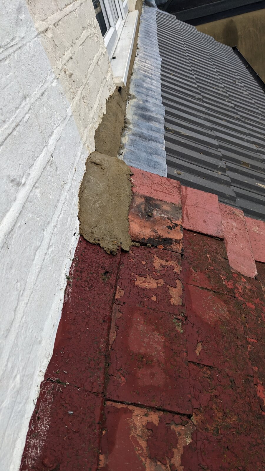

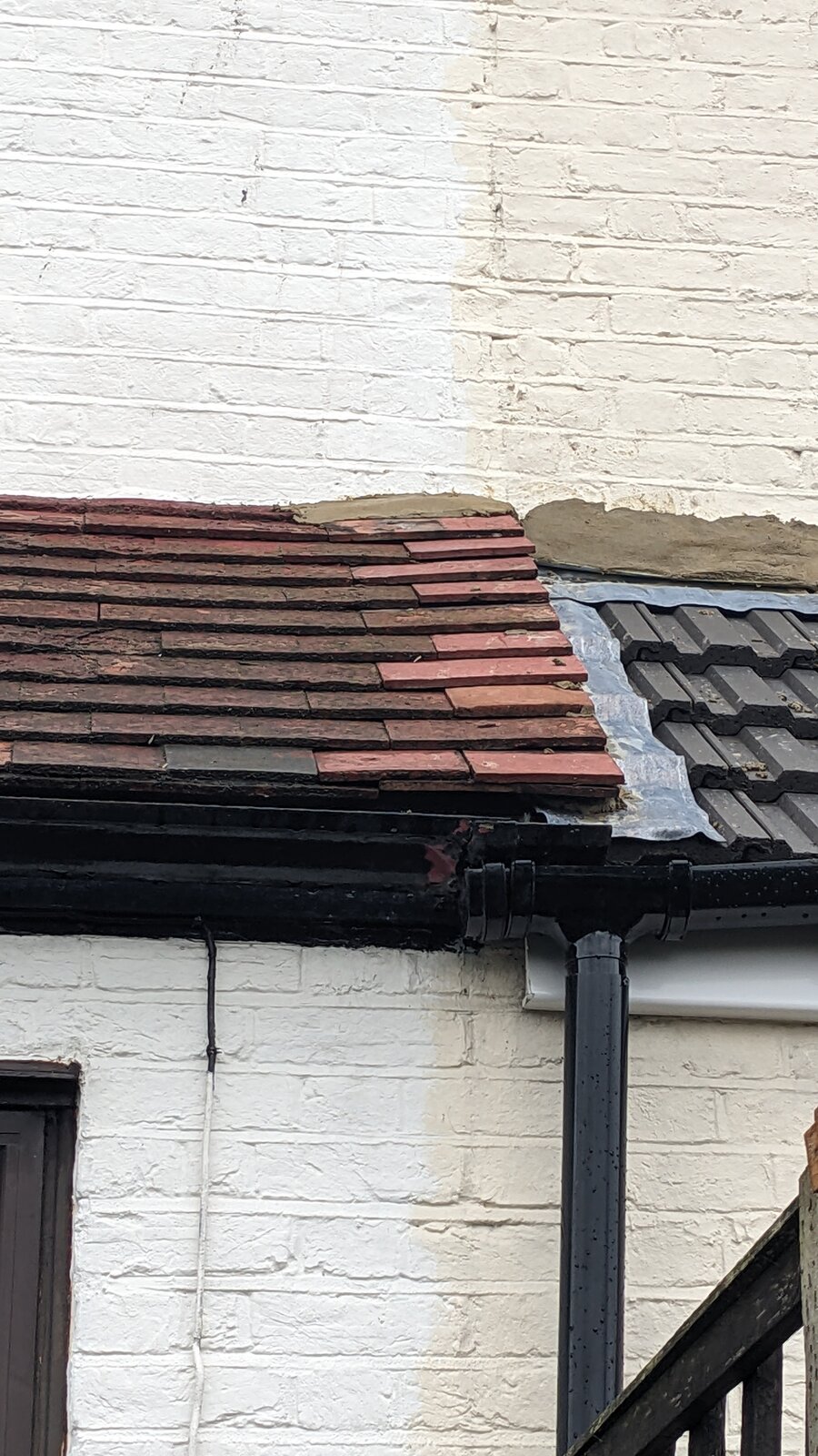

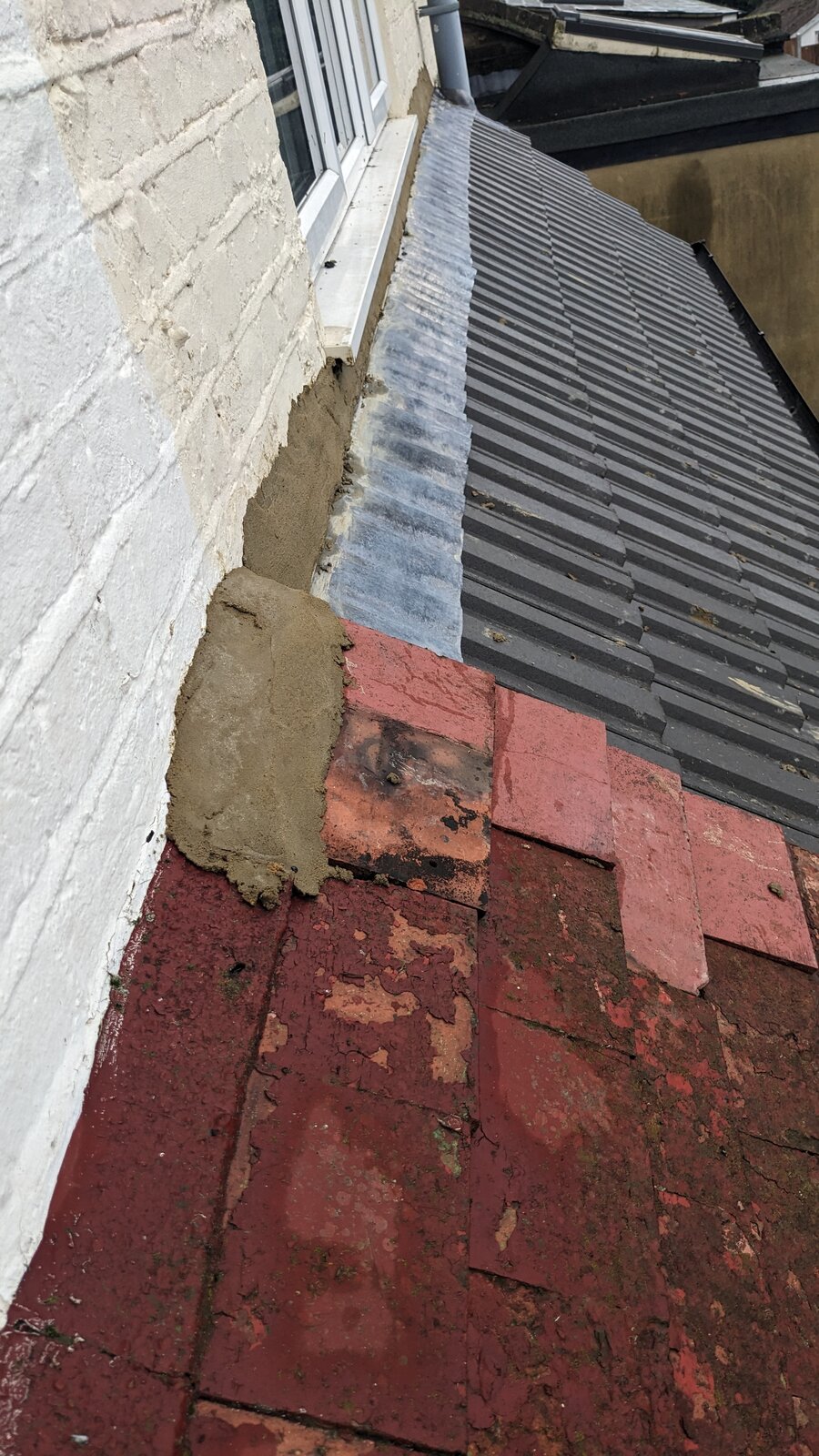

Hi Folks - My neighbour had a roofer over who I believe has done the following:
- Replaced all roof tiles
- Replaced guttering front / back
- New insulation
- Replaced roof tiles on ground floor extension
As part of doing this work, the roofer had done the following:

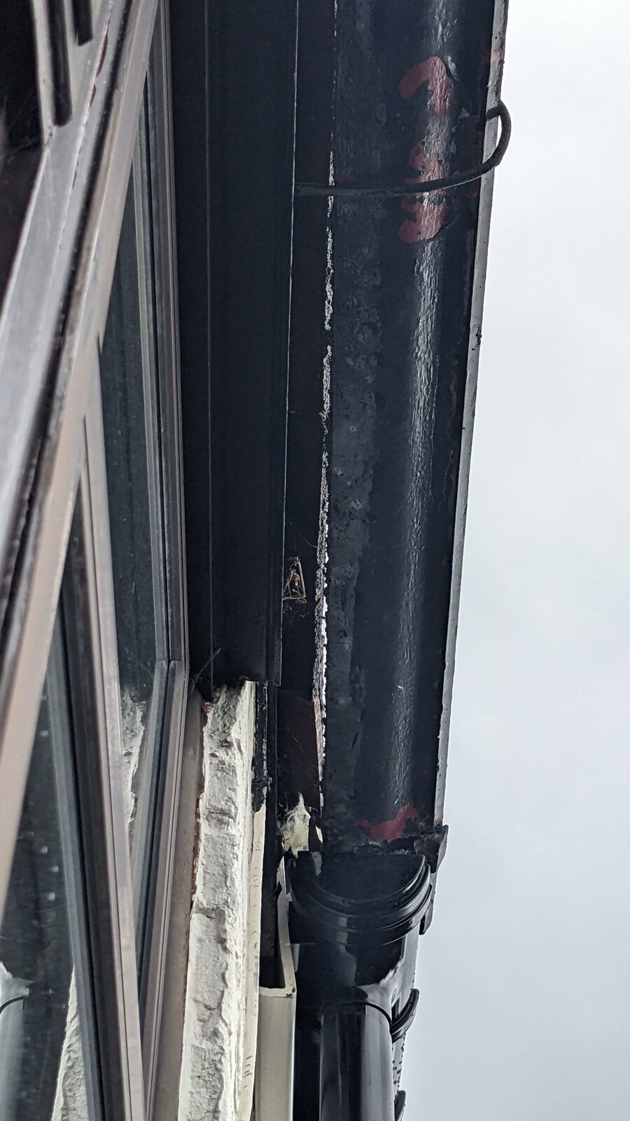

- Attached our front gutters together, previously ours would sit on top of theirs
- Replaced a number of tiles on my ground floor rear extension
- Pulled my ground floor rear gutter away from the fascia board
Reattaching the ground floor rear gutter back to the fascia board seems easy enough but i'm a little concerned with the following:

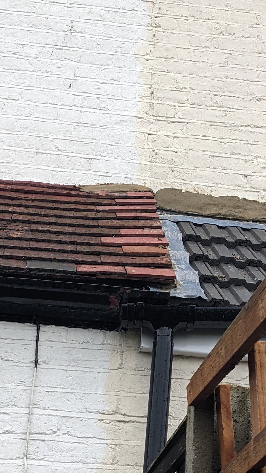

- Tiles have been replaced and now no longer sit flush
- The use of what I think is concrete to fill in / replace what ever was there previously
I am told their roofer is coming over tomorrow to review. How do I ensure the above is repaired correctly?
Would appreciate any advice.

The work hasn’t been done by a roofer
Ask your neighbour how he found the “roofer” my guess is checkatrade or similar online

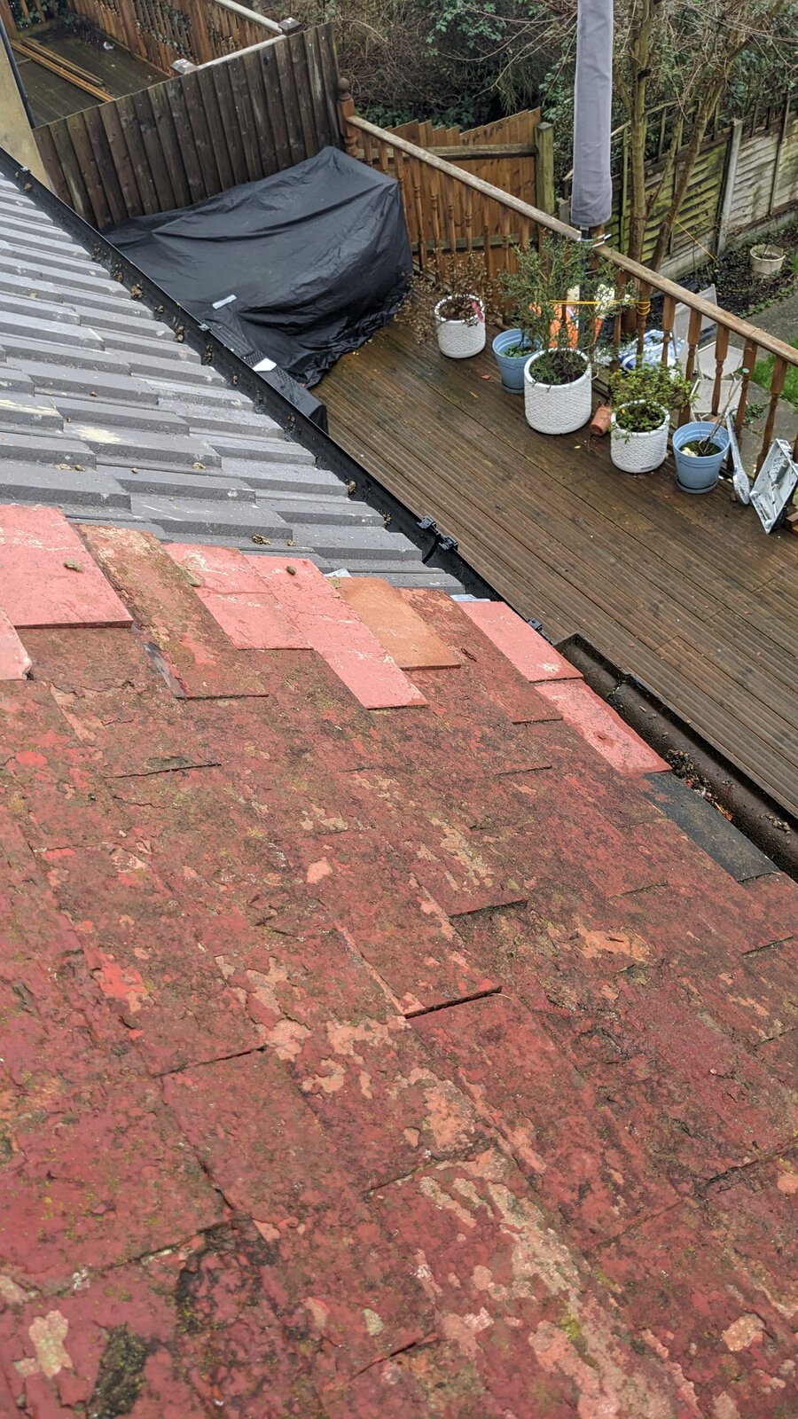

Because there are different tiles, there needs to be a bonding gutter where they join + that needs cutting back tile battens so the tiles sit down straight.
The mortar at the top is a complete waste of time and needs removing, lead flashing is what is needed, nothing else.
It’s a shame your neighbour didn’t just have the clay tiles replaced

I wonder what your neighbour thinks about the work they have had done? Looking at the lead work, they would seem to have just plastered cement over the upper edge, rather than doing it properly - in which case, it will not last.
Is the Red Tiles your roof?
If they are then your roof is on the way out, sorry!
Yep the red roof is mine. And yes well aware that it needs replacing. We moved into this place last Feb so it's on the long list of things to do but for now, it's not (it wasn't...) causing any issues
What would the correct thing to use be, assuming some type of lead mastic / silicone?
The upper edge of the lead, should have been set into the mortar, between the row of brick, then the mortar pointed with mastic. It seems as if what they have done, is simply reuse the previous lead work, but daubed cement over it, to cover over the fact the lead was now too short.

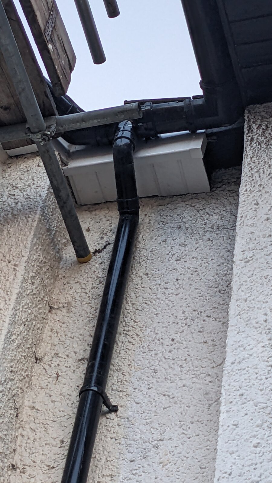

Roofer has come and gone.
They've done the following:
- Replaced the cast iron gutter they broke at the rear ground with PVC
- Applied silicone to the joint that was leaking at the top, front of the house
They said they can't use a bonding gutter as the two ground floor roofs aren't level with one another. Is this true?
My neighbour has said someone from the council is coming over to inspect the work so we'll see how this goes.
Other than keeping an eye on things on things the next few times it rains, is there anything else I should / could be doing?
