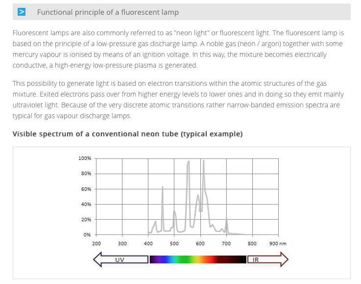

A fluorescent lamp tube is filled with a gas containing low pressure mercury vapor and argon, xenon, neon, or krypton.
His dad is more right than you think, Whinney!
A neon tube is filled with neon and glows red when energised. No way can a florescent tube be called a neon tube.
If you read my response you will see that many fluorescent tubes contain several gases.
What you call a neon lamp (ie the one that glows red) contains neon and a small percentage of Argon.
Neon mixed with other gasses display different colours. Ever been to Piccadilly Circus at night? I thought not.
What you call fluorescent lamps contain a mixture of gases. Often Neon is mixed with mercury vapour or Xenon. It enables initial striking of the tube.
Have a read of this, note the section on Neon filled lamps.
http://www.lamptech.co.uk/Documents/FL Gases.htm
This may be more of an education for you, and also highlights that referring to a fluorescent lamp as a neon lamp is in common parlance. Maybe you should get out more?
