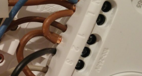

NEST gen 3 fitting on Honeywell programmer and room stat
Yes that looks right connection wise but still needs tidying up.
There is a circle of plastic on the back of the nest under the connections that you can knock out to bring the wires into it, so when you put the cover on you won't see any wires.
Note there was no brown in 1,
The yellow and red from the thermostat were connected to 2 and 3 which I removed and then removed link between 2 and 4. I then re-routed link from 9 to go to 4 instead of 3. I have photo of original layout if it helps.
That's OK, a bit of a complicated way of doing it, but it does reduce the number of links and electrically it works out the same as:
the white wire in the wiring centre terminal 4 will go to the motorised valve, and the yellow wire in wiring centre terminal 9 should be connected to the Nest Heatlink terminal 3 'heating call for heat'.
As there isn't a yellow wire at the Heatlink, there will likely be a change of cable somewhere along the route, but the end result should be that Heatlink 3 is connected to the motorised valves white wire.

The connection going into 4 on the heatlink is not the same colour as the one coming out on 8 on the wiring centre which is a red so somewhere there is a junction.
