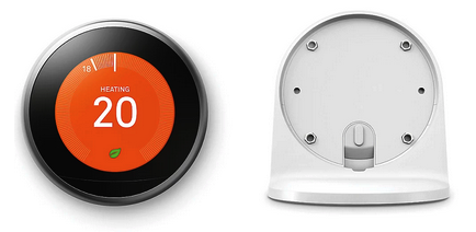

I note one can get a cradle 1662280117662.pngso I would assume with one of them I can move my thermostat into the room in use, but that it seems will leave a empty socket on the wall, and not sure how the thermostat will like being repeatedly unplugged and plugged in between the two receptacle, I could put power to the hall unit and fit a Nest Mini I suppose which would look OK?
But powering the thermostat with USB is not really that good of an idea, with it floating around in a room with two radiators two windows 90º apart, and a patio door, and an open fire, air flow is a bit random.

Temporarily take base and thermostat off the wall, connect it to a USB power supply in your room of choice, and see if it makes a difference!

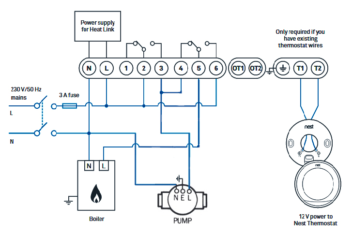

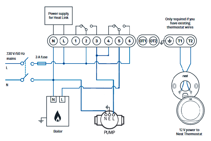

The problem is the cost of the cradle, £35 is nothing if it works, but a lot if it fails. I feel I was conned being told the Energenie worked with Nest, but maybe it did when the advert was written, but the way the wired follows this basic plan 1662327484605.jpegalthough slightly more complex due to having two pumps, but the N/O and N/C contacts are feed in, and Com feed out to boiler, reverse to standard way with Y and S plans, and finding a thermostat/programmer with the volt free contacts seems to be a problem. I know I could use a relay, but that seems to be getting a little complicated, and some day I will not be around to repair it, so want to try and keep it simple.

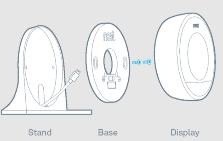

As I said, you don't need the cradle to experiment.
Just disconnect the Nest (and the base, the nest won't work on its own without the base) and plug it into a USB power supply.
All the the cradle is, is a stand for the base and the nest.
You then just prop the nest in an appropriate position.
If it works, good! Buy a cradle!
If it doesn't, put it back on the wall in the hallway :)

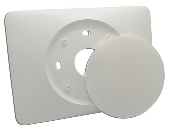

The base
from memory has two wires connected to it, I suspect I need a new backing plate
for the USB to plug into instead of having the two wires? It seems you can get blanks. 1662330270859.pngHowever it is nearly three years since I fitted it, I have not pulled it off the wall to look to see if there is a USB socket as well as the terminals for the two wires, and since not cold yet, no point pulling it off the wall now, need to wait until cold first.
