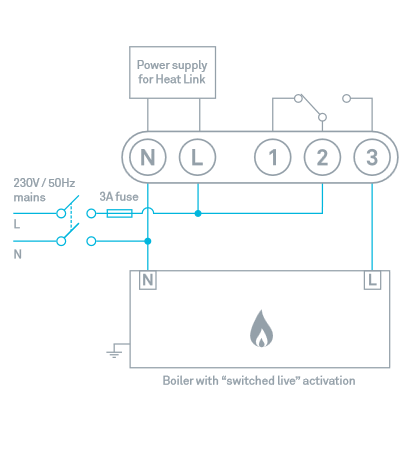

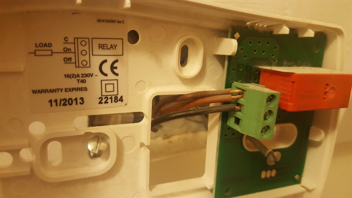

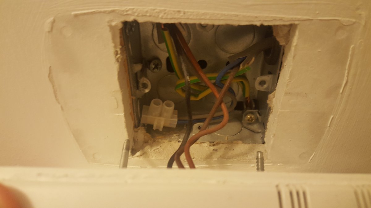

So I've taken the punt in buying a Nest and have consulted the wiring diagram for my existing Digistat and what the Heat Link requires.
I've got these available in the wall...
These connected at the Digistat...
And here's what I presume is the relevant diagram from the Nest manual...
I intend to do as follows...
Black Digistat to Nest 3
Blue spare in wall to Nest N
Brown Digistat to Nest L
Jumper Nest L with Nest 2
Not sure about the remaining red, second, wire going into C on the Digistat though.
Is this correct?

Good. Unfortunately, because the existing thermostat is battery powered, the wires going to the Digistat thermostat are just used for switching and can be inserted either way around. So it's not possible to say for certainty which is the permanent live and which is the switched live.
If I had wired it up, then I would agree with your assumptions and say that you are right, and that the Red and Brown would stay together as they are, and go to the Nest L. It is unlikely (but not unknown) that a black has been used for the permanent Live in this installation, and it is far more likely to be the switched live (heating on) and that the Blue and Grey are Neutrals.
However to be sure, it would be wise to check first with a multimeter.

The photo shows that the warranty on the Digistat expired over 3 years ago, so I would expect the installation to be over 4 years old.
