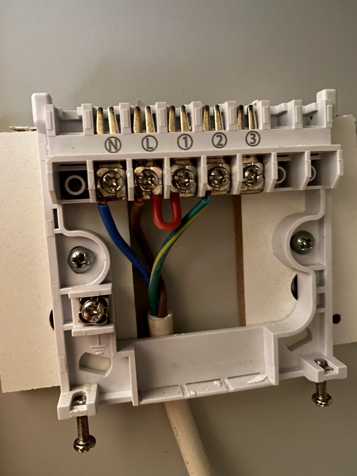

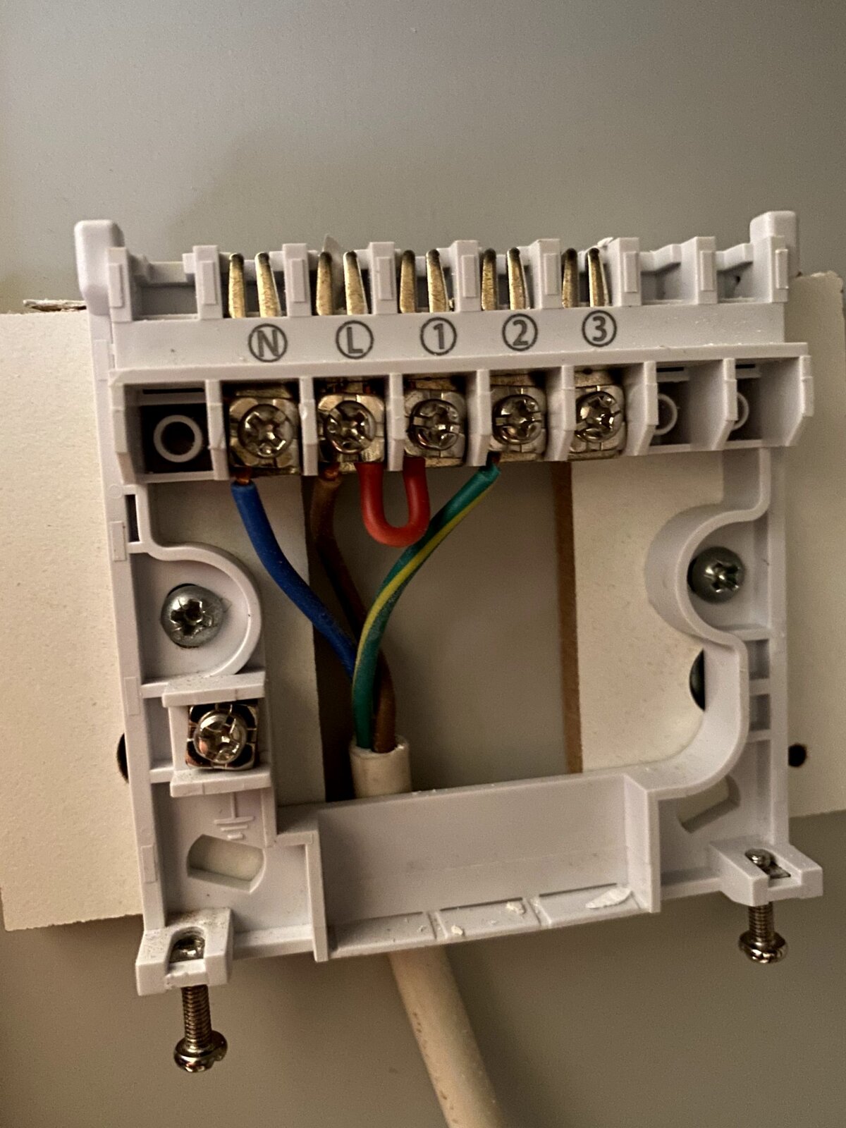

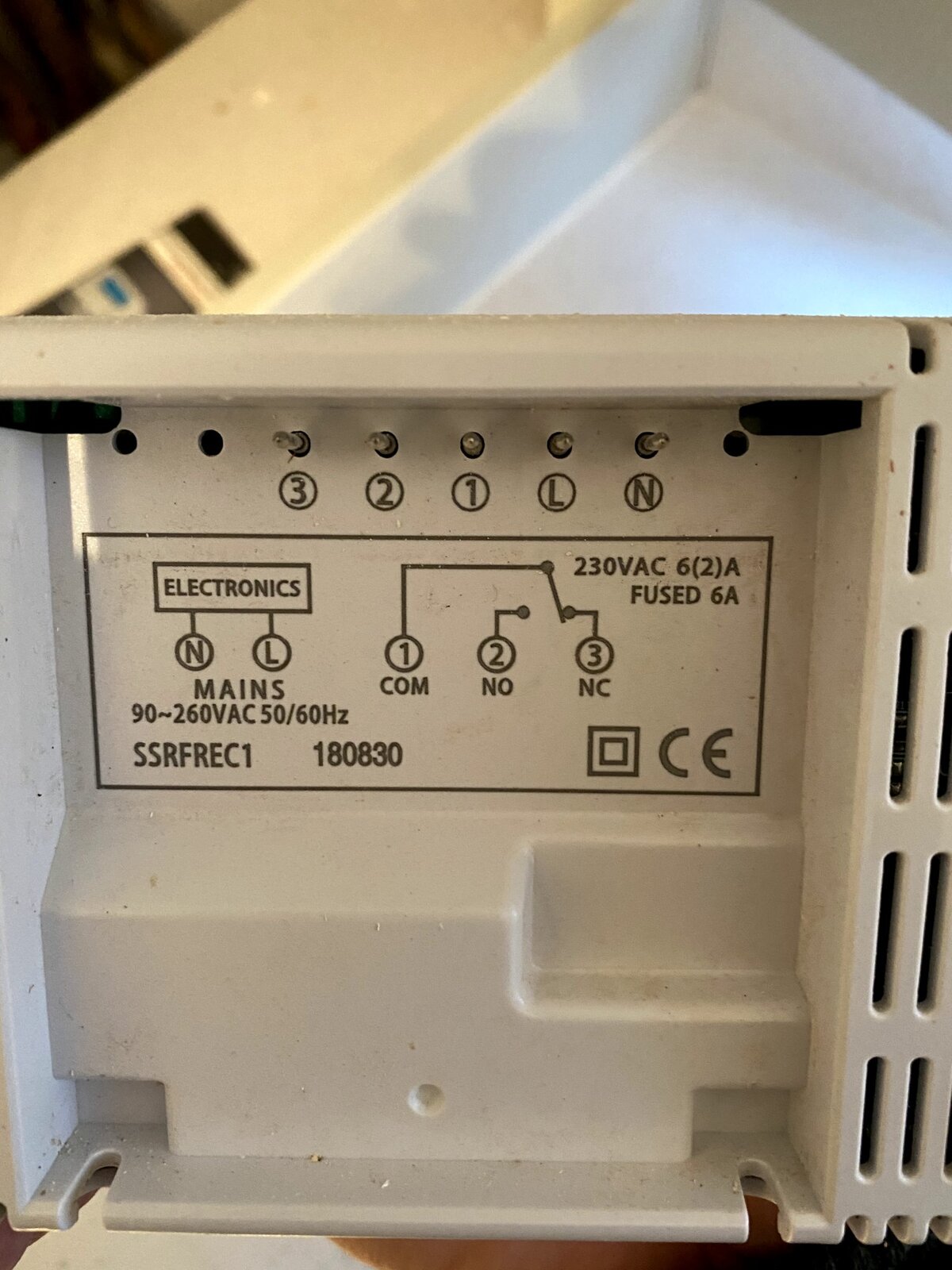

In the attached photos you can see the wiring and wiring diagram of the receiver I am looking to replace with my Nest Thermostat E Heatlink.
My question is around the Common connection. As you can see I have a jumper from L to COM. Am I correct to believe that I should use L (brown wire) as the wire for the COM connection on the Heatlink, alongside the green/yellow for the NO? I would then cap off the N as this is not required.

The terminals are marked the same on both devices. So:
The brown wire is the Live and goes to Nest-e terminal 'C' [COM]
The green / yellow wire is the Switched Live and goes to Nest-e terminal 'NO'
It's bad practice to use green/yellow wire for a live connection, as a minimum it should have a brown sleeve over it to indicate this.
No other connections at the Nest-e are required. The blue neutral wire should be insulated / isolated safely and tucked out of the way.
Thank you for confirming. I did think that about the wire colours. Will do as you suggest and use a sleeve.
