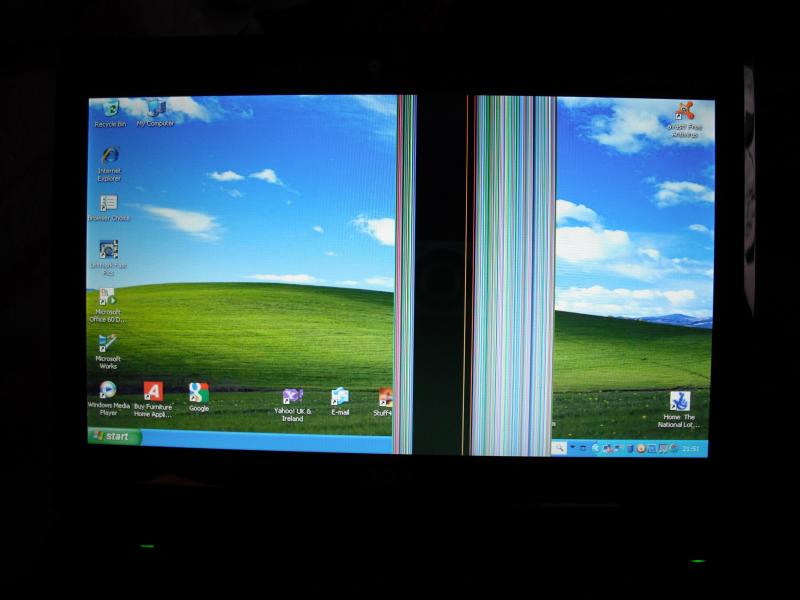

my netbook as packed up now...was getting this screen view when starting up, then the vertical lines would go after a minute or so.. and then you wouldn't see them for perhaps another week or so...but now it won't boot up.so i am assuming that was a signal for the graphics begining to pack up.the problem is i think you've got to change the full motherboard, and they are about hundred quid..i wouldn't mind but it's only 14 months old.
You are probably right and the artifacts are caused by the graphic chip.Looks like a problem with overheating.I do not think replacement of mobo is a reasonable solution in this case, it cost too much.Check the current prices on brand new ones :) .

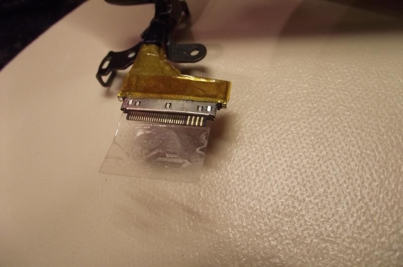

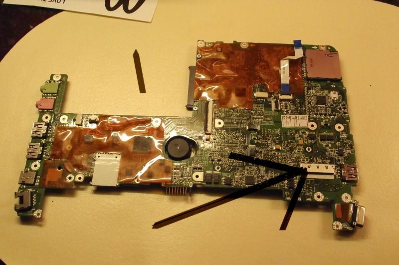

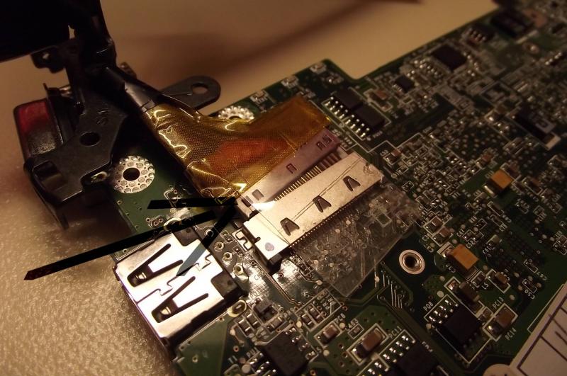

Could easily be a loose cable.
Disassemble it and reseat the video cable (both ends if it disconnects at the display end, too), see if it helps.
the thing is it went in for repair for a keyboard problem 10 months into it's life and i sent a photo with it showing these vertical lines.they fixed the keyboard,But said they could not replicate the problem,which i thought was a bit naff with all the testing eqipment they have...the motherboard is solid state..the model is acer A0531h-obk...i havn't been to their website to see if there as been issues with this model..but certainly will tonight.
Their website's not going to say 'oh, yes, all these laptops have faulty chips'.
Reseat the video cable.
