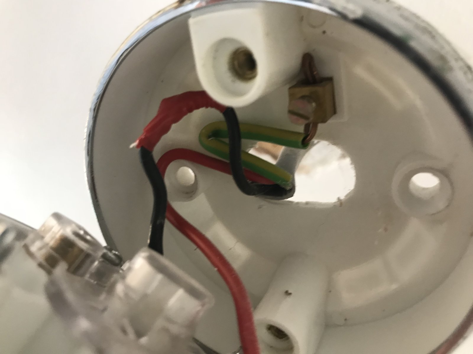

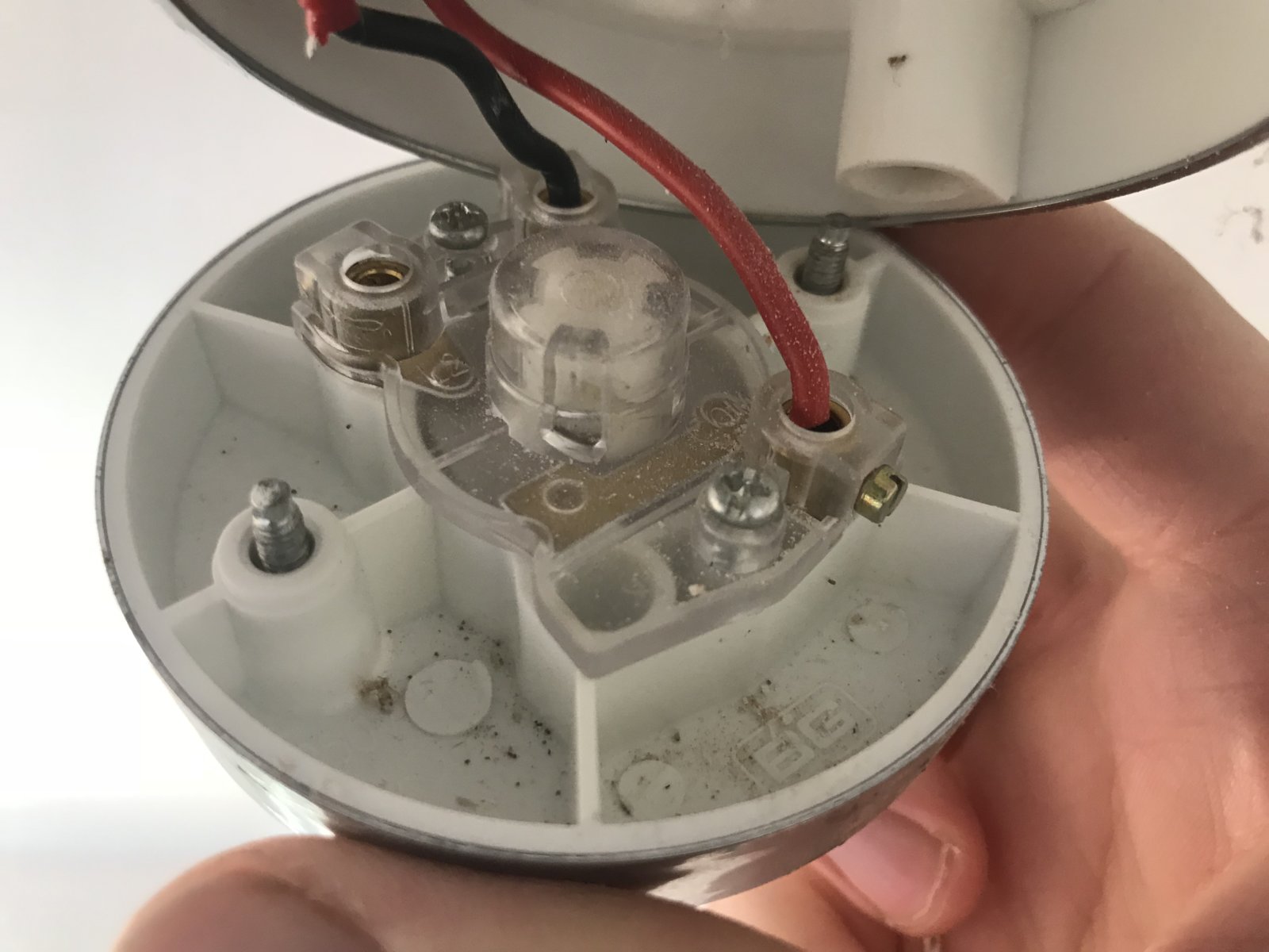

was wondering if anyone can help me
I’m trying to replace an old bathroom light pull
Old one
65BF9E51-30B6-4594-86E7-9A5528150E91.jpeg A6F8E4A3-7FD5-41BD-A65B-9B4B6E1AF2EC.jpeg

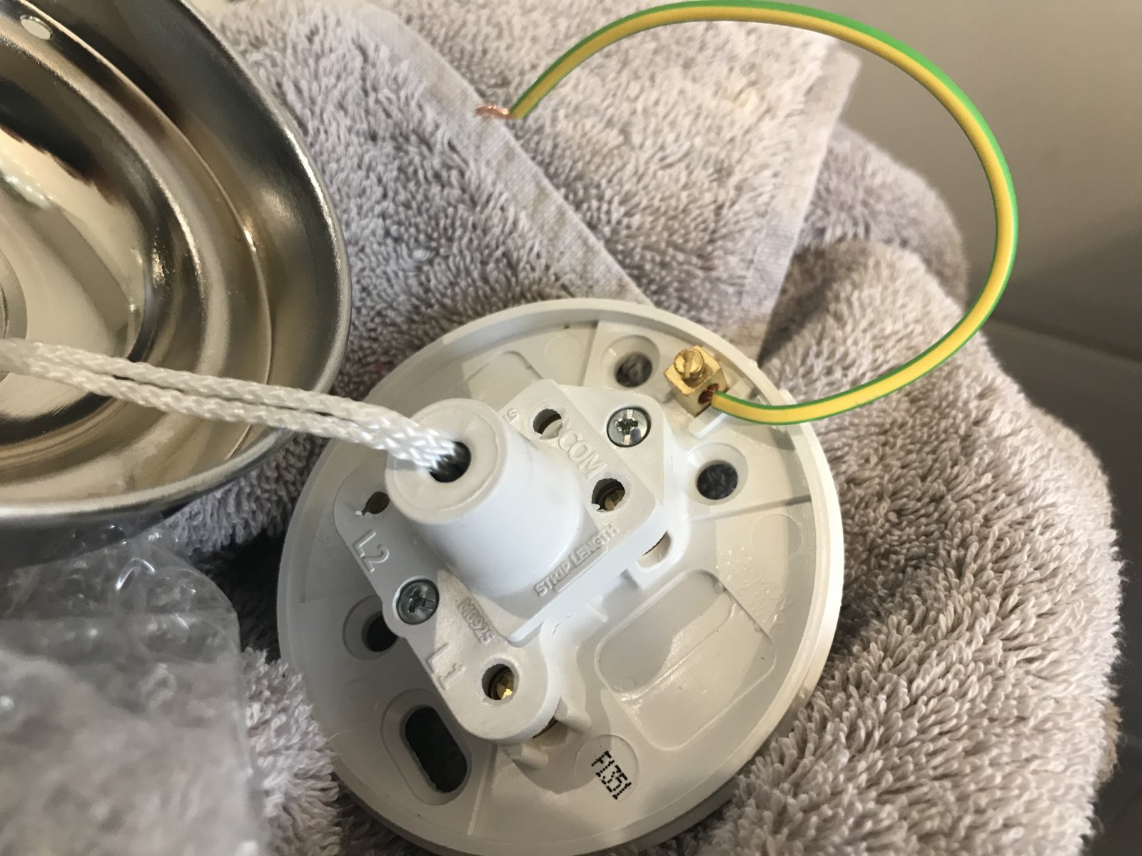

New one
79ACBCE1-7EA8-43D5-B3BE-E179BBE95D88.jpeg 90DD5781-990A-43BC-8717-276BA1C6FCA3.jpeg
The new one has 3 terminals
L1 which the red cable goes into
L2 which the black cable goes into
COM ??

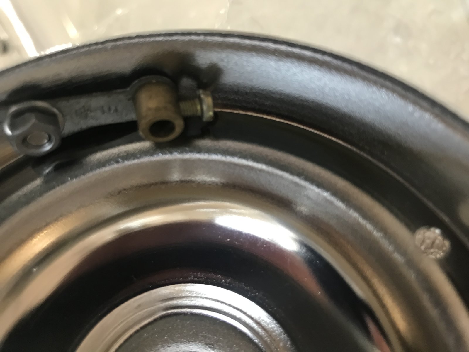

Do I put the earth cable into the metal side in pic 2 of the new one?
Still leaves me with an earth cable on the new one?
Red to COM
Black to L1
Earth wire to earth terminal. You don't need the extra bit of green/yellow if the cable earth reaches.
The wires from the cable
Red to COM
Black to L1
Green/Yellow to Earth terminal on plastic
The piece of green/yellow wire has to connect the Earth terminal on the plastic to the Earth terminal on the metal cover.
Therefor there will be 2 Earth wires in the Earth terminal on the plastic,

We both have told you:
Red to COM
Black to L1
but it doesn't matter which way round they are.
then connect the earth cable that’s in the old one and the earth cable that’s in the new both together into the side of the new one?
You must connect the earth wire from the cable to the metal.
Whether you do this directly or connect both wires to the terminal on the plastic also does not matter.
