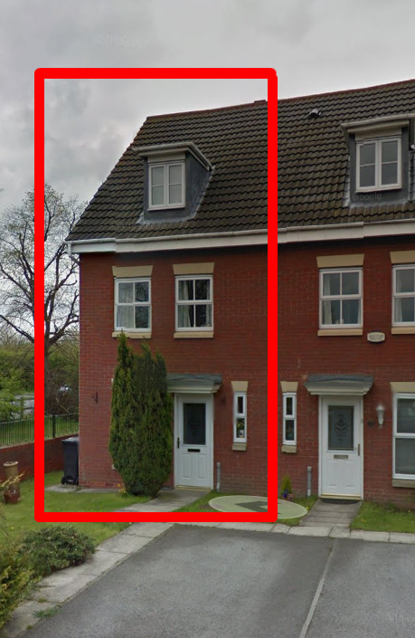

Hi there,
We've been having issues with our boiler for a couple of months now. It keeps needing to be reset, so most days it won't come on until we press the reset button. More recently we're having to reset it or turn it off and on completely 3-4 times before it comes on.
The boiler is 14 years old (it's a Potterton Suprima 40L) so it's possible it'll need replacing, but not sure. I've read that it could be a faulty circuit board: http://www.diynot.com/diy/threads/potterton-suprima-40l-lockout-likely-causes.76759
We also have a Santon Premier Plus PP150B water cylinder (unvented) -- not sure if we have anything in the loft, haven't actually checked since moving in.
So I suppose my question is, should we replace the boiler with it being so old, and if so, what type should we get.
We live in a 3-storey semi-detached house with 3 bedrooms. Main bathroom on first floor with a bath/shower, and an en-suite with shower on the top floor. See attached pic for an idea of the size.
A plumber has recommended an Ideal Logic+ 35kw combi boiler, or an Ideal Logic+ Heat 24 Heat Only boiler if we don't want a combi.
I've tried to do as much research as possible about the pros and cons of comb-boilers, but I still can't decide what'd be best. I've had a combi before, and not being able to use two taps at the same time was a bit of a pain, but hot water on demand was good. If the combi mentioned about would be able to push out enough water then I'd probably go with that, but if not then I'd rather keep the cylinder.
That's another thing, is our cylinder actually worth keeping - buying one new is like £700 I think? Would it make more sense to use it and get a conventional boiler?
Also wondered about System boilers -- not clear on how we have a conventional boiler with an unvented cylinder.
Any help/advice would be much appreciated.

Definately keep the unvented cylinder. You currently have a much better system than a combi system.
With regards to if you should replace your current boiler or get it repaired?
That's completely up to you. Get a few quotes for repair and a few more quotes for replacing it and weigh up the price of repair vs the price and benefits of a new boiler.
At 14 years old it might be worth going with a replacement boiler. But who is to say that if you get it repaired you might get another 10 years out of the current boiler

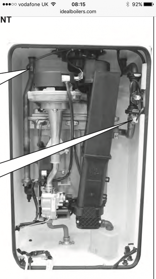

Ideal logic have had leaking main heat exchangers and have plastic parts in them now the earlier version was brass
High tec plastics not much different from brass counterparts. It is the O rings that eventually cause the leaks What is the point of fitting a brass component if it will be replaced instead of repairig it. Obviously brass is easily refurbished whereas plastic can get hairline cracks.
Was at ideal course in Reading to be told failure of plastic parts nearly the same as brass
The heat only
Eh? Heat only doesn't have any parts brass or plastic. It only consists of your so called leaky heat exchanger. :rolleyes:
Look no bits!!!
Yeah right I'd sooner have a plastic part over brass not in my house don't believe ideal they would say that plastic is good cos it's cheap an they use it
What about all those pump bodies that are plastic.
Let's see how long the brass lasts with condensate and acidic flue gases going through ya numpty. ;)

Sometimes folk have polarised views based on what others say. Ideal is a big player that sells stack load of boilers. A small percentage of fails easily becomes a large number. Consider million boiler sales with failure rate of 2% - that is a large number of fails against 10% fails with appliance sales so say 1000 units
This is one of the things I've been saying for a while. We are a victim of our own succes 1.2million boilers with 50,000 failures is nothing.
5000 sales with 500 failures you never hear about as not many people fit them.
Ps these figures are just made up for comparison type thing.

You the one who said no plastic
In it I know the sump has to be plastic but can they be non leaking an non splitting plastic look on cc recent post
Ideal logic here we go again
Do You work for ideal shambolic which is cool if so but hardly unbiased
I would say there boilers are Cool if they paid me wages
You accept these fails but what causes them in your opinion
I am interested not wanting to upset you is it a flaw in manufacture or design prob
I know you may not be able to say on here if you work for them
