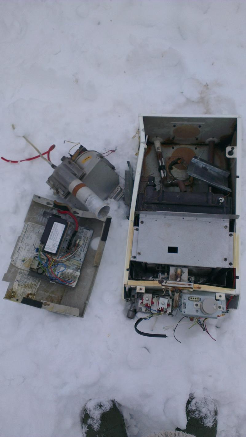

Anyway back to point :LOL: Here is a picture of my old boiler ripped out

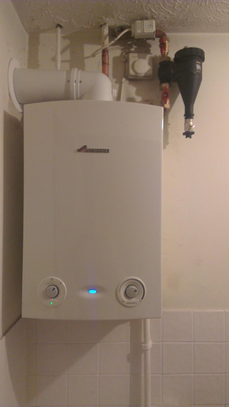

And now nice new boiler in its place.

Nothing wrong with the top of your boiler OP your installer has done a good job at an excellent price the stuff on the top of your boiler is a Frost stat interrupted by a pipe stat and a filter all correctly installed
