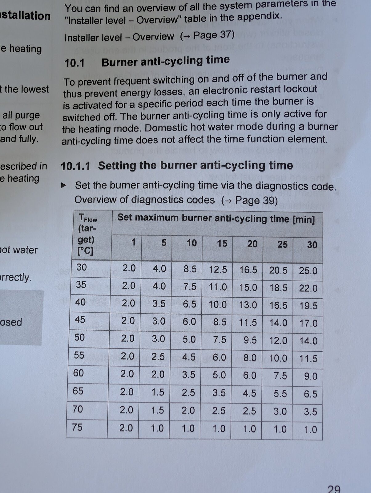

Have a look at the diagnostic "D" codes, Flow/return temps, D40/D41, if the dT between these is greater than ~ 25C then the boiler may ramp down in output, if its cycling on/off then the flow temperature is exceeding its SP by +5C, this can be caused by poor circulation due to sludge in the system or/and, the boiler minimum output is greater than the heat demand.

Perhaps this is the issue? Maybe I just need to turn the boiler anti cycling time right down so it does what the stat wants rather than "thinking" about it?
Don't know how to access the D parameters.
Re anti cycle time, D.02, the default setting is 20 minutes BUT if you look at the anticycle time (Look up) table, you will see that 20 minutes with a boiler target temp of 65C gives a actual anticycle time of 4.5 minutes, if the target temp is 55C then the actual anticycle time is 8 minutes, I would say you certainly require that anticycle time of 4.5 minutes to allow the flow temperature to fall sufficiently to allow the boiler to get away in one go after the burner refires.

Thanks @Johntheo5, well, not really knowing what I'm doing, I hacked my way into the installer menu and knocked the anti cycle time down from 20 mins to the minimum setting of 2 mins I think, and... After a few hours, tbh, it does seem to have solved the problem. Stat is maintaining a steady 21 degrees now, boiler is doing what it's told and coming on when the stat says.
Before it just seemed to be all over the place, stat would be calling for heat but the boiler would be languishing at 40 degrees and definitely seemed to take longer than 4.5 minutes to wake up, often it seemed to just get stuck, maybe stat still trying to switch on and off kept knocking the timer back to the start.
TL;DR seems to be working fine now! Though what you're saying makes sense. Guess I'll just see how it goes from here. Thanks again.
