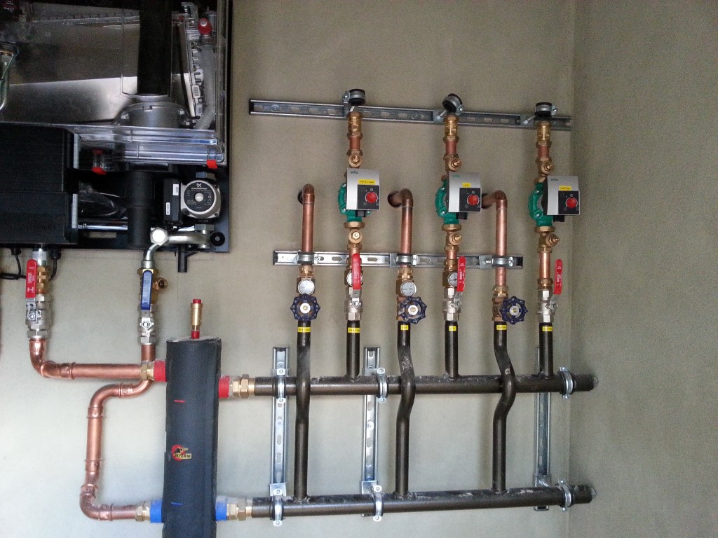

Low Loss Header = a smallish canister that is heated by the boilers, then house and hot water then draws what it needs from this.
This is a single boiler with low loss header that we fitted to house similar in size to you.
Left pump does the hot water.
Middle does the underfloor heating
Right does the rads.
The boiler knows the difference between heating and hot water and changes the way it operates accordingly to maximise efficiency.
This is an Atag boiler BTW.
