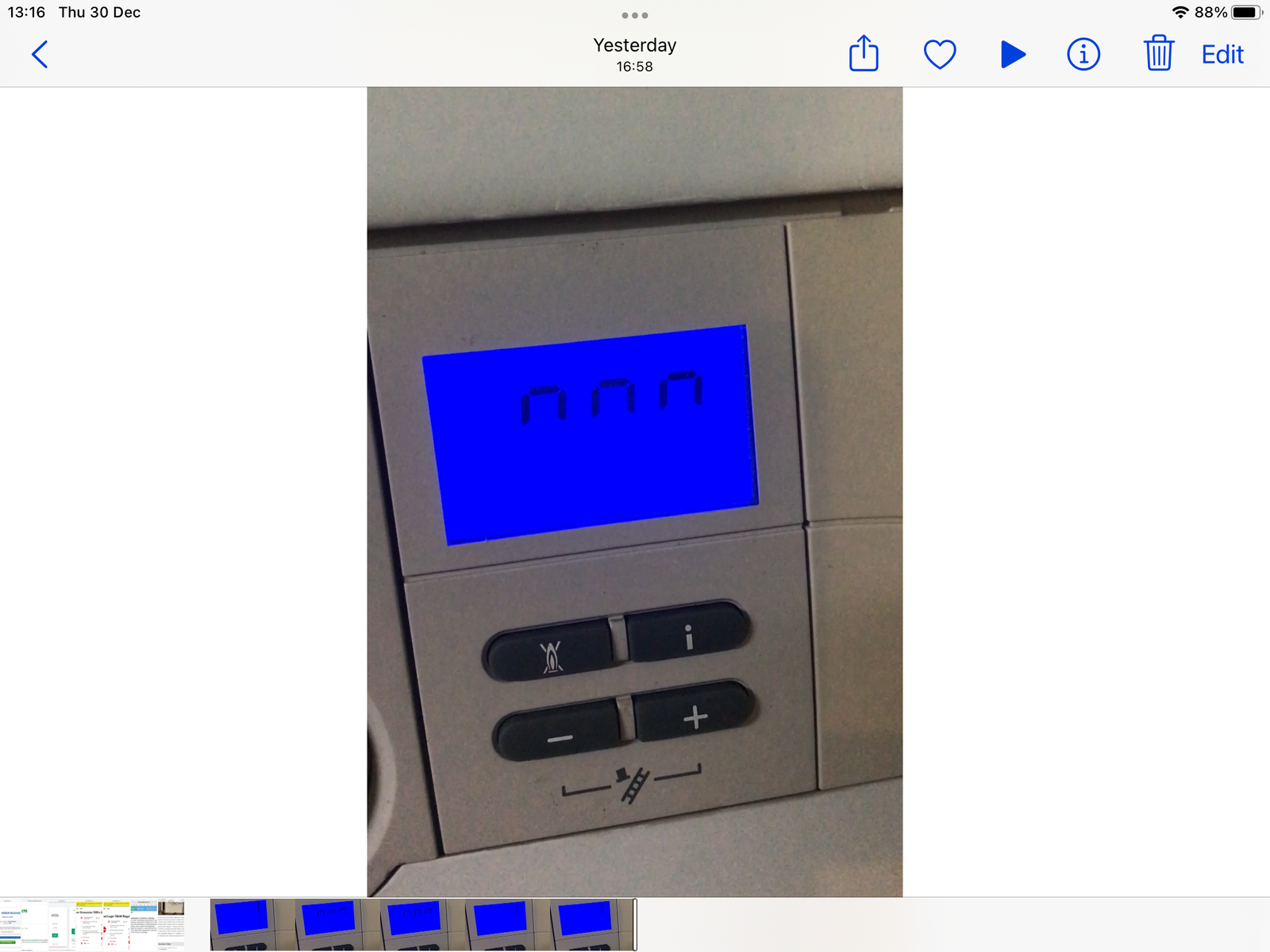

6B5CA6AC-2C7E-4A57-9550-C059742658C0.png Just tried the boiler again, but it shuts down after less than a minute, fault code shows as per image, a
Shows ‘1’ then the half zero’s flashing. No idea what that means, decided to go for a new boiler, so hoped I could get the valiant to run for a while for a bit of warmth. Found the factory reset procedure, but after entering 12 for my boiler, the KW is still at 12KW and fault code history still there, thought these would reset to default / clear. Not trying to do anything fancy, just hoped to reset it and get it to work for a bit.
Any thoughts ? Should all reset to default ?

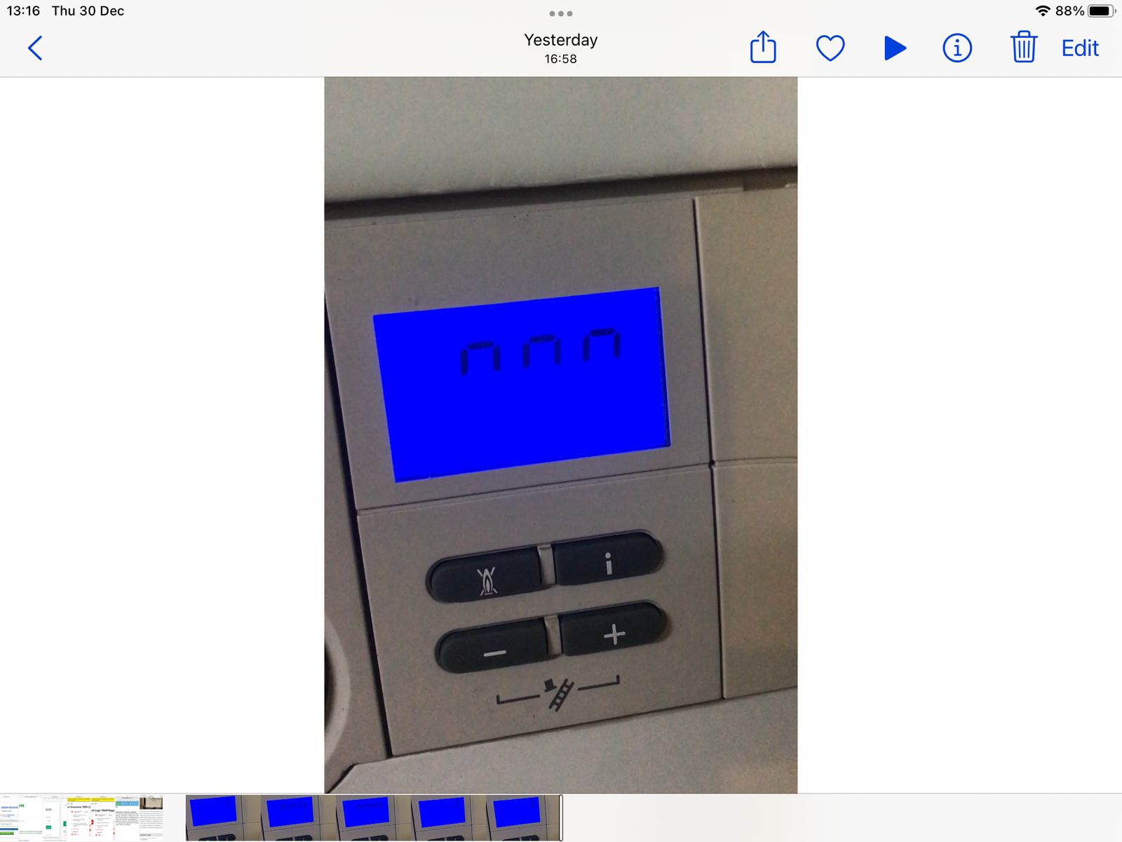

View attachment 255685 Just tried the boiler again, but it shuts down after less than a minute, fault code shows as per image, a
Couldn’t see how to upload a short video
Referring to your earlier post, the problem might not be with the boiler. Doesn't the operating manual tell you what the fault codes mean? If you haven't got it, it should be available online.
It’s not something I’ve seen before on those types of Vaillant displays. The older type displayed that when there were no faults left to display in the history. Perhaps one for @ScottishGasMan or @The831Bunny?
Have managed to do a factory reset now, but it runs for 30-40 seconds then just stops. The fault code is weird, in that it’s showing half Zeroes then 1 flashing, don’t think that is a proper fault code, it’s an ecotec 418 plus
Thanks, in the fault display menu the first one is the most recent I assume
No, I don’t think it’s a proper fault code, hence me tagging in x2 Vaillant expert engineers. It could be an electrical fault.
