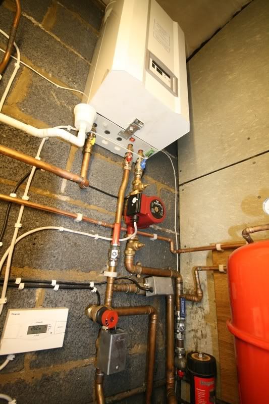

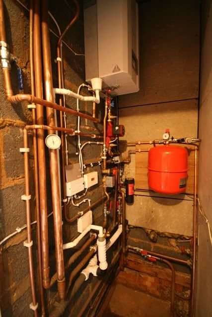

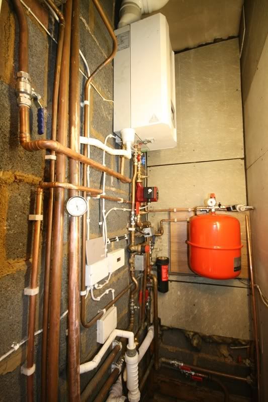

As promised - this is 40kW with a 25 litre expansion vessel and 25-55 pump (for size comparison....
1200 x 450 open vented cylinder in room just above boiler.
Two bathrooms.
House easily matches your square footage - possibly more.
I can't figure out why you guys don't use bending gear. :(
It cuts out a lot of pipe joining. :D
Let's see now, boiler, multiple isolating valves flow and return, and the PRV / safety valve over on top of the expansion vessel. :eek: Or am I missing something?
It's a brave man who posts pictures of his work on this forum.
There's a safety valve in the boiler as well as on the EV. I had a leak on the flow to the heating (soldering a bit too close to an alarm cable in the corner so under did it).
It held until just after the ssytem had been running for half an hour then started to drip.
Due to my prolific use of Bulldogs I isolated, removed, soldered refited and reinstated the whole lot without even turning off the boiler that chugged happily on for hot water.
The old chimney was used as a concentric flue system.
Oh, and I think you'll find there's an offest on the flow :eek: I didn't do it though ;).
Why the HepVo trap on the condensate? I thought the traps in the boiler were considered sufficient?
Perhaps the white 'flowerpot' under the left of the boiler is the air break so needs another trap on the waste. I've used these as well in certain situations.

Dan get back there and put the required number of pipe clips on immediately!
Wot about the flue, you were going to tell us, or something?
Because the drains would smell. There is a PRV in the boiler, as mentioned above. Inside that tundish are two pipe tails. One for the condensate (a loop of 20mm tubing) and the other for the PRV.
There's plenty of clips, trust me I was pulling myself up from my seat in the cupboard for the last 4 days... The flue didn't get a picture, but inamgine a normal concentric pipe that runs in the bottom of the chimney stack. The internal pipe carries on and goes into the elbow of some 80mm plastic liner. This runs up the chimney to the pot where it goes into a normal vertical flue teminal. the bottom of the chimney stack is sealed with the outer part of the concentric pipe poking in a few inches and supported above the bottom to act as a catchment space.
The seal is removable for cleaning. All a bit tricky to show in photos.
