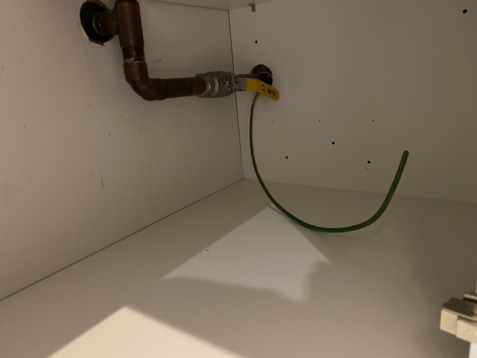

Hello everyone.
Just slowly in the process of moving into a new build from Charles Church (yeah I know), and apart from the comedy snags like taps wired up back to front, dishwasher waste not hooked up etc I just noticed these two issues under the worktops.
Not being in anyway electrically competent I can’t be sure this is off, but feels like it is.
Can someone who knows regs etc comment on what I need to throw at the developers to sort this stuff out.
Under the worktop earth cable just hanging out, and power for washing machine chilling out under the water inlet/waste.
Is this something that really shouldn't happen, or just acceptable but sloppy? I am due to have a stern conversation with site/customer services on Monday, so be handy to know the issues I am raising other than rubbish workmanship.

Water supply in a new build is probably plastic pipe, if that is the main stop tap, so bonding (not earth) cable probably is not required but can't tell from the internet. It needs testing.
Socket needs fixing somewhere so is not finished. Nothing wrong being in a cupboard with water pipes.

Stupid question, so yellow handle is water pipe rather than gas?
What would be the thinking behind leaving a cable just loose like that? Should it be terminated somehow?

Oh, I just assumed it was water related to the other picture/question.
As it is gas it is more likely that the bonding cable needs connecting to the pipe but not definite.
There if required, I presume.
As above.
The other end should be at the Main Earthing Terminal - a block near the meter or in the consumer unit.

Sorry, I should have been clearer. That's the pipework underneath the combi-boiler/hob. I'll gently remind the developers to connect things/tidy things up.
It's an apartment, so will have to pop outside tomorrow when it's light to have a look, but it looks like it is.
No need - if that is where the gas pipe enters your flat, then the bonding cable must be connected to the pipe.
This is, of course, assuming it is a bonding cable which goes to the Main Earthing Terminal.

What does your Electrical Installation Certificate say about gas and water bonding? If you don't have one, make sure you get a copy from the builder.
