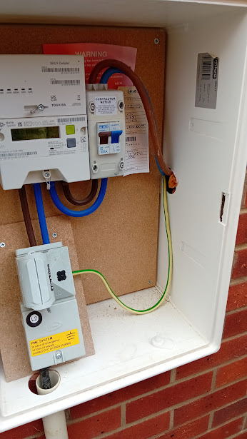

Today a tripping problem in a new build property purchased 8 days ago, I measured ~100KΩ L-E.
It turned out to be rain getting into an outdoor FCU feeding the garage, non sealed back entry T&E from the kitchen socket ring.

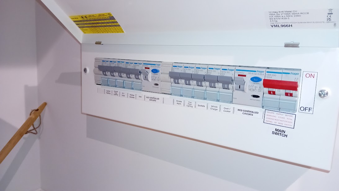

The CU:
Note how PV & EV charge point switched off due to not yet fitted despite being part of the property spec.
& meter box
The Neighbour (moved in December 2023) had the same problem (of tripping when it rained), hopefully the liberal quantities of clear silicon sealant added to both FCUs by one of the site staff has sorted the issue.

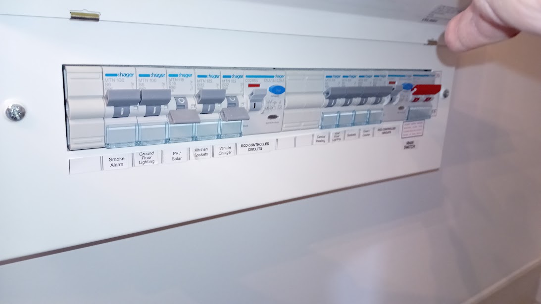

Neighbours CU:
I thought not allowed to use same RCD for charge point as rest of house? Not sure about solar, but where is the SPD? rather surprised a new build with MCB's would have expected to see all RCBO's today. It this just a temporary board, my problem today is 6 mA DC is very little, with all RCBO's should there be DC it will only affect one circuit, so not that much of a problem, with MCB's and only 2 RCD's how does one ensure DC or high frequency from LED lighting, induction hobs, washing machines, freezers etc does not stop the RCD tripping with faults from other circuits? Am I missing something?
Also with solar how do you ensure the solar supply does not cause overload? I know my DNO supply is only 60 amp, so even with solar it will not exceed the 100 amp total the consumer unit can handle, it seems to be a 17th edition install?
You're absolutely correct - it must be a dedicated RCD for each EVSE.
That’s just a very crappy design and install - from what we can see. Wonder what’s concealed?

I simply can't see how a new built can comply with that consumer unit.
