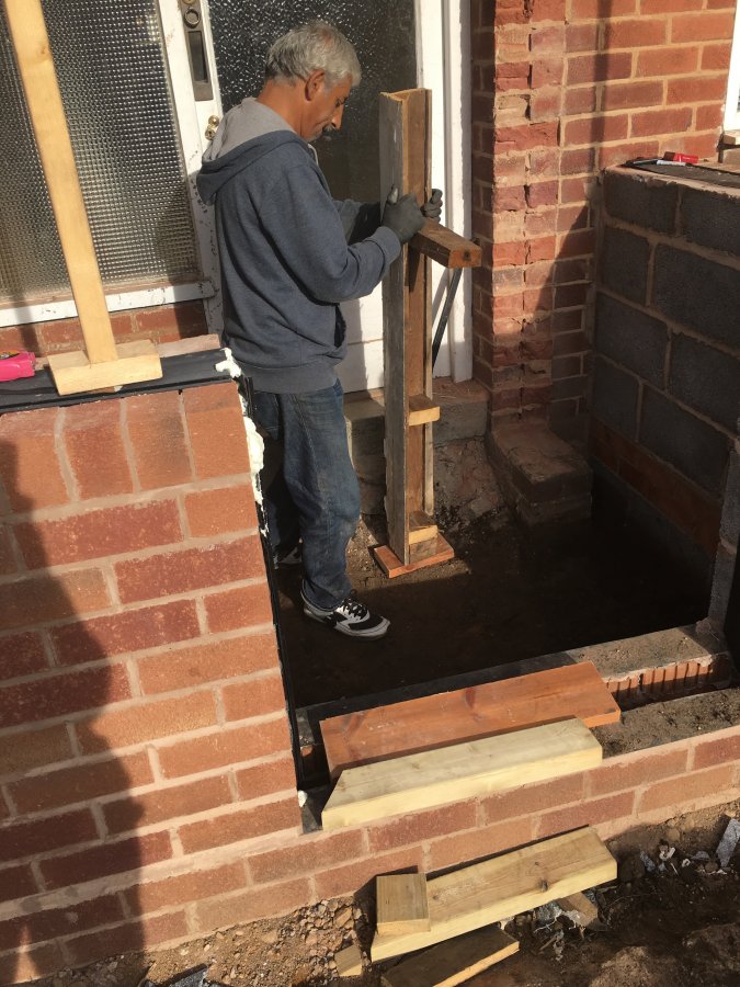

We are bringing floor level to lever of bottom of door opening. I was told by the window fitter the door will be on the outside skin. Do I then fill base of door cavity with concrete? How is this void typically filled

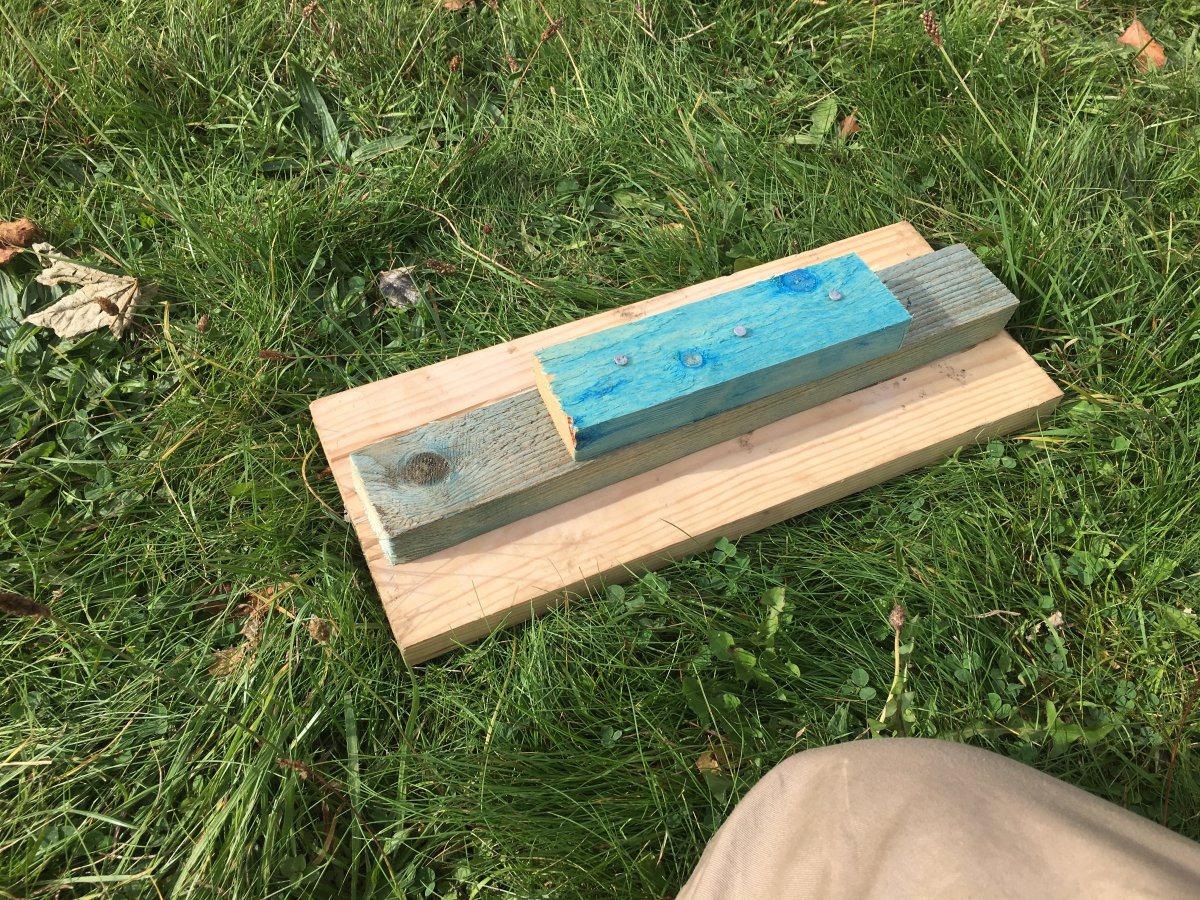

Ok live coverage coming up. We are waiting for the mot type 1 to get delivered. However I have made a wooden float(and a Romanian to go with it) as suggested and a compacted from skip waste
With a float finished concrete (single pour) slab, all opening details, below DPC, need to be done in advance. You need to remove a couple of courses of masonry and allow the conc, membrane, insulation etc to go up to the door threshold. Finish the jambs by returning the masonry according to the size of the opening.
Lol. Our hardcore got delivered at 1pm so we got delayed. We finished concrete get at 4. I went back at 8 to trowel it and it was still wet. Having said that a decent finish! Even though I didn't get to do the semi dry metal trowel trick. Thanks for your help all
