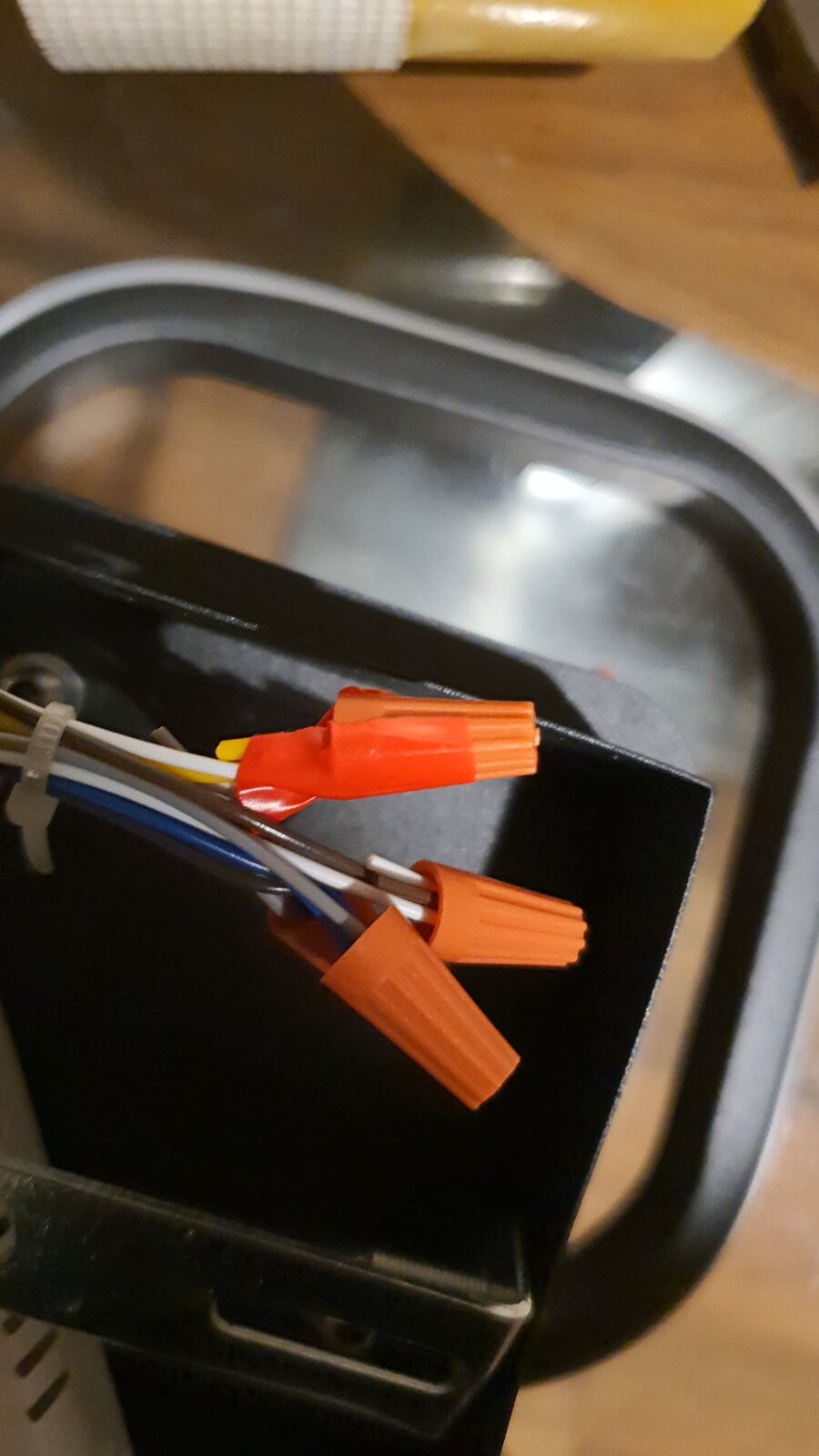

Hello,

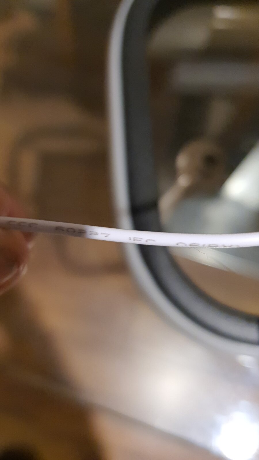

Bought a new ceiling light off ebay. Unpacked it to find both wires to connect to circuit are white. Both wires have same writing printed on them.
How do I tell which to connect to live & neutral?
There are multiple coloured wires coming out the other end of the transformer but they came pre-connected to each other as per pictures.

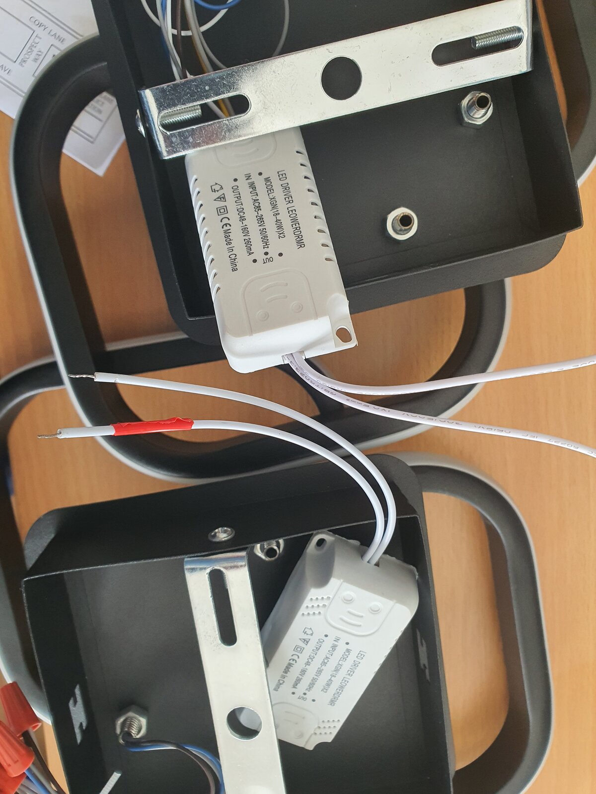

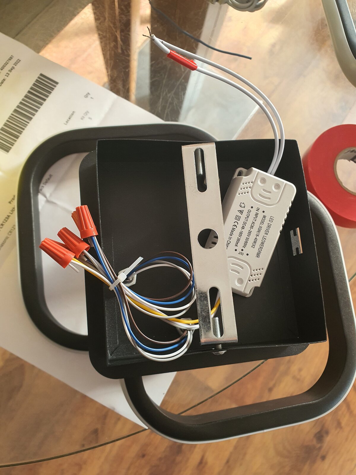

Looks like the cover is wrong way round

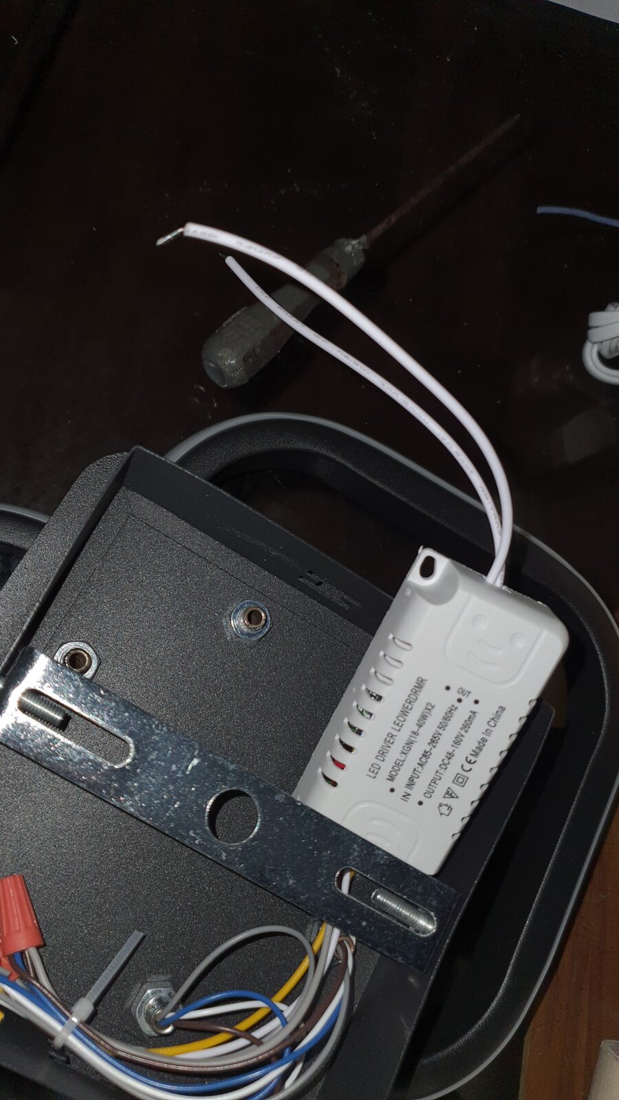

You're right it is. Checked both and other is correct x2 white wires show IN. See pic
Still unsure whether i can connect either white wire to my mains live & neutral feed

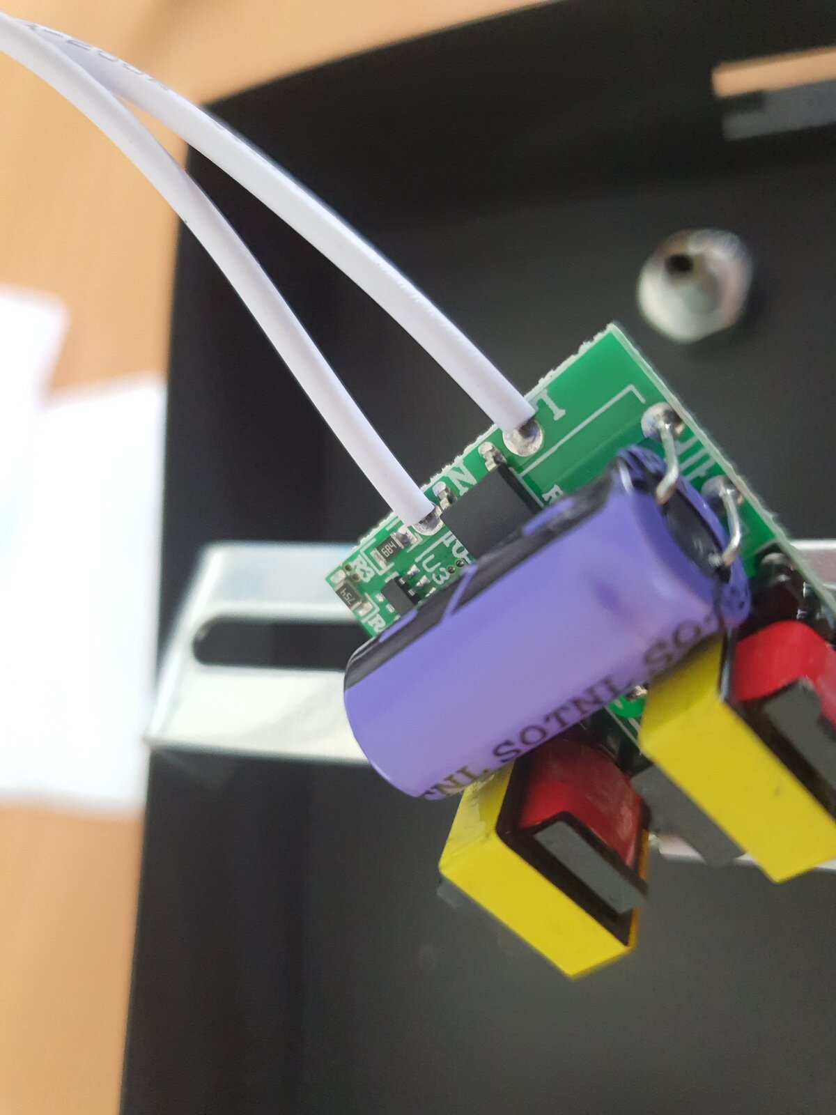

The first image- the LED driver says "out" (leading towards the incoming supply), the final image says "in" at the same point.
Remove the cover and see what identification ,such as L &N ,are on the terminal block that the 2 white wires are connected to ,if any !
