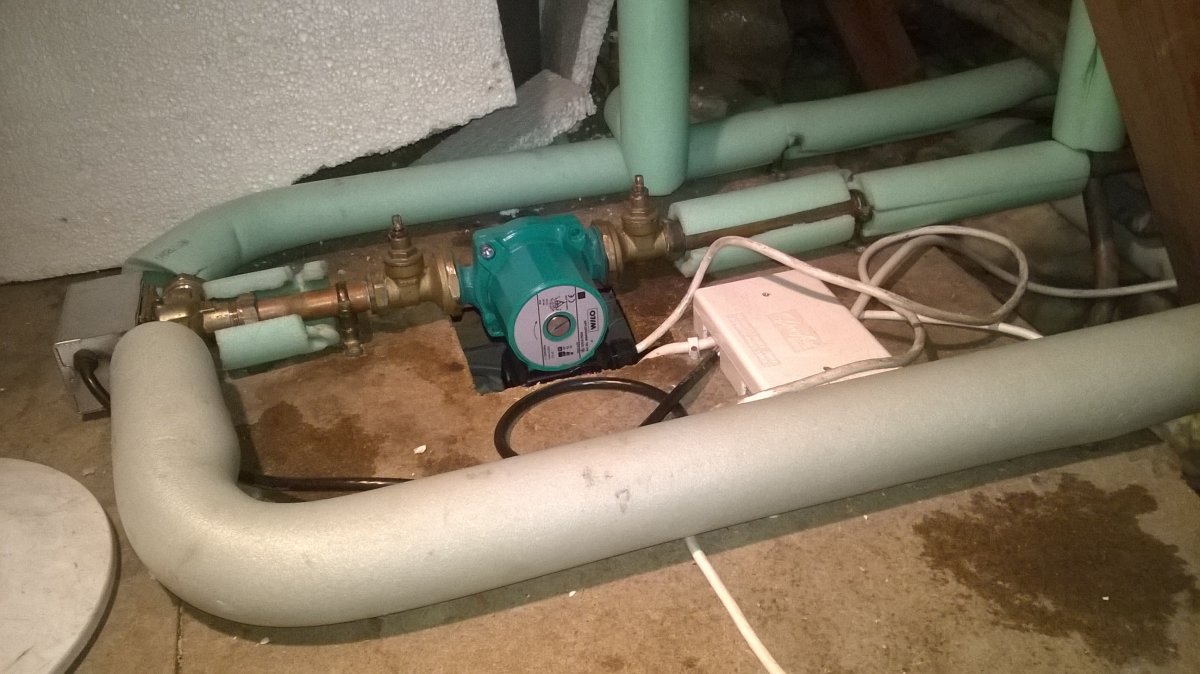

Hi
I was trying to help my 82 year old father inlaw, he was told by a plumper he needed a new pump fitting, but he wanted quite a lot of money so to help him I bought a brand new Will gold pump off EBay that matched what he had already.
I turned off the values either side of the old pump took the old pump out and fitted and wired the new one, turned on the water side value and bled the air out using screw on side, then opened the other value.
After I finished and turned power back on the pipes would make a very load banging noise every 10 to 20 minutes !! The pipes either side of pump were hot but radiator were cold !
Tired to put old pump back on but the water in gate values would not close property!
Power was on boiler was on I turned up thermostat but just the odd banging of pipe's and no radiators.
He lives in a bungalow and pump was in the loft.
Would air in the system cause this ?
Any help would be good
Have you checked that the pump impeller is turning?
How far past the pump is the pipework getting hot?

Took screw out the top of the pump and make sure impeller was running OK with a screw driver.
Pipe was quite hot both sides of pump for as far as I could feel.

The shaft on pump valves can snap so you turn it but the valve will still be stuck in the off or almost off position, i would be checking this first, and with the £625 you saved a tenner on a new pair of valves is a bargin.

You haven't answered the question "how far".
It is important.
Is the body of the pump hotter than the pipes?
Sorry did say in post 6. Pump was same heat as pipes and pipes were hot both side of pump as far as I could feel / reach.

I was in the loft and it was all a bit tight but pipe going to header tank felt hot all the way then other pipes went in ceiling (floor of loft) seemed hot near pump but a bit cooler as they disappeared about a meter away from pump.
Do you think it's a fault with pump or is air causing problems , I was going to drain system in the morning change the 2gate valves and refill and try again.
So one of the pipes was hot for about a metre, and one of the pipes was hot for some other distance. You don't want to say what that distance was?
BTW the pump usually has two 22mm pipes going into it, and neither of them go to the header tank, though there might be another, usually smaller, pipe that does.

I'm quite sure a pipe went to header tank but will check in the morning . the water in pipe went to the pump which was 22 mm will gold R's 50 pump and pipe out went to a 3port valve which T d the pipe and the they split into other pipes going all over.
