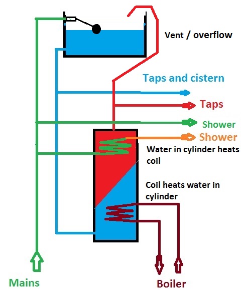

There are alternatives but most RGIs do not like anything out of the normal.
This provides mains pressure showers without the need for G3 qualified plumbers to install and maintain it. The cylinder is a heat store for the shower as well as the hot water supply to taps in bath and basin where mains pressure can be too much pressure.
A 6 kW boiler can take 20 minutes to heat the cylinder and then the shower can extract 30 kW from the cylinder for a 4 minute shower. ( These times and values will vary depending on size of cylinder and the boiler output )
It is not a sludge bucket ( as some heat stores are ) because the water in the cylinder is not the water circulating around the radiators and hence does not have chemicals and products of corroding radiators in it. That dirty water ( shown dark brown ) is confined to the lower coil in the cylinder.
