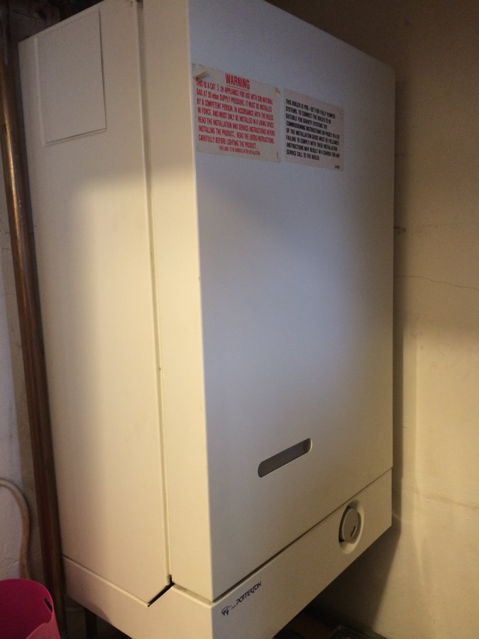

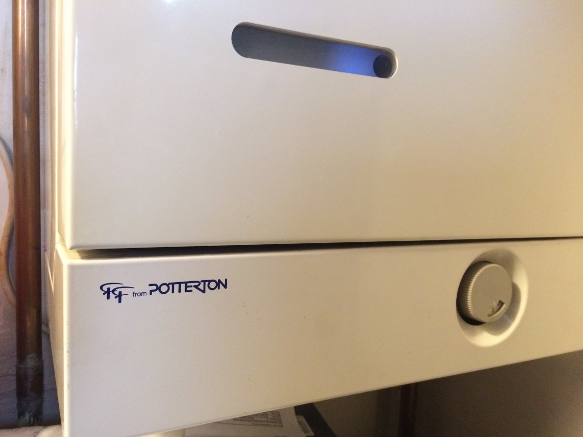

To be fair I'm not sure where I got the 50 from I miust have read it somewhere. It says on it ff from potterton
Just had the pcb replaced on it a few months ago but feels like I'm on borrowed time with it.
Don't know mate but have got paperwork from its install in 2000. I know some units can last donkeys years but in my head after 15 years you're on bonus time. Hence the worry about doing "the job" whatever that turns out to be and realising I've got a nice shiny cylinder and a knackered heat source. At least with a combo I've got a new heat source! As I say it's not the spending money, it's the wasting!

Sorry dan what I meant was 50 say unvented 50 say combi
But then when I ask about how flow rate now would perform with uv when with 22mm upgrade no one answers. And when I see videos (were they yours?) about an unvented if you don't then add an accumulater, the performance is absolutely terrible!
I'd love 30l/min and 4 bar - I'd have an unvented cylinder in already.
But I haven't got it and all opinion is it's a system that is unbeatable - if you've got the pressure and flow I don't have
Never debated the quality of the system but for a poor flow like mine it seems useless. You can have the keys to a Ferrari but if it's not got petrol you ain't going too far are you?
