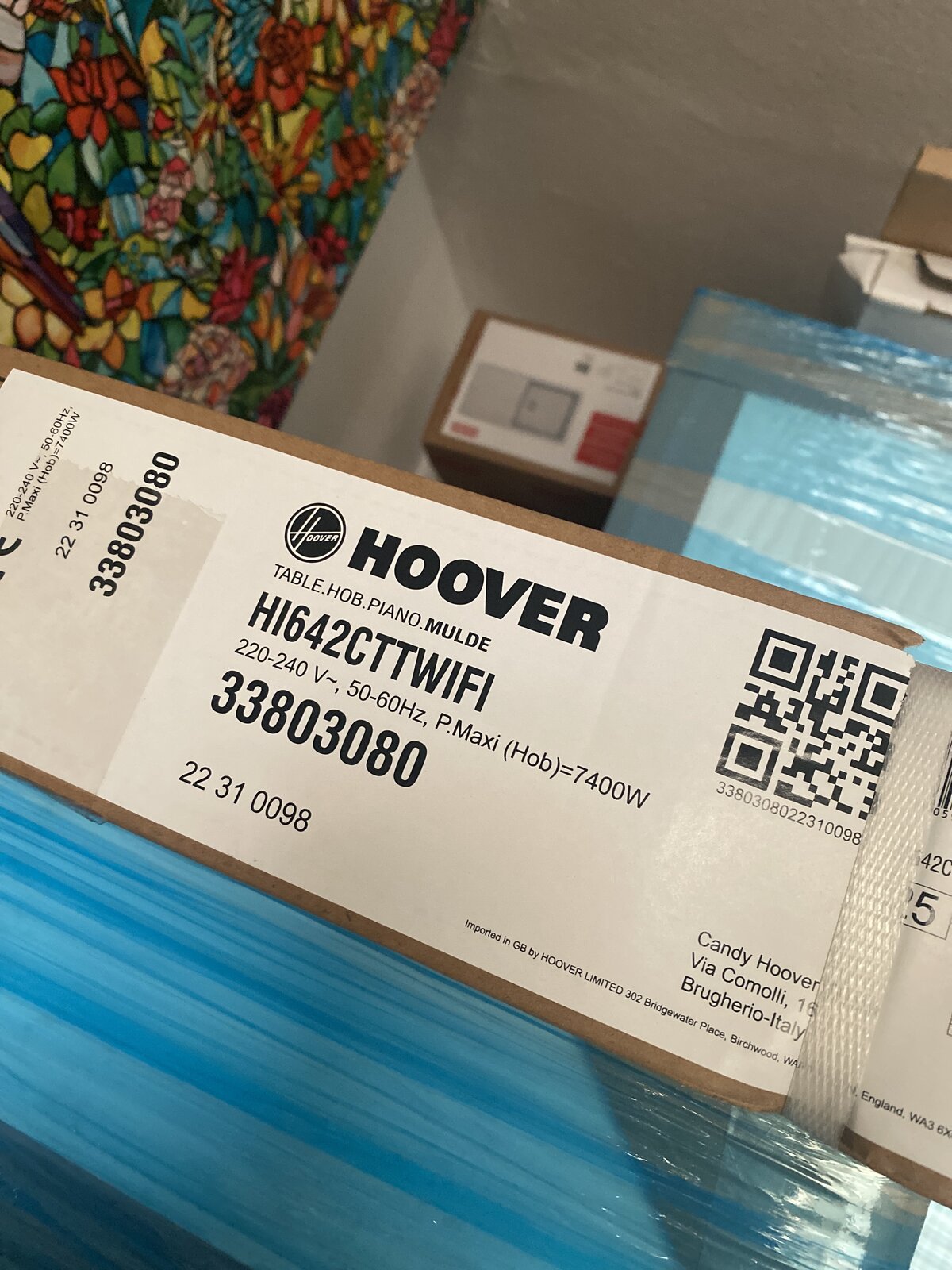

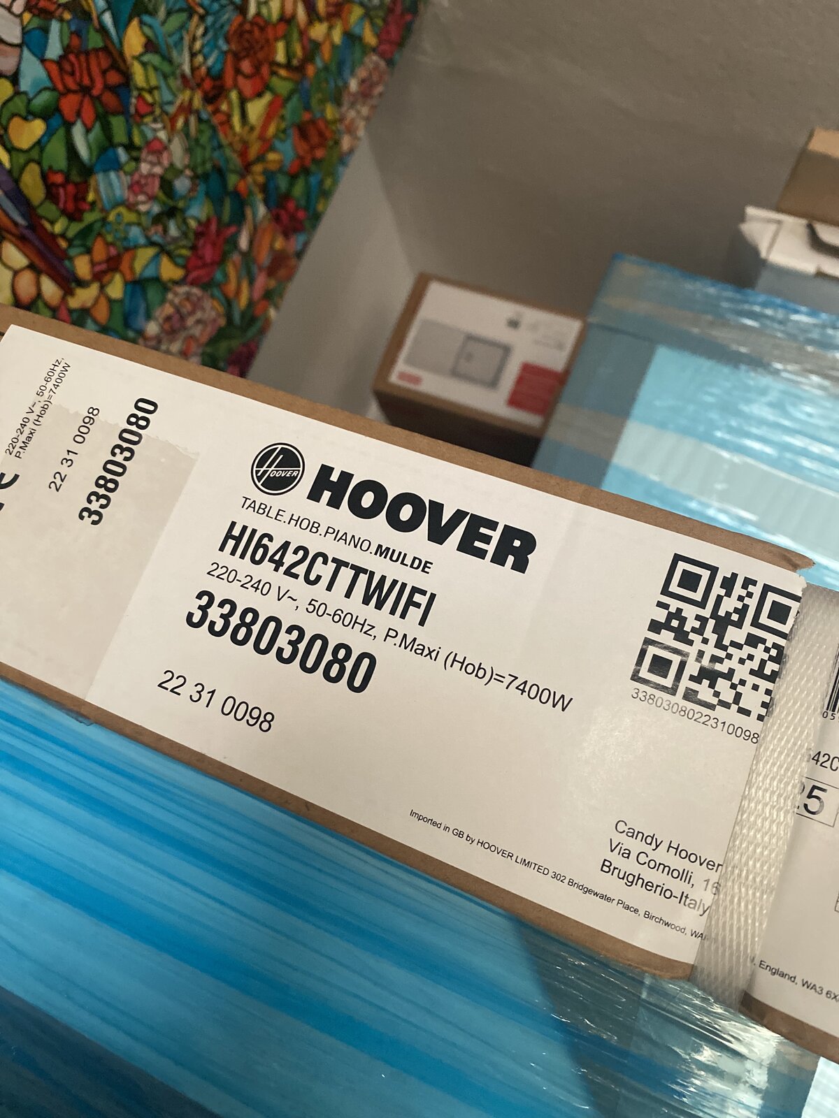

What is the KW rating of the hob?

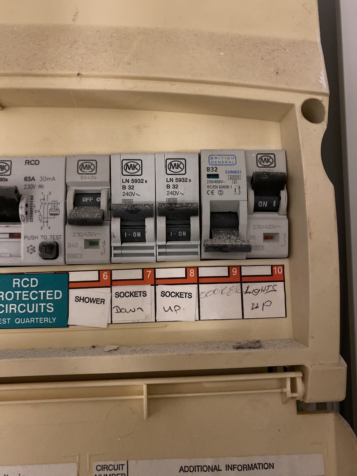

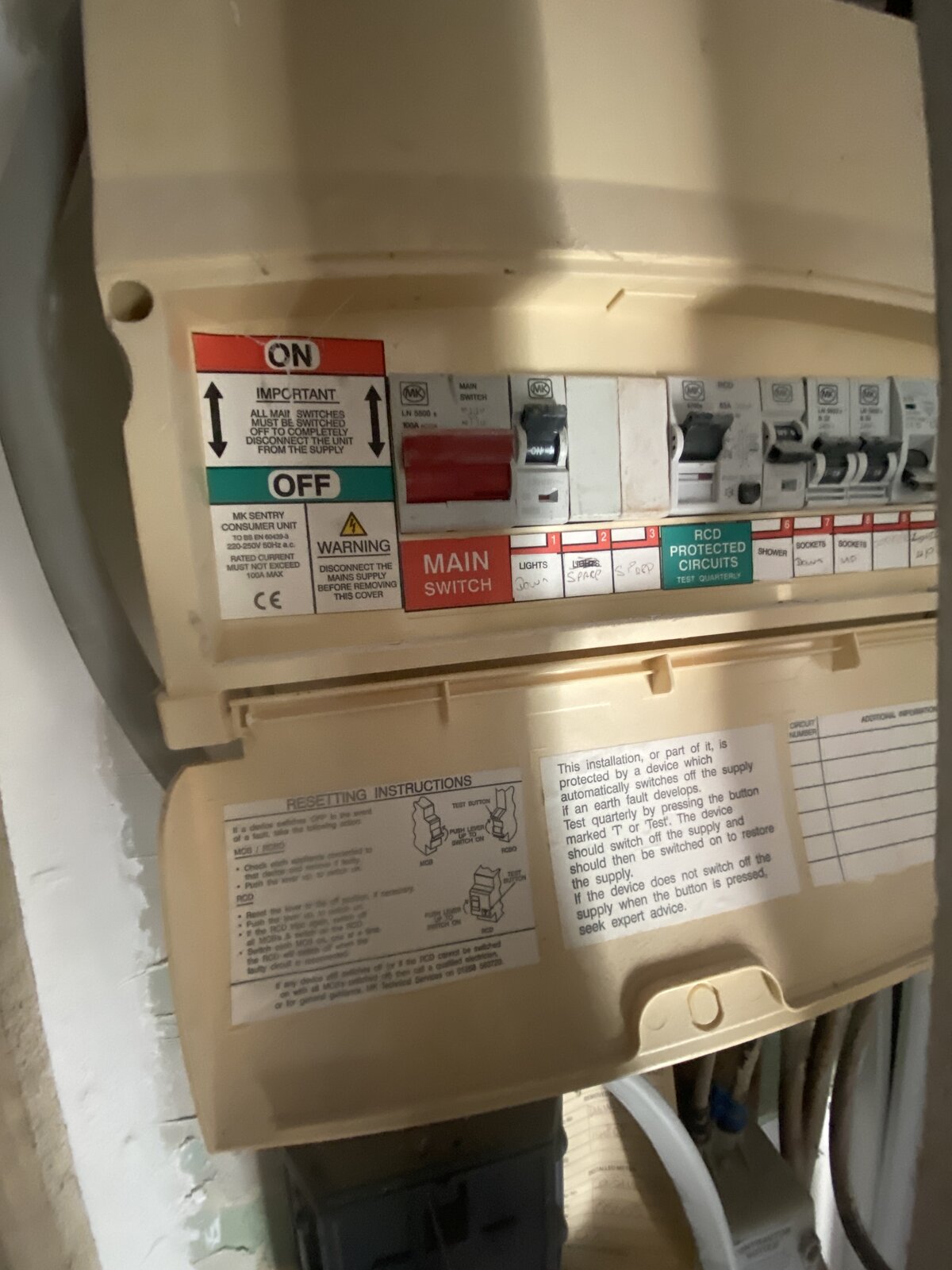

I’ve attached photos of the ‘fuse box’ and the hob.
Hope this answers your questions.

Your hob is 7.4kW, so a 10mm² cable with a suitable MCB will be able to handle the load.
You dont have a fuse box. You have a consumer unit.
I can see two spare positions in the photo but they are not RCD-protected slots, so you cannot use either of those, unless an RCBO is installed..
It looks like the other ways are RCD-protected so maybe you have a spare position that your electrician can utilise. You'll have to ask him/her.
I am concerned that (except for the downstairs light) all circuits are relying on one RCD, this is a bad situation as an earth fault on any circuit will cut the supply to the whole house. Again, your electrician may be able to re-configure the consumer unit.
It is, however, no longer compliant as it is not made of a fire-resistant material. MK is not longer making consumer units although parts are still available through another maker.

Would one of these slots work?
I will have the electrician asses if the unit can be reconfigured as you suggest. Thanks!
One of those would be suitable.
