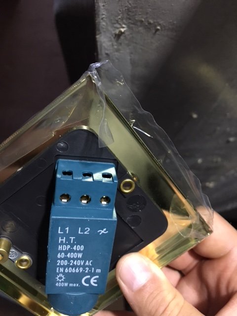

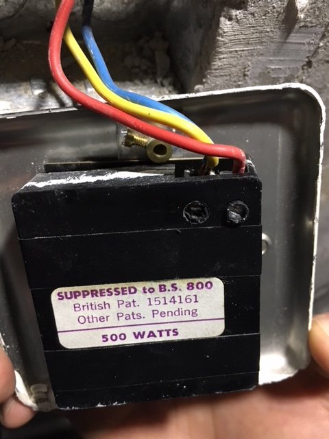

Hi ,
I moved into our new home and shortly after the dimmer switch in the living room broke. I thought at first ist should be an easy switch. But it’s now more confusing than ever. The old dimmer ( metal face ) has three wires red , yellow and blue . Two wires blue &yellow going into one port and the red one in the other. There is no earth wire in the socket .
Could it be possible that the earth wire is with the blue wire in one of the ports ?
I will attach two pictures so you can see what I am talking about.
Old dimmer :
New dimmer :
Could you please help to figure out which wire goes where?
Thank you so much for your help.
Cheers
The new homeowner.

The Earth should have been in the empty terminal connected to the metal.

In the UK its common for that cable to be used in a 2 way circuit, with the yellow and blue known as the STRAPPER cables, is it possible there may have been a second switch.
Its possible the previous owner wanted dimmer and not 2 way, so as the easiest option joined the 2 strappers together. therefore the Red is the live input
There could be other options
The yellow and blue could be 2 switch line outputs serving 2 seperate lights at sometime, therefore the Red is the live input
Lastly
The yellow and blue could be a supply in and a supply out, with the Red as the switch line output, but id say extremely unlikely.
In the UK Metal switches must be Earthed using the terminal attached to the metal, this is green and yellow cable or sleeved usually, its likely already in the wall box and will need a short link to the faceplate.
As for your new switch its a 2 way switch but can be used in your case as 1 way,
The instructions will show the 3 terminals L1 and L2 and The squiggly line symbol is the Variable Output

So put the red wire into the squiggly terminal and the blue and yellow both into L1. If it turns on max at initial rotation move both blue and yellow to L2. In other words wire it as the old one was.
Managed to fix the dimmer switch. I found the earth wire and the red wire had to go into the squiggly line port the blue one into L1 and the yellow one has to been capped.

I can tell that there hasn’t been a Big Bang. Everything is working fine . The dimmer plate is earthed .
The red wire is in the right port and the blue wire is in the L1 port .
The yellow one is not in use and was capped .
Met one of our neighbors in the street who is an electrician and he came around and checked it. All good .
