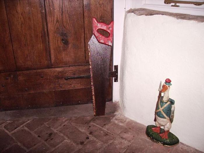

We have a big old Sandvik hand brick saw, no longer made now, and we saw the bed joint out 150mm long and slide the new poly damp in.

Stu. Ours is bit bigger than yours. Had it close on 50 years. Been re-toothed twice, needs doing again. Wish we could buy another one. Bet the price would be 200 quid now.
