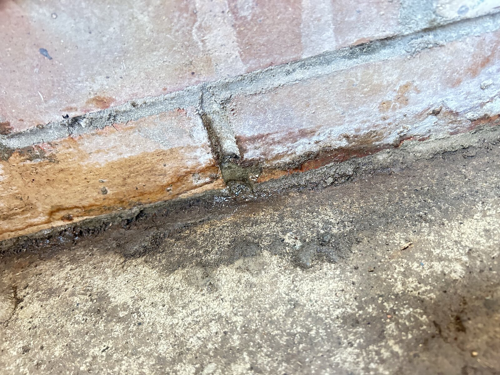

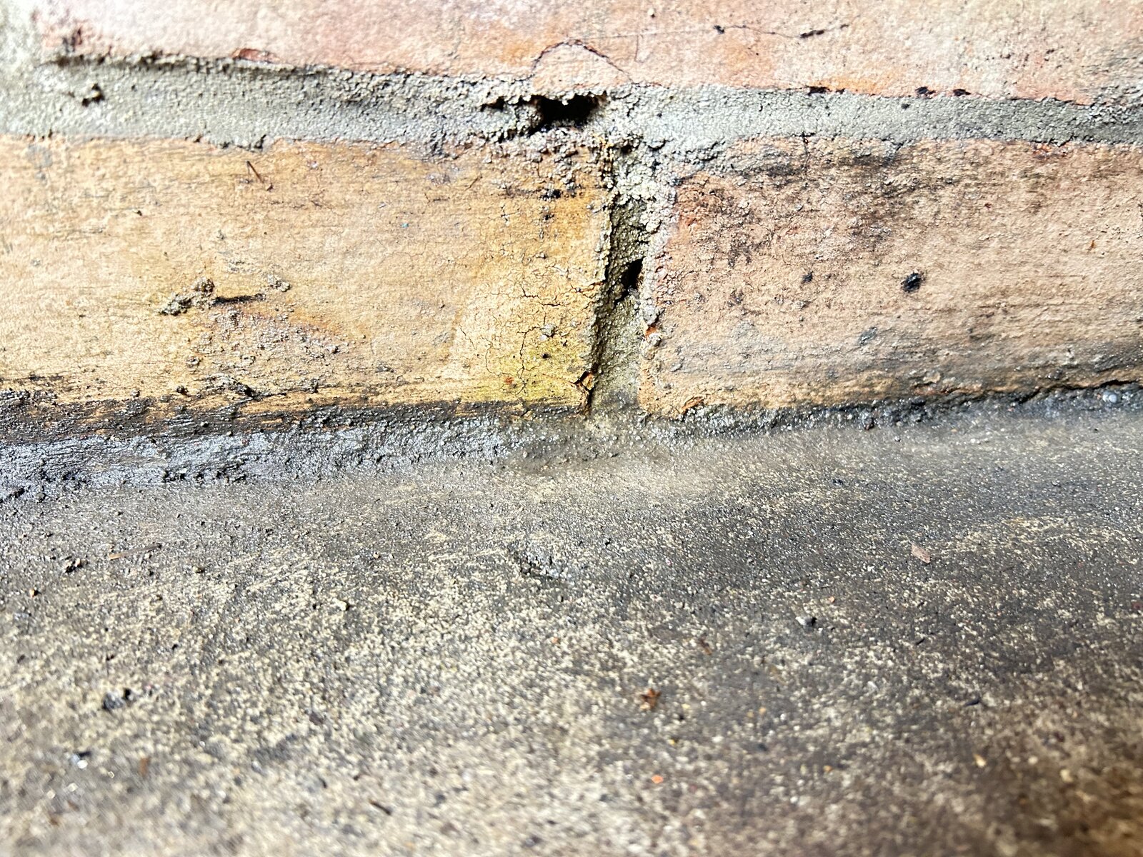

Hi All,
Running out of ideas, money and patience so can someone offer some advice on a water logged garage.
Water is leaking in at the base, where the wall meets the slab. I have dug around the rear and left of the garage to give what I hoped was sufficient additional drainage but I have no access to the right side where my neighbour has a fence against the garage wall. I can see that the soil height between the wall and fence is above the ground level of the garage but can not get in to excavate.
The old owner clearly tried to apply tanking material to the first two courses of brick work but this has cracked and fallen off over last two years. Not sure if this was a good idea or not.
I have thought about extra guttering to try and reduce the amount of water but figured this would not give the permanent solution I am looking for.
My other thought was to lay a DPM material either plastic or painted and raise the floor height with fresh screed or concrete. Would this raised height and additional DPM prevent water getting in at the base level? or would tanking again prove a better option?
Money is getting tight so any advice to prevent me wasting any more would be appreciated.

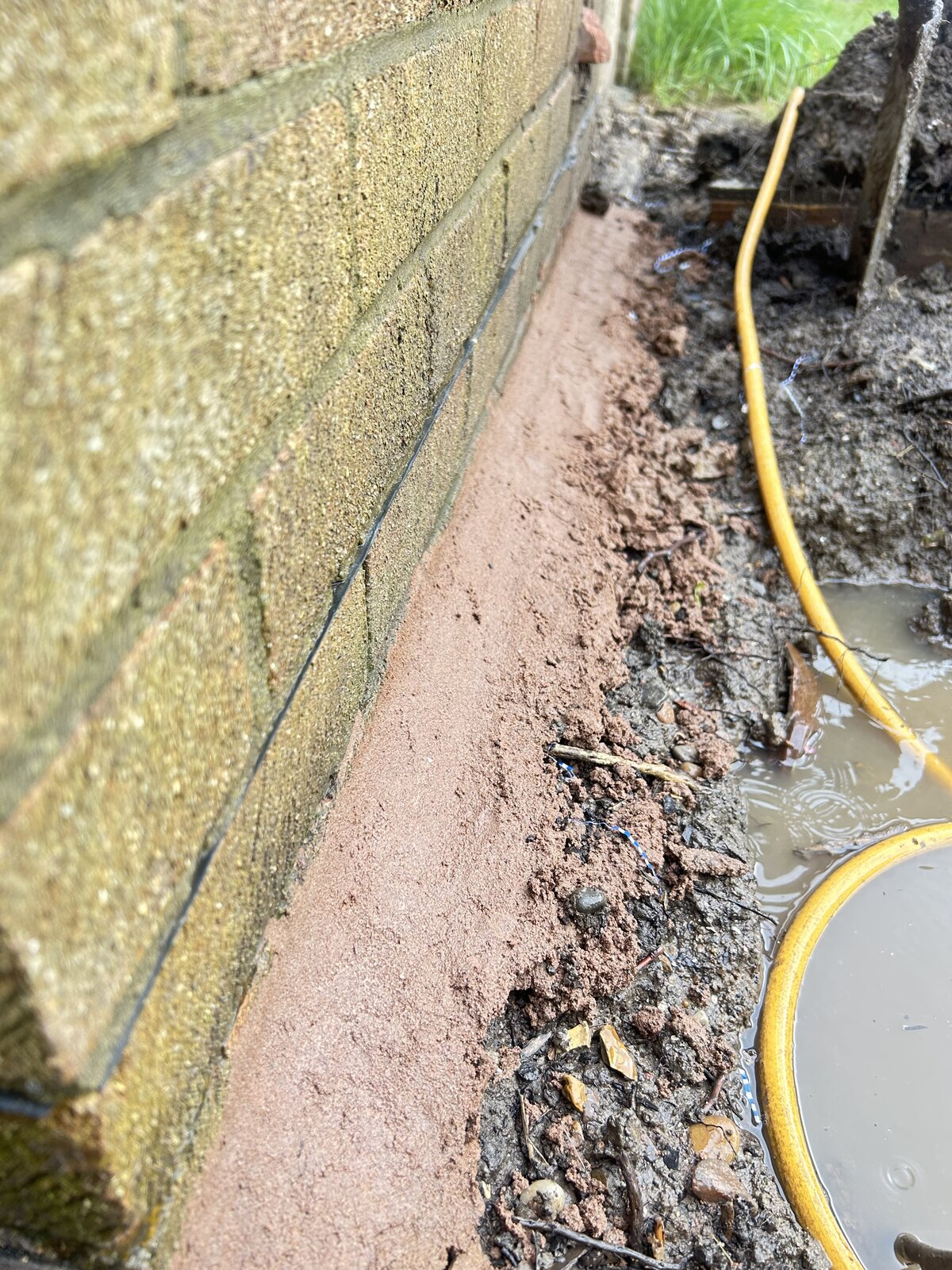

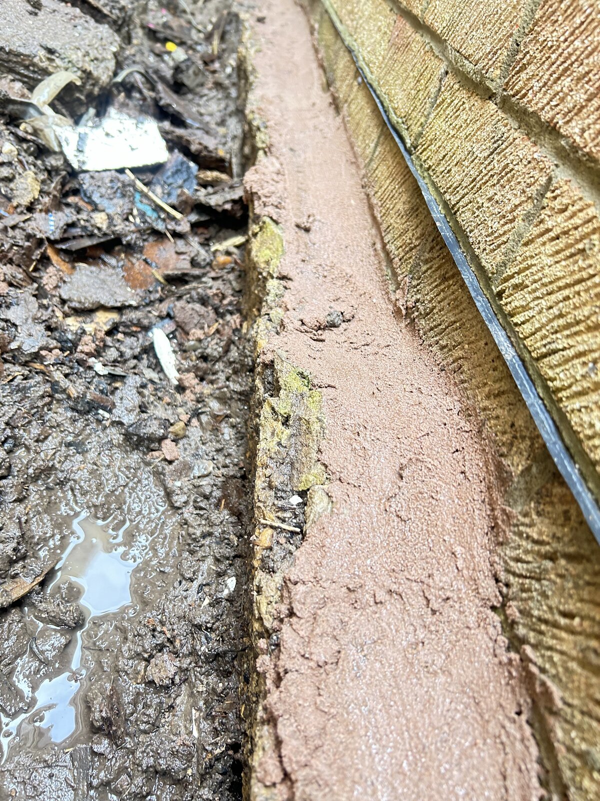

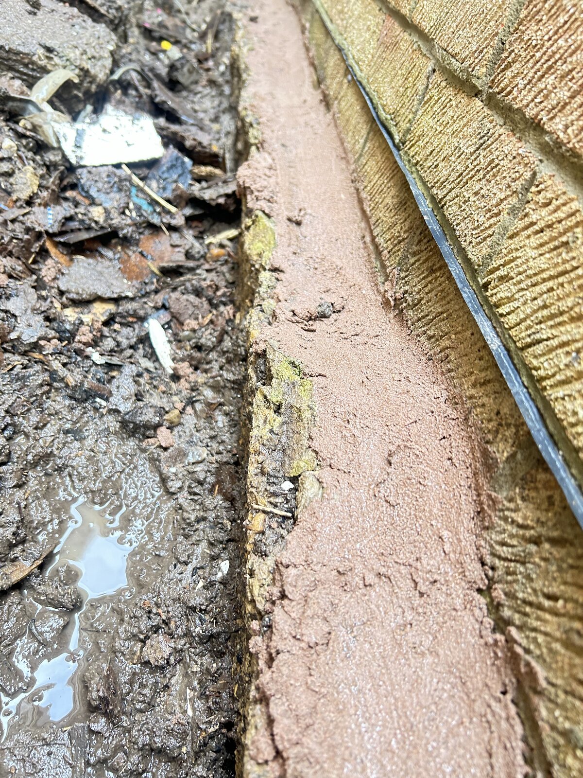

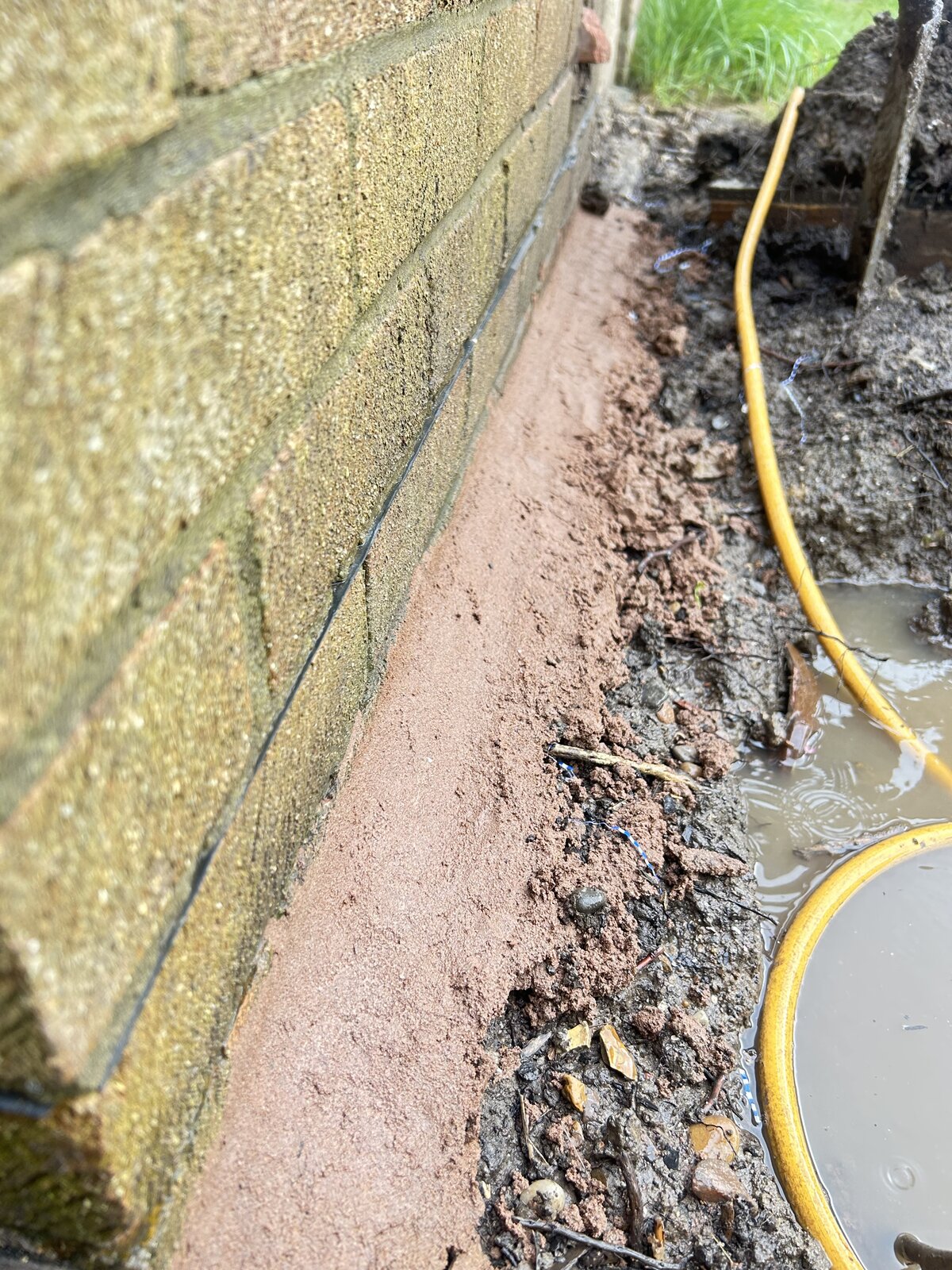

Have tried to waterproof the slab/wall joint at the back that I have access to by digging a ditch and filling with large rocks/pebbels. I then put a mortar wedge along the base of the wall to try and deflect water into the ditch, this was then treated with Thompsons waterproofer.

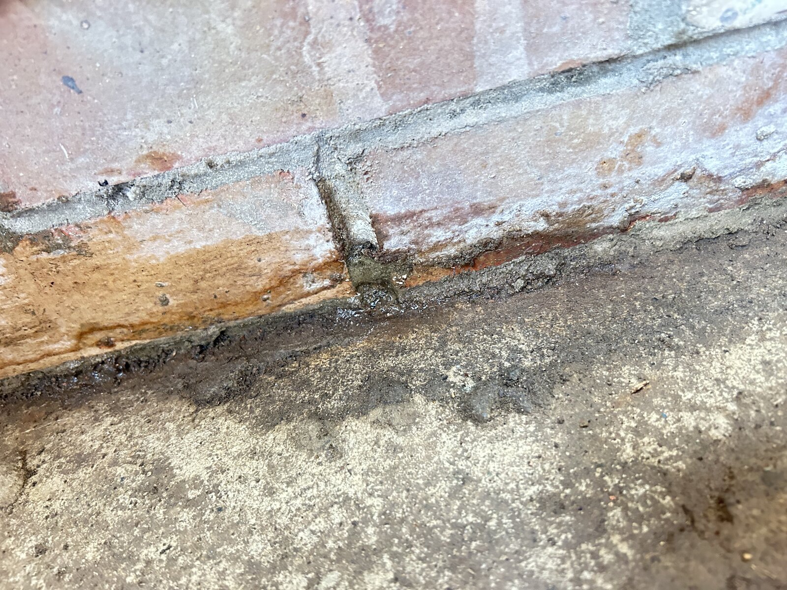

Had a rare dry day so I put the hose pipe on the walls after drying surface water from inside the garage.
Checked 5 minutes later and could see water seeping through...
Any idea what I am doing wrong? would I be better just demolishing and building the bloody thing again. Never don't brick work but it couldn't be any worse than it is now.
View attachment 340126View attachment 340125

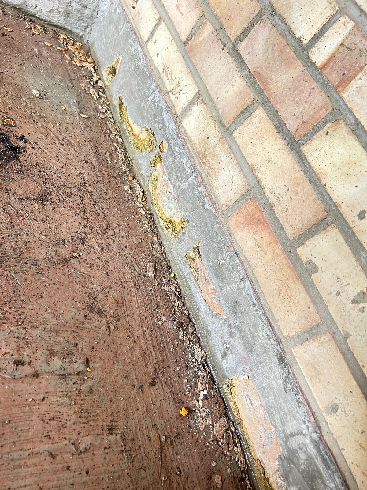

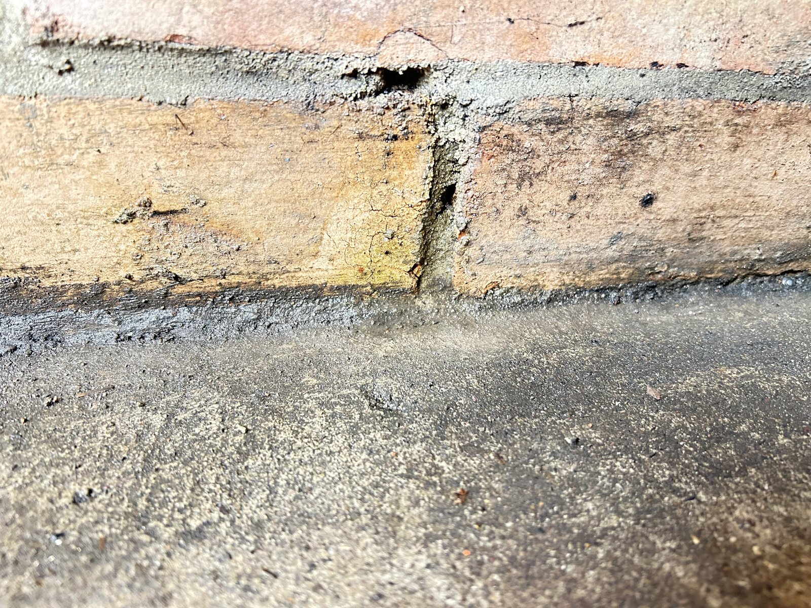

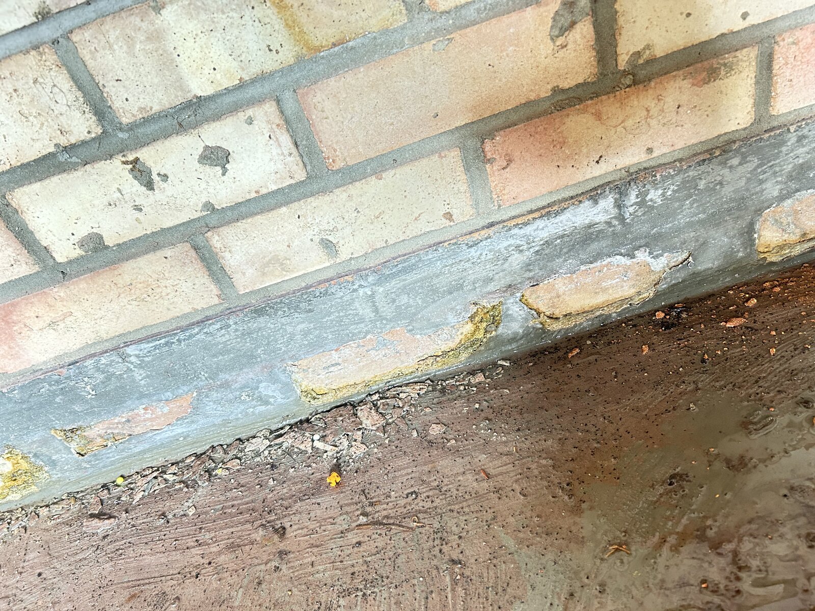

View attachment 340127View attachment 340128
The detailing is all wrong at ground level. Looks like it was done on a budget and with little thought.
You might be able to remedy it with a plinth wall on a proper foundation and with more suitable bricks.
