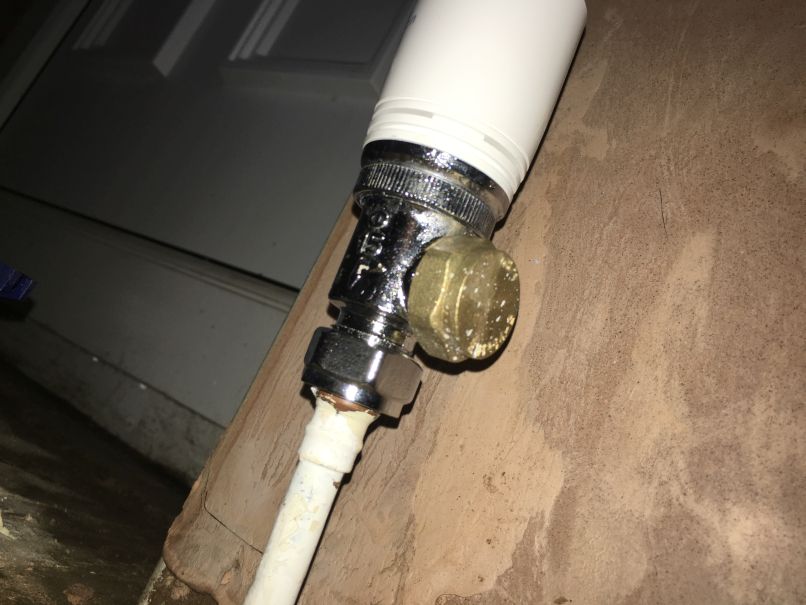

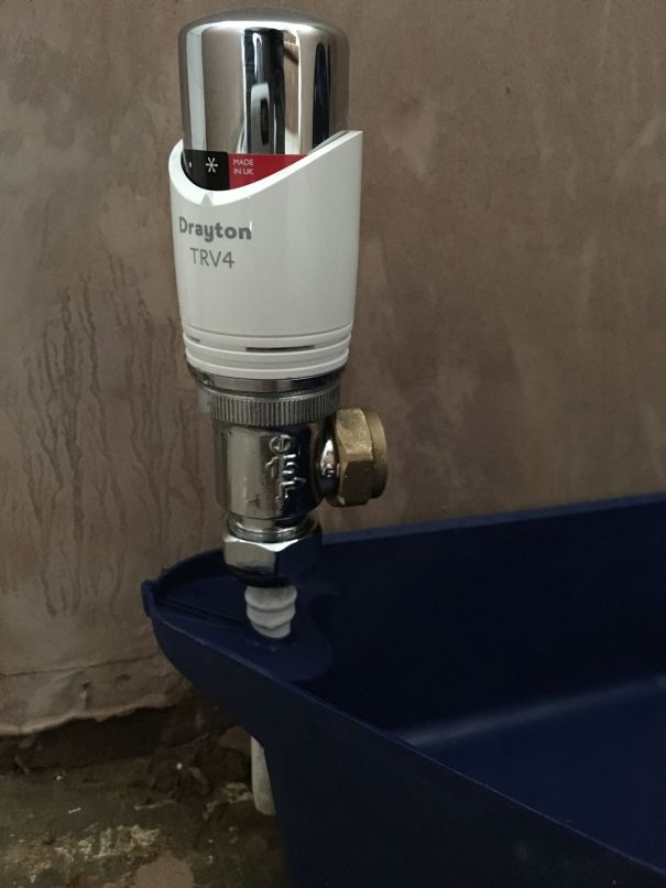

Yes that's the thing - initially he didn't fit the TRV, it had a cap there which i assume was the decorators cap & when i repressured the boiler i heard them shouting downstairs that it was leaking.
Anyway, here's the hallway one which is the one that is leaking most...
That didn't have that brass cap with a rubber bung on it. I've only just found where i'd put it so that's just been fitted 5mins ago which appears to have stopped the flow (time will tell).

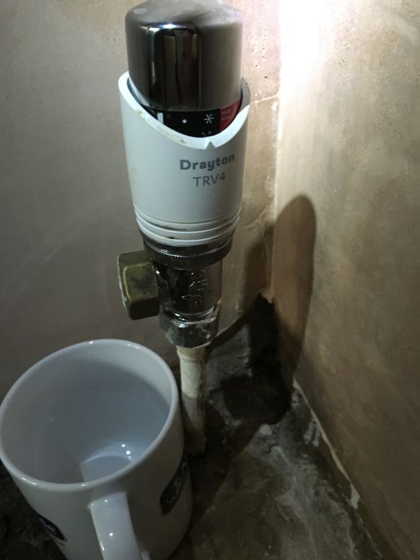

Here's the one in the living room which was leaking a tad but nowhere near as bad...
Again, this also didn't have that brass cap on it. This one doesn't have a rubber bung as i can't find the other one that did have a bung.

Dry all of those off with a towel and wipe your finger round the front and back of each compression nut (on the blanking cap and the painted stems of the pipework) just to be sure if the leak has stopped and, if not, where its actually coming from!
Pump up the system pressure and check them again!
It looks like you have 15mm yorkshire couplings "very" close to the nuts of the TRVs and I would worry that these give very little room for the valve to be properly home!
Personally, I'd cut those off, rejoin upstream (in the floor) and bring up new copper with no joins to the valves. Gets rid of all that orrible paint as well!
It looks like you have 15mm end feed couplings "very" close to the nuts of the TRVs and I would worry that these give very little room for the valve to be properly home!

It depends where they are leaking from! Do the checks with a torch and your finger... I'd say it's the lack of blanking caps as TRVs let by, as mentioned.
You say the pipework is minibore (10mm?) then what I can see on the photos is not a 15mm coupling, it must be a 10-15mm fitting to suit the 15mm entry to the TRV... If so, my mistake, but it'd still be better to move that soldered join upstream, especially if he's done it on the lockshields.
And sorry, I meant no joins in the pipework coming up to the valve... It obviously needs to be joined "at" the valve :whistle:;)

Please read what we have told you!
The TRVs are NOT faulty! They are just not designed to close off the flow if not connected to a radiator.
The 10 mm to 15 mm adapter at the entry to the rad valves are perfectly satisfactory.
Of course, because 10 mm pipe is smaller and soft, then its better practice to have the change in size under the floor to look better and to avoid denting when vacuuming but that's not important and will not affect the operation at all.
