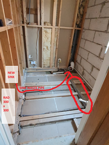

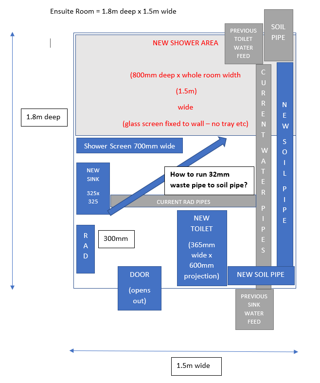

I'm now down to just to just a shell of a room, and rather than put everything back in the same place, I want to rearrange things so I can have a bigger (and walk-in) shower! I've measured everything out and used wooden batons and floor protectors to template everything and it all seems like it'll work.
My only problem now appears to be whether I can reroute the plumbing properly.
Below is a diagram of what I'm planning, and a picture of how the room currently looks.
The biggest problem I can see is: How can I run the new sink waste pipe to the existing soil stack? Ideally I don't want to run it along the left-hand and back wall as I think I'd lose room space by having to box-in the walls slightly to allow room for the 32mm sink waste pipe. But I also can't see how I can run it under the floor especially with the copper pipes running directly thru the room (circled in red)
Any ideas gratefully received, also if there's any other potential problems or advice anyone could give me I would be very grateful.
thanks in advance!
32mm pipe could be routed through those studs (if they're 3 inch and it bothers you that you'd have ~16mm of stud left either side, drill your holes 10mm nearer the room than centre and line the stud with a glued n screwed 19mm batten - you won't notice the 20mm loss of room space), but how big of a sink do you need? Have you looked at combined sink/toilet units?

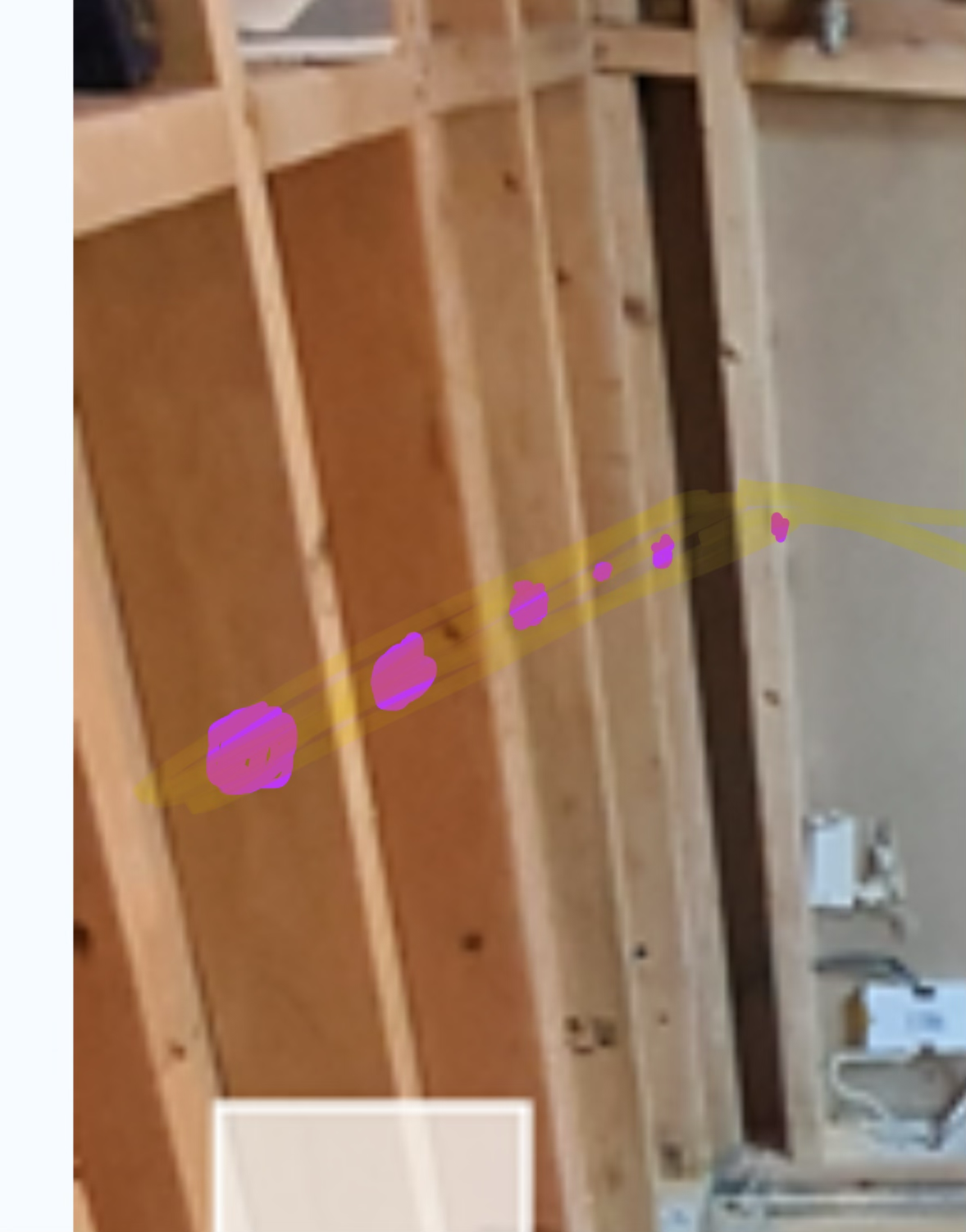

You appear to have wiring not in a safe zone; that should be addressed

The picture isn't great, it looks like you have a wire coming up behind a socket box and going diagonally across the wall
And can the new waste pipe go underneath the existing copper water pipes?
Perhaps you misunderstand; both I and Hugh proposed to run the waste pipe inside the stud wall
Drill a 34mm hole through your timbers with a slight fall, stud to stud, and route the pipework through it

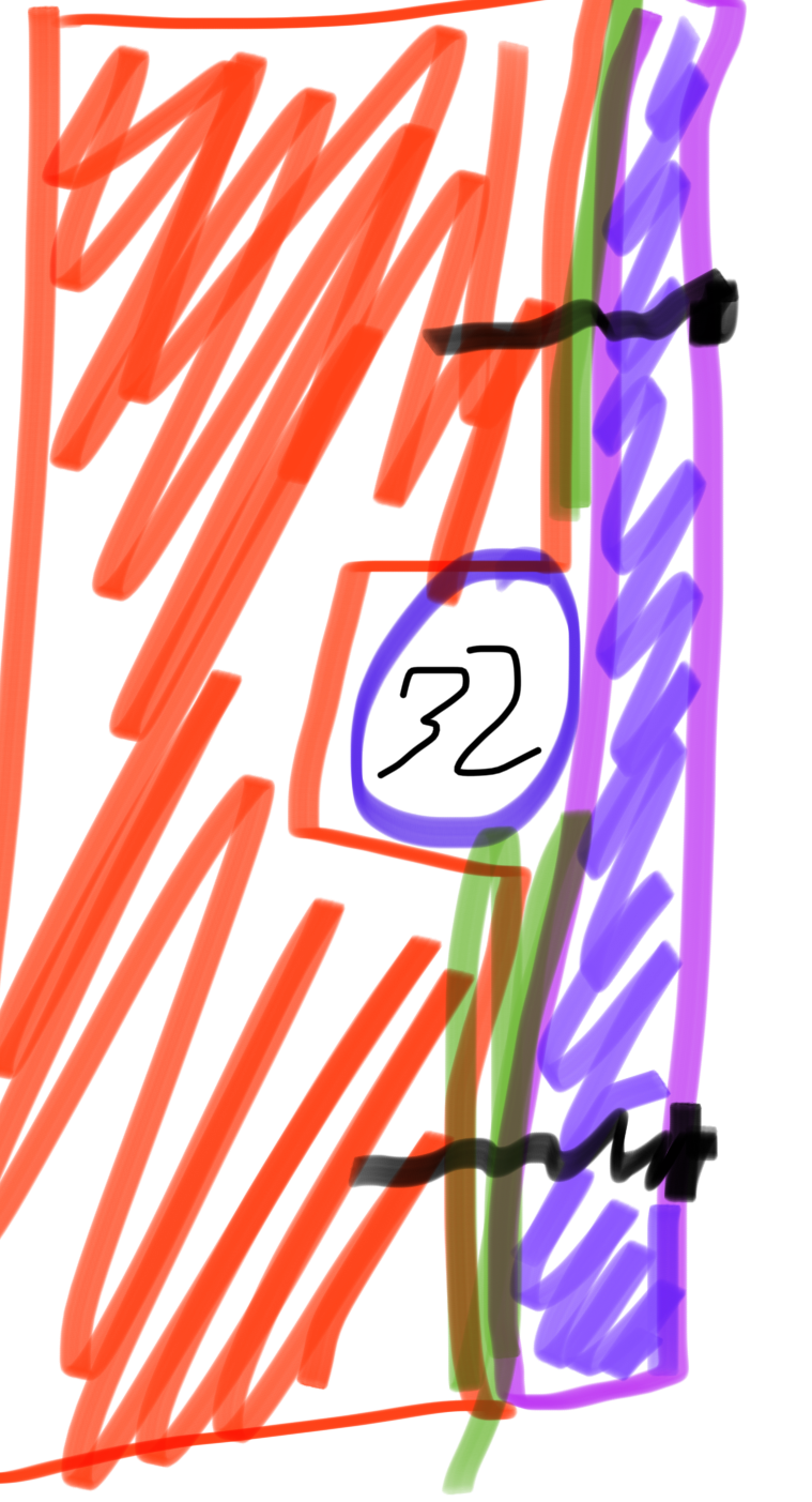

If getting the pipework into the holes that you drill through stud centres is too hard, notch the studs out 32mm, run the pipes , then run a glued n screwed batten up the stud to encase the pipe and restore structural rigidity to the wall
Red-wall stud with 32mm notch and pipe installed
Green-D4 urethane glue
Purple-new batten eg 25x50
Black-screws at eg 250mm spacing

Thanks so much for your advice! Sorry, yes I did misunderstand!
You are right, there is a wire coming up from behind the socket and running across the wall. I will sort that as you are right, it's not safe.
I'll try to follow the advice given and research more into how to run the waste pipe. thank you - as it tells me theoretically I can have the sink where I want which is good news! :-) thanks!
I would redesign to eliminate the problem , turn loo 90%, put sink next to it on right hand wall , and switch shower panel side . Gives you room to dry yourself without obstruction and puts all plumbing on one side .You might also get door opening in back to rad , if there is room.

Great idea and if I could do that I would, unfortunately there's a window on the right hand side wall - so it's not possible sadly
