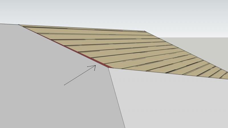

New extension roof
is it possible to make the soffits match by changing the gauge on the slates?
No - that makes no difference.
Hard to describe without diagrams, but think about the geometry.
If all the rafter feet project the same distance from the outer wall faces, then because they are at different slopes on different sides, the feet on one side will end up at a different level than the feet on the adjacent side.

The drawings are just plain wrong in several ways, and whoever did them has not got a clue how to design or how to draw - does he do refunds?
As the front extension is not projecting too much, then it is possible to keep all the roof planes in line and just have a small leaded flat roof section to the front. This is the gist, but I don't think it will be this much
If you can keep the ridge level with the main house then you might be able to just jig the front slope slightly. But Its hard to picture how it will work where the three planes meet right at the top of the front gable. From this view, it wont be too bad, and the tiles can be jigged or a bit of lead used

Woody's drawing with a flat portion on the one side seems like a good option, but I've got an alternative:
Would it be possible to have a flat portion at the top of the roof rather than the bottom. This is similar to the property I mentioned above and would give a nice symmetrical appearance :idea:
I thought about a flat top slice, but it would need the most structural works and be the most technically challenging to build correctly and detail. It would probably be a last resort.

Anyhow ive had a measure and the with of existing inside wallplat to wallplate is 5200 and the extension is 5500 so got 300 to find, do you think the best option is to have the hip asymetrical with the longer side to front and try to mess with the small area at the top which is approx 500 to 550 withpout actuall measuring it?
I'm wondering if it's possible to put a parapet instead of a small flat roof? Eyesore?
