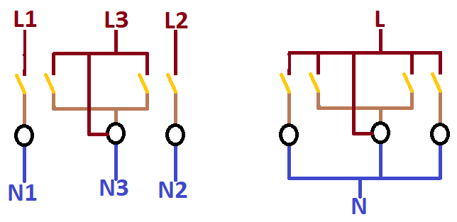

I am installing an in-line extractor fan with timer, which will serve 2 bathrooms with timer can please advise .both bathrooms are in same circuit.

One fan, suck from both rooms simultaneously, wire both lights as a common 2 way circuit.

Double pole light switch in each bathroom, 1 pole for the light, the other for the extractor.
Or a PIR / microwave detector in the ceiling of each room, both wired to the extractor.

Agreed - but if the lights are on different circuits, the switches certainly needs to be wired by someone "who understands what they are doing" and,even then, there is a potential issue.
If the lights are on different circuits, then at least one of the switches needs an L feed from the 'fan circuit' for it's 'fan pole' (both switches if the fan is on yet a third circuit :) ), as well as the L feed for its'light pole'. However, if that is done correctly, then one has Ls from two (possibly even three!) circuits present at the same face plate, which could represent a potential hazard for someone subsequently working on it.
Yes, I know, proper 'testing for dead' should address/eliminate that hazard but, given that people are human, having two or more circuits present at an accessory will increase the potential risk.
Yes
with the more likely situation on the right

Yes <diagram> with the more likely situation on the right
Agreed - that's obviously what I was describing (but couldn't be bothered to draw diagrams :))

I still remain a little uneasy about the possibility (if more than one circuit were involved) of their being Ls from two (or three) circuits at the same 'light switch'. One could avoid that problem (at the switch) by doing it with ('remote') relay(s) (and one would then only need standard SP switches) - but, even then, a similar issue would exist wherever the relays were located.

But a warning on the relay enclosure will be in a location where aesthetics are unlikely to be an issue and several supplies expected. I would add an internal warning in the switch if suitable.
One option I've heard of people using is to use "grid plus", then put the label between grid and faceplate. This hides the warning from normal users of the installation but means somone working on the installation is likely to see the warning while the wiring is still mostly enclosed.
