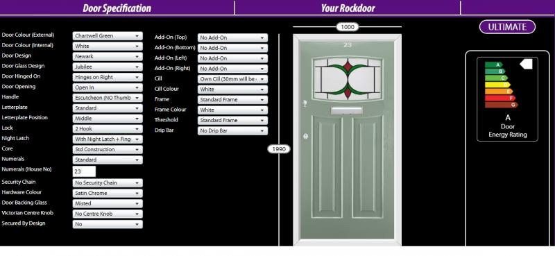

We are trying to find a door that has nightlatch and deadlock. This means no 'giveaway' mid-height lever handles that is so typical of almost all UPVC/GRP. The lever handles look daft on old style doors. see pic
Finally- the problem!- is that if we don't have a lever handle, which you lift to engage multi point locking, we cannot get the level of seal/draughtproofing (we think) One tradesman who will fit our choice of Rockdoor spec has expressed doubts that we'll get a very good seal, given only two locks at mid height- the nightlatch and deadlock.

When you lock from the inside, say for the night, do you have to pull up a lever handle to engage the locking points before turning the key? If you don't, and your door seals up firmly all the way around, then we'd like a door like yours!
My pic- the door has no lever handle to suit the style of the door. If we go for that design we loose the locking system as above, which pulls the seals together tightly. This means the door needs to be very well made and fitted. Any warp or wind in the door and it will leak air or worse. A warped composite door (afaik) is not likely but I've never owned, fitted or fixed one!
